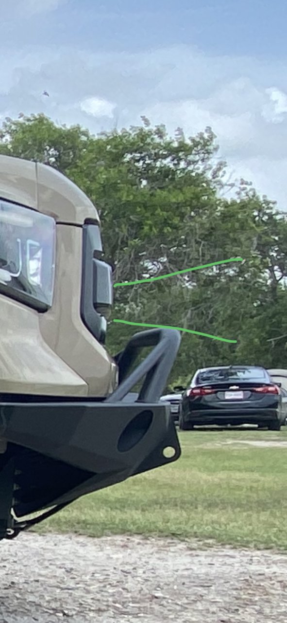

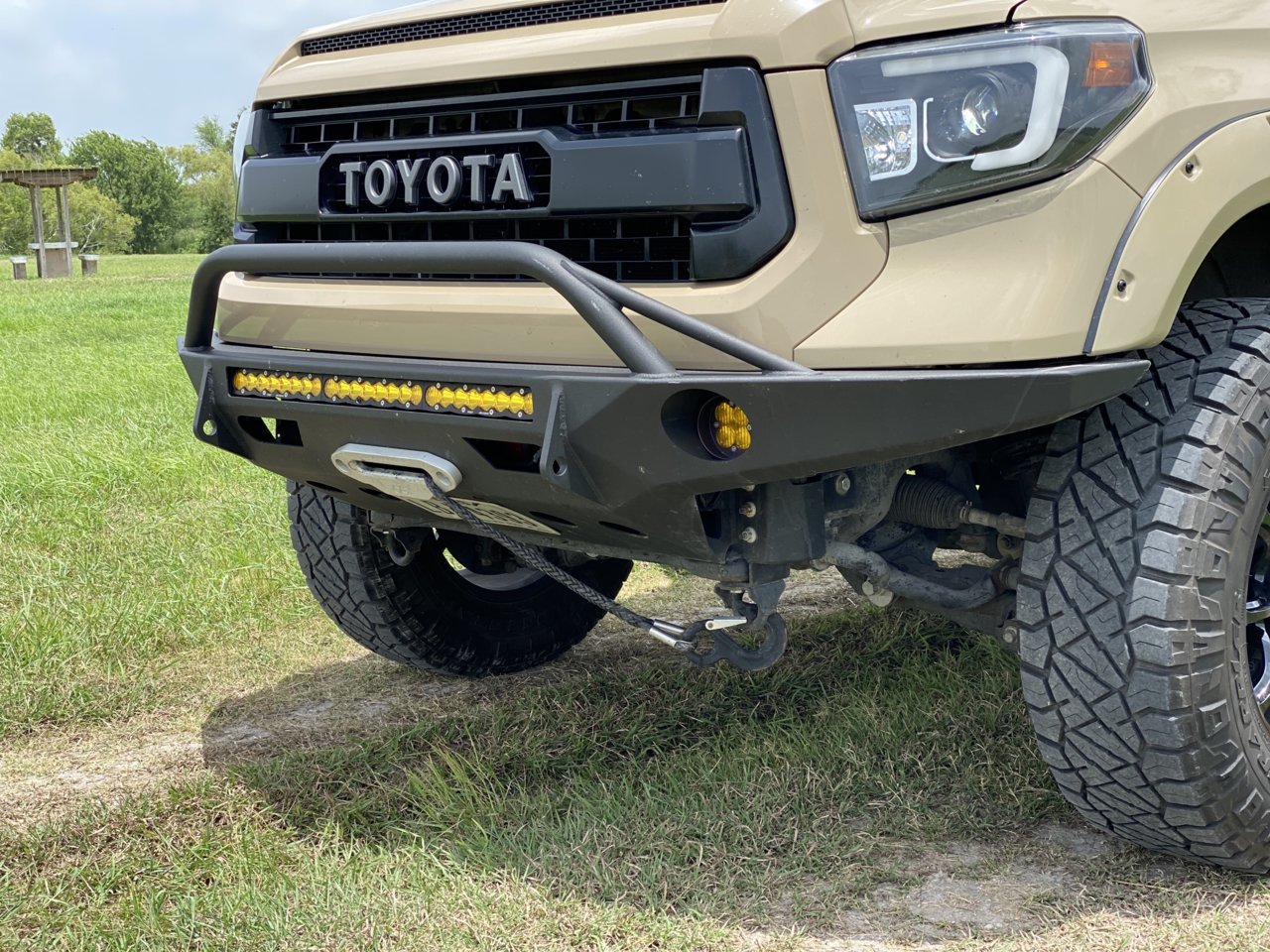

    #204
    cctxquicksand
    cctxquicksand IG - TRDistheWrd
    Jun 3, 2019
    #31410
    1,274
    Original post edited
    Found a solution to my problem
