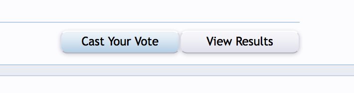

    You can view the results without voting, click on View Results
