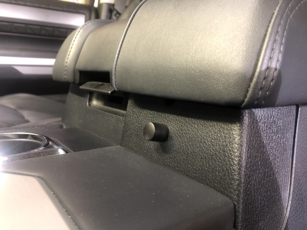

    same place I had JRT put mine and it is the perfect location to make quick tweaks!
