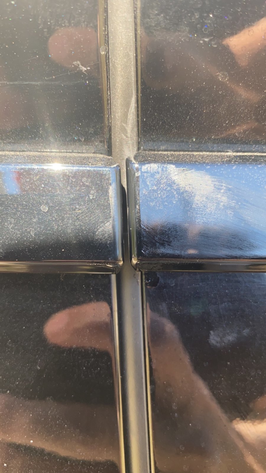

    Toyota tundra 2023 platinum I force

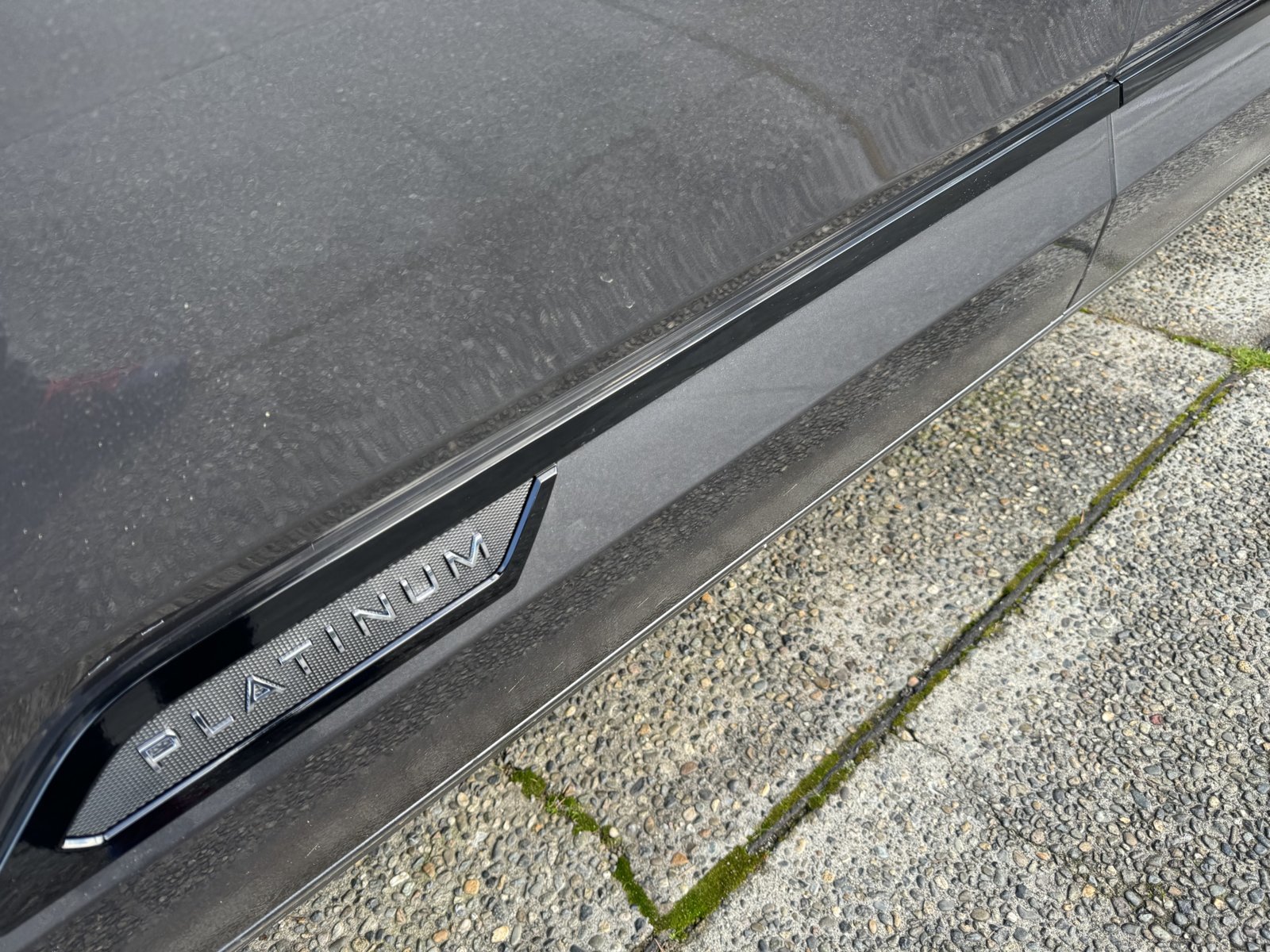

    3/3 for me too. Got it repaired twice and today it expanded. It’s only 77 degrees. Was in the sun and bend back off tape. This time hopefully they place it even further back. Only had truck 10 months.
  2. Nov 6, 2023 at 9:35 AM
    #122
    glozanoff
    glozanoff New Member
    Apr 21, 2023
    #95824
    26
    Look how much it expands when in sun. Last night it was 1/2 inch apart.

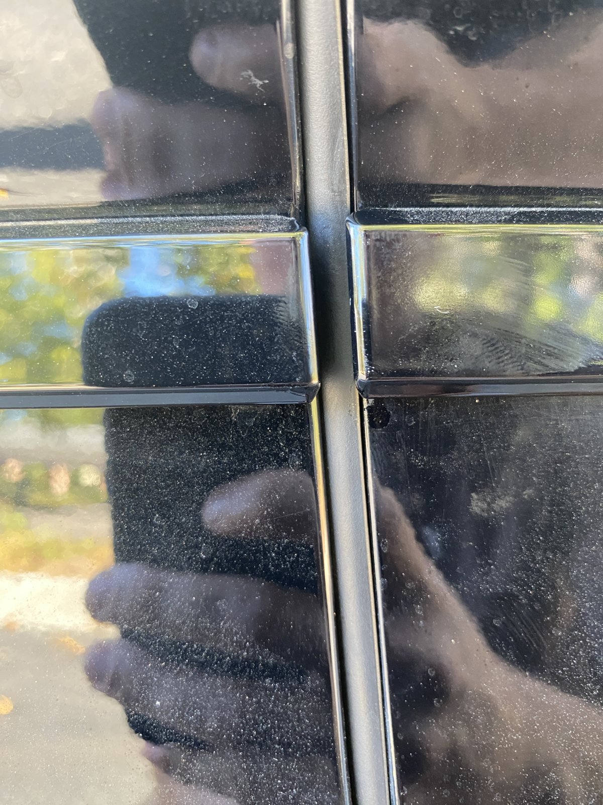

    26
    Update. Went to dealership and will be moving it back a little compared to previous outline. Maybe 1/8 an inch as the expansion in sun is about 1/8 and will hit front door when open and 77 out

    #126
    glozanoff
    Apr 21, 2023
    #95824
    26
    I had my replaced but notice it will expand about 1/16 to 1/8 an inch. If it is In line with the door it will catch on heat. Make sure it’s a little back from door frame. Mine was in line with door and that is what happened above on a direct sun 77 degree day. Dealership agreed after 3
    Times to move 1/4 inch back
    they did make some small dents in the process so now going back

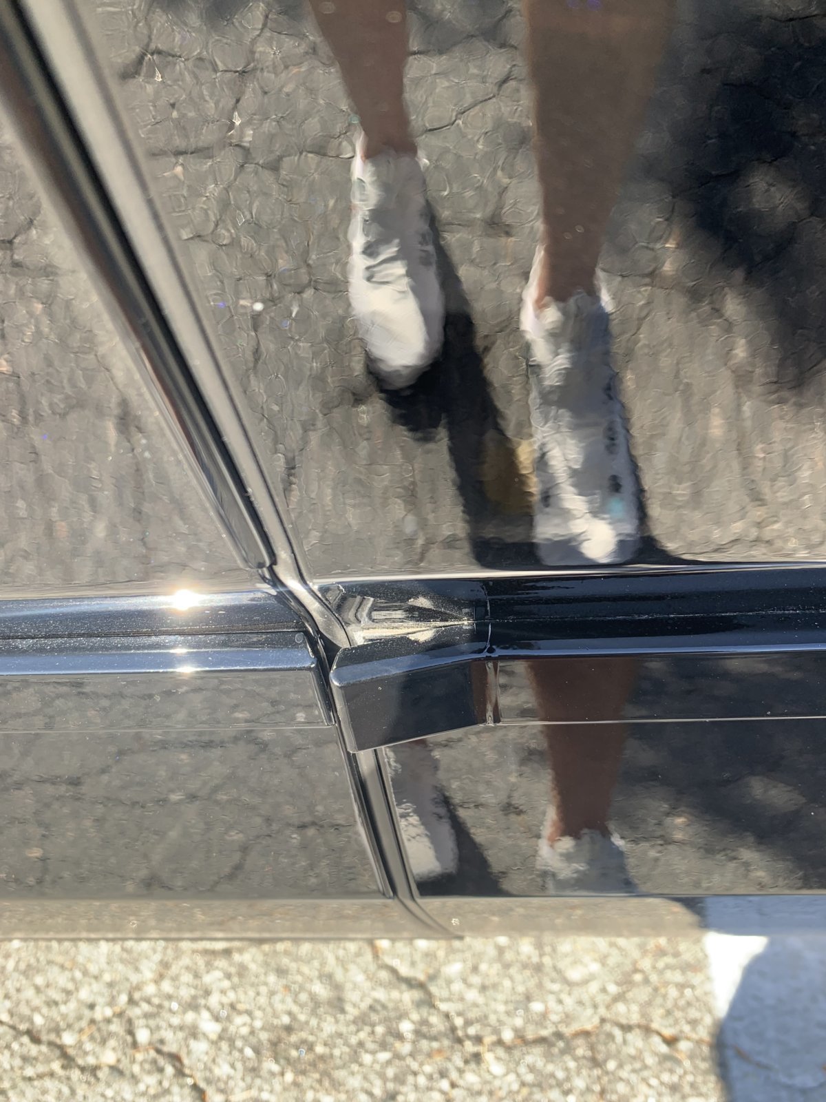

    Thomas
    2024 Tundra
    Well I have a 2024 and the problem is still happening. Drivers rear door was loose when I picked it up and it seems to seperate from the door when it gets warm out. In FL that is every day. Dealer has ordered replacements and just waiting on them to come inPXL_20231027_121812300.PORTRAIT.jpg

    #95824
    26
    They moved mine back because it would expand 1/8 inch and catch front door in heat. Now about 1/4 an inch back. Have not had any issues with coming off tape other than when it hits the door. Live in South Carolina so had several 100 degree days. Time will tell. Watch closely because when they removed mine they scraped and dented the door.

    I took my off they come off in heat from glue or expand! If you do put them on put the back one 1/4 inch back or more or they hit. I’m having dealership fix the dents from removing and keeping them off. That’s why trd pro does and it looks clean

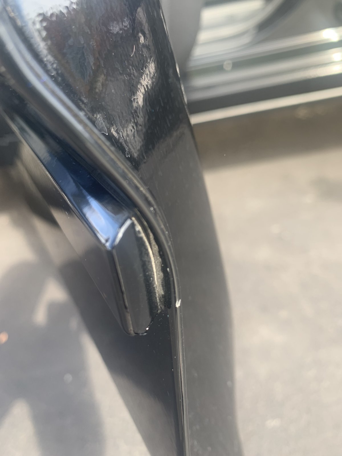

    Just left the dealer with a loaner. They successfully replaced the broken part, but in the process of removing the old one the tool they used created a bunch of little dents in the door. Now they are fixing the dents they made. In the meantime I’ll settle for an SR5 with the TRD package. Thankful my dealer was at least honest enough to point this out, I probably wouldn’t have noticed if they had me just come and pick it up.

    The dents in the door?? I've seen this posted more then once. while other posts mention that you can just pull them off with heat and light pulling. Seems odd

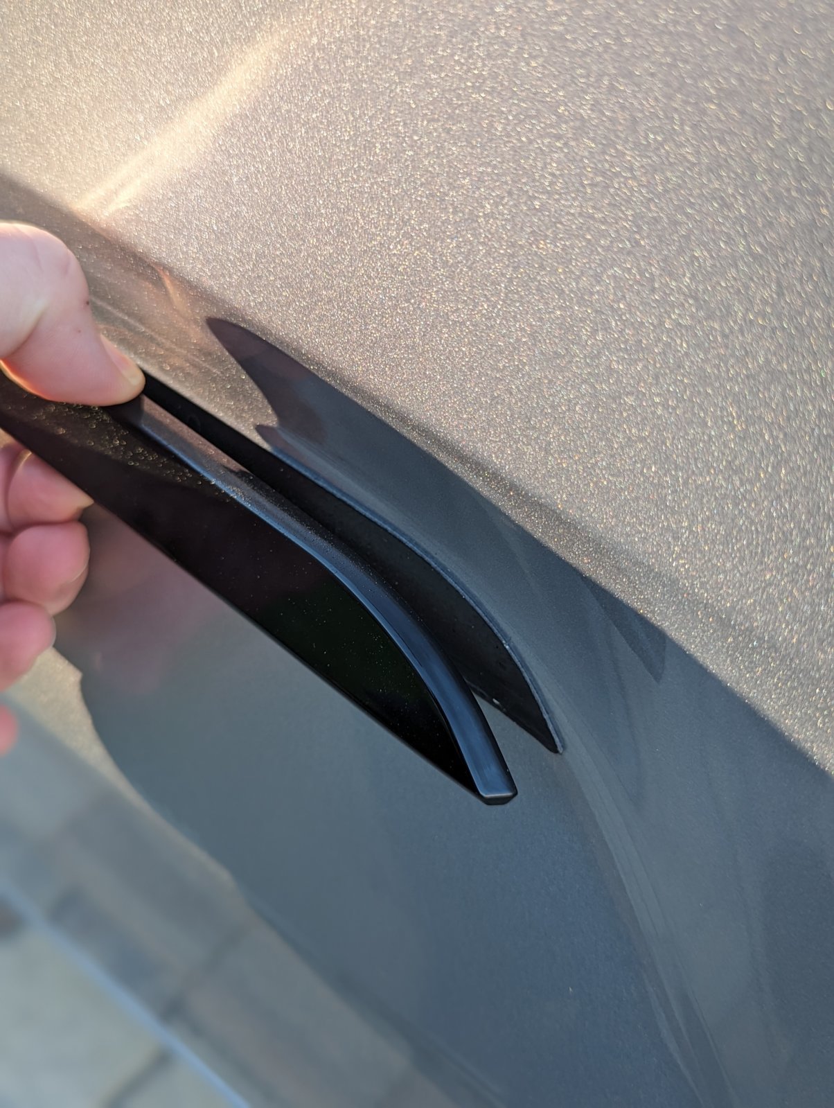

    Had my ‘22 door badge trim replaced at the dealership due to it peeling back at the edges. As other people have posted, the dealership said it was under factory warranty so there was no charge. They replaced both sides at no cost to me.

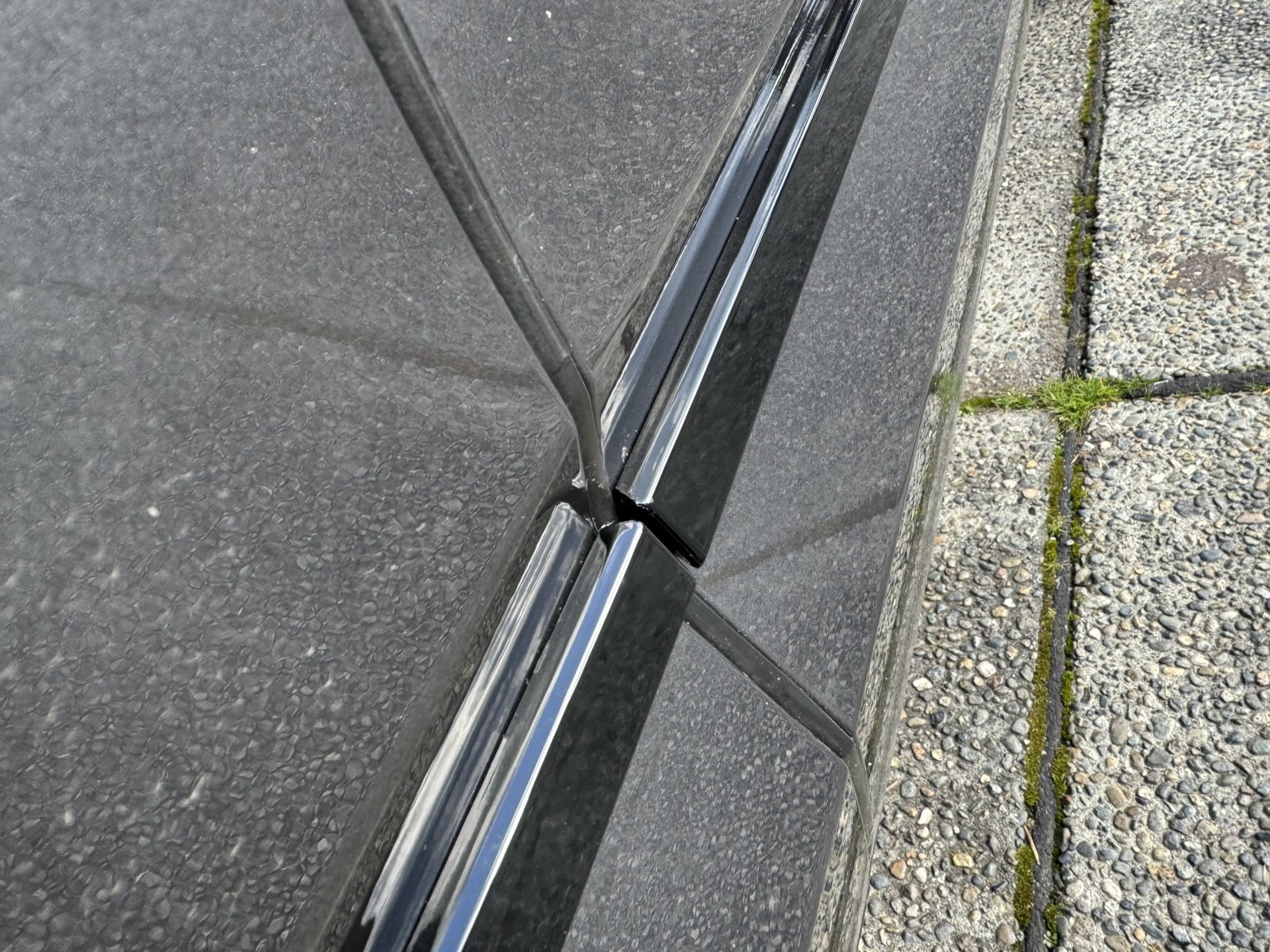

    Mitch
    2024 6.5 Pearl Platinum for towing camper
    I’ve had my Platinum for 3 months and I had the rear door driver side snap off in exactly the same way. Exactly like the pictures in the very first post in this thread. Wondering if the right answer is to just remove them all and be done with it.
