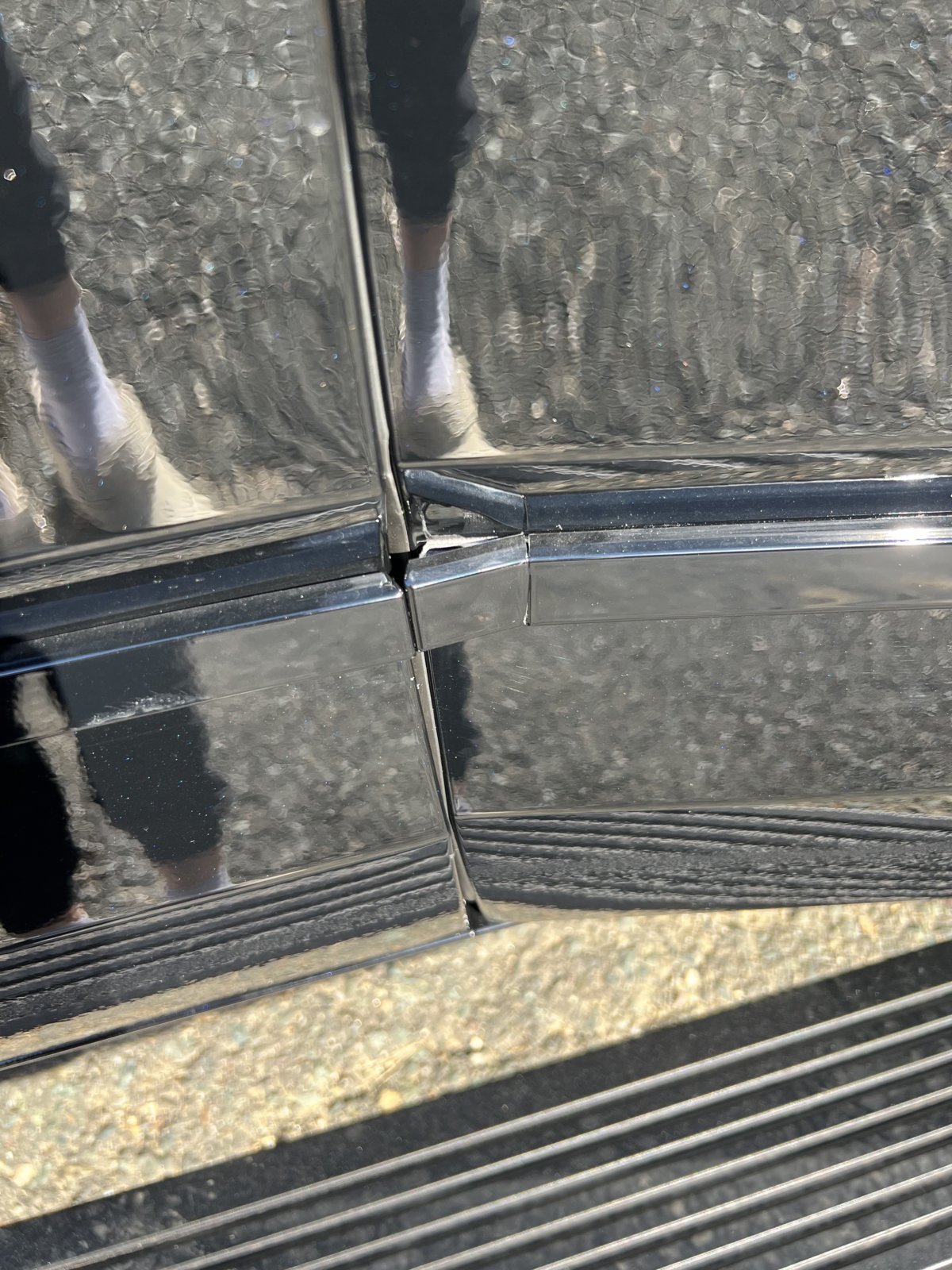

    so this badge issues is a multi part problem.
    1) the plant is putting them too close together
    2) the black badges absorb way more heat than the others and that’s why we see them bending out and breaking more often
    3) they are LONG and the ends can peel. Mine I double tapped with 3m’s primo vhb tape and the passenger side front door is lifting at the edge facing the back of the cab

    Mine just happened as well, was fine until exposed to a hot day in direct sunlight. The molding on the drivers side rear door contacted the front door and snapped when I opened the back door. I've had the truck since Dec '22 and this just happened this month.

    We’ve had our 2024 Platinum for 3 weeks….just snapped our molding yesterday. Just like others, it was a hot sunny day, drivers side of the truck had been in the sun. Back door was opened and we heard a “pop”. Sure enough….
    Called the dealer who directed us to the collision center for repair. They said their manager wants to see it in person to “see what’s going on”. Apparently they’re having a hard time visualizing the issue after I already sent pictures. They asked if I had been through a car wash recently, I explained to them that the truck sat in the sun all day and they then proceeded to ask me where I am that it’s sunny, as if that has anything to do with it.

    Yep, that’s the crack. I just brought mine in to get fixed during its 5,000 mile checkup but the part is on back order for a month :(
