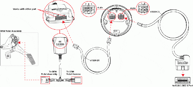

    Hmmmm I'm wondering if there is a bad batch of cables out there ?
    BettyWhite20 likes this.
  4. Dec 12, 2023 at 5:58 PM
    #94
    BettyWhite20
    BettyWhite20 New Member
    Dec 2, 2021
    #71363
    55
    2020 DC SR5 4X4
    I'm curious if it has anything to do with having it power the Pedal Monster first? If I keep pressure on the 4 pin plug, the gauge will power on and stay on; as soon as I let off it goes out.
  5. Dec 12, 2023 at 6:02 PM
    #95
    Ginsterkev
    Ginsterkev [OP] Lessons not learned in blood are soon forgotten
    Aug 22, 2022
    #82261
    262
    Kevin
    Pennsylvania
    2019 tundra Trd pro supercharged
    Tvs1900 magnuson blower Team rxp catch can Wescott designs collar lift on fox factory suspension Front and rear TRD sway bars
    That's exactly what it did to me to! The only way I figured it out was swapping in a new gauge with same cable and had the same reaction the just changed the cable and that fixed it

    Also I new there stuff can be daisy chained together simply by plug and play I just think the main culprit here is the obd2 cable

    New OBD2 cable came in and so far so good.... but damn it man, I thought this would show transmission temps! That's the main reason I bought it. ‍♂️
    Ginsterkev[OP] likes this.
  9. Dec 14, 2023 at 3:02 PM
    #99
    Ginsterkev
    Aug 22, 2022
    #82261
    262
    Kevin
    Pennsylvania
    That was quick to get a replacement cable but glad that is working out ! As far as trans temps I was disappointed as well but my head unit gives me those temps. I feel like the banks is gauge is the only one that doesn't give it, kinda wierd
