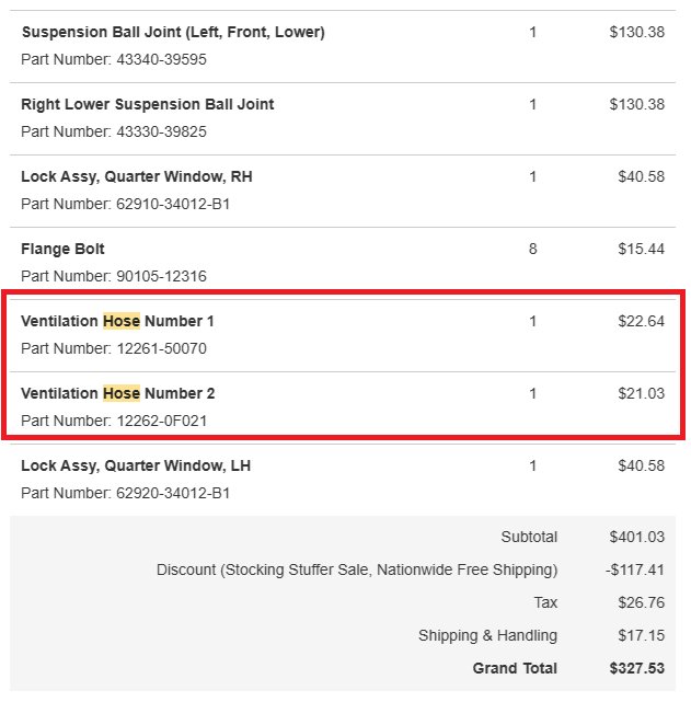

    I got quite a shock when that tiny hose piece was over $50!

    Ventilation hose #2 is NLA for early FGT. I had to improvise to make the later hose fit over the smaller nipple.

    Fifty-what? This is before the applied 15-25% off seasonal discount (I forget what it was last year), so not even $45 for all of them. It's for '06 also, so price and part number should be identical for your year. #2 is passenger side, #1 is driver side.
    Purchased from Lagrange Toyota online, but Serra Toyota of Birmingham's prices were within $10 of this.

    I think I was thinking $50 because I bought two at the local dealer. One for my truck and one for the 4Runner which both have the v8 but the hoses were very different
