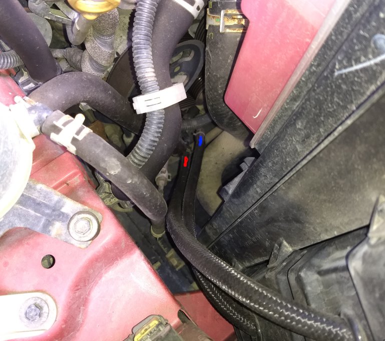

  26. Dec 24, 2024 at 5:47 PM

  27. Dec 24, 2024 at 6:19 PM
    #117
    Jmunk
    Jmunk New Member
    Dec 18, 2023
    #108654
    138
    2020 Tundra SR5 Crewmax
    Going from where the hard lines end to the cooler I was around 6ft for inlet/outlet combined. I’d grab an extra foot or so.
    BrandonL812 likes this.

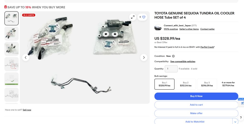

  29. Feb 8, 2025 at 6:05 PM
    #119
    ShawnTRD
    ShawnTRD New Member
    Jul 6, 2023
    #99837
    119
    Shawn

  30. Feb 9, 2025 at 1:46 PM
    #120
    Jmunk
    Jmunk New Member
    Dec 18, 2023
    #108654
    138
    With it coming from Japan I think you should be fine. The white fabric on the intent/outlet hoses is unique and I think would be an odd item to counterfeit.
