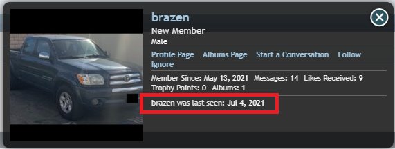

    Dude hasn't logged in since 3 years ago.
