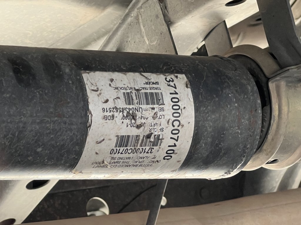

    Just checked the transmission mount and support member, all looks good. HOWEVER, my center bearing boot or rubber portion has popped out and looks a bit torn. Also, significant (like 0.5” of play) all around. This is going to be my next top priority.
    Is it drivable in this condition? I know it’s not good, but how not good is it? Appreciate it!

    ¼"-½" of play in carrier is normal. Mine has about 3/8" play in either direction and my truck has less than 80k miles on it.
    That said, torn/mangled donut-shaped boot on carrier is not normal. You should replace. Go Spicer. Mark driveshaft positions before removal so you can clock the driveshafts properly on reassembly. Make sure you don't install the bearing backwards.

    Center Support Bearing and 3 U-Joints are on the way from Summit. I got the Spicer bearing and Moog 354 (greasable) u-joints. Should get here around the end of the month, so I'll spend the day getting that bearing and joints out when they show up. Hopefully this fixes the issue. I did haul some brick and concrete yesterday and she had some vibrations so I'm going to have an alignment shop check my work as well, because if @shifty` is correct, the bearing and u-joints may not be the issue since it sounds like some play is normal.

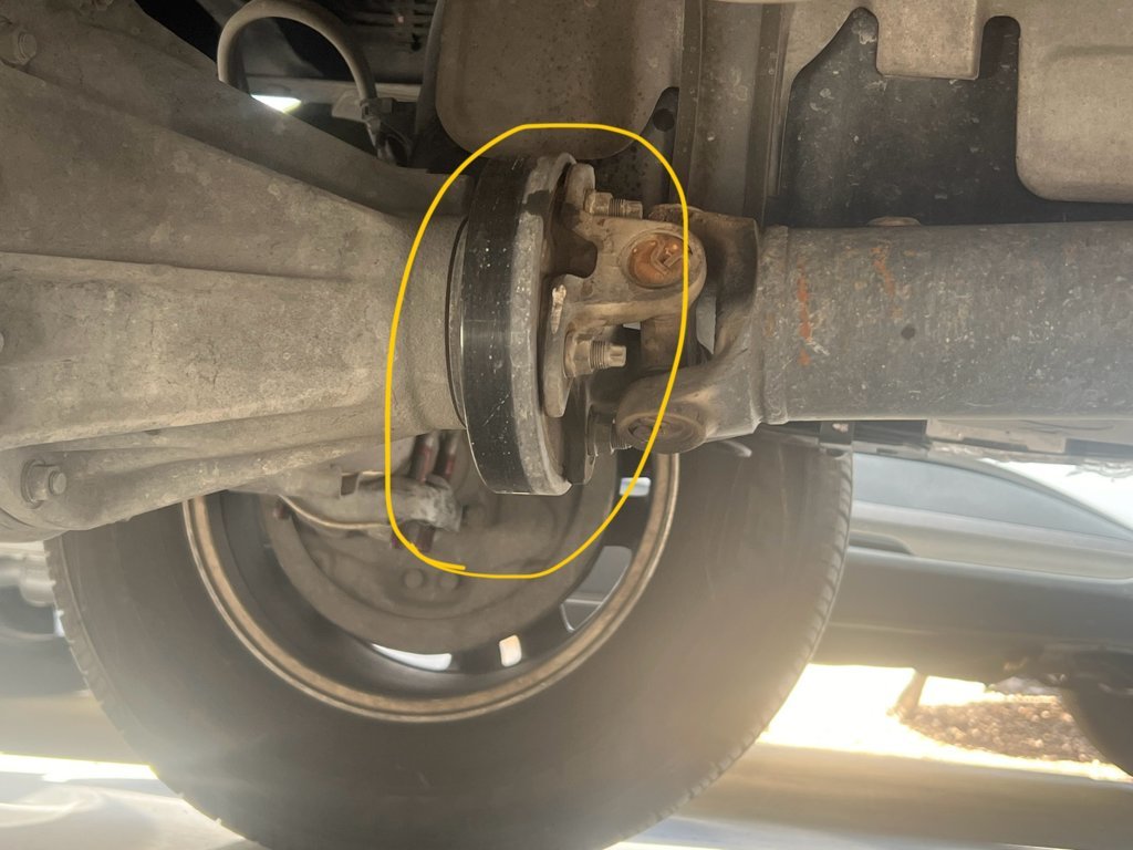

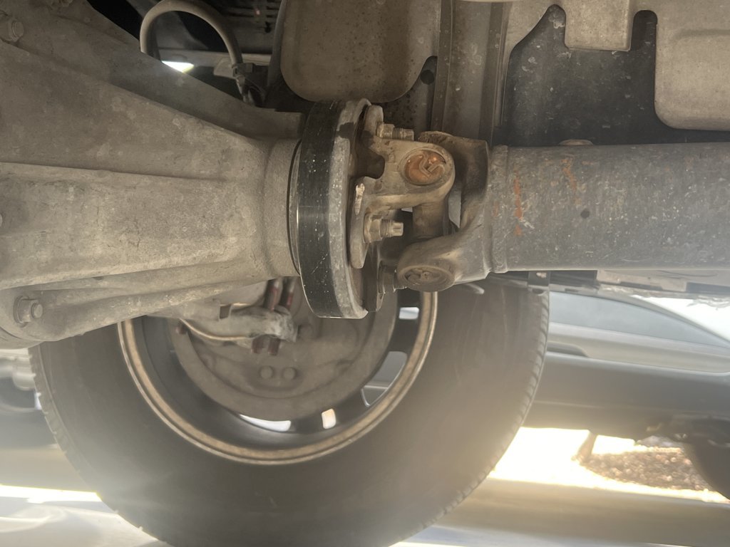

    Driveline from back to front:

    Yeah, I can already tell you, with the way that rear shaft is sitting in relation to the carrier, sagging almost an inch, it looks like the bearing is shot. Even if we ignore the fact huge chunks of that donut are missing.
    And funny, I guess I should've realized this by now, but I guess 2WD doesn't have a slip yoke out back. And with how much rust there is I'm seeing at the end of that one cap at the pinion compared to others, I wouldn't doubt if you find it's dry as shit inside.
    You're on point, I'm near positive the parts you bought will solve your issue.

    I’m seeing a donut/spacer type at the back of the driveshaft. Wouldn’t this change the angle of the driveline? Or is that the flex disc? I’m going to check fluids before I take it out again.
    I’m willing to do a complete overhaul, because I have the time and money. Should I replace the seal while I’m in there? I’m going to be checking fluids, but no sign of anything bad.

    It's just a harmonic vibration damper around the flange.
    The driveshaft to flange/pinion spline is all directly connected.
    shifty` and FrenchToasty like this.
