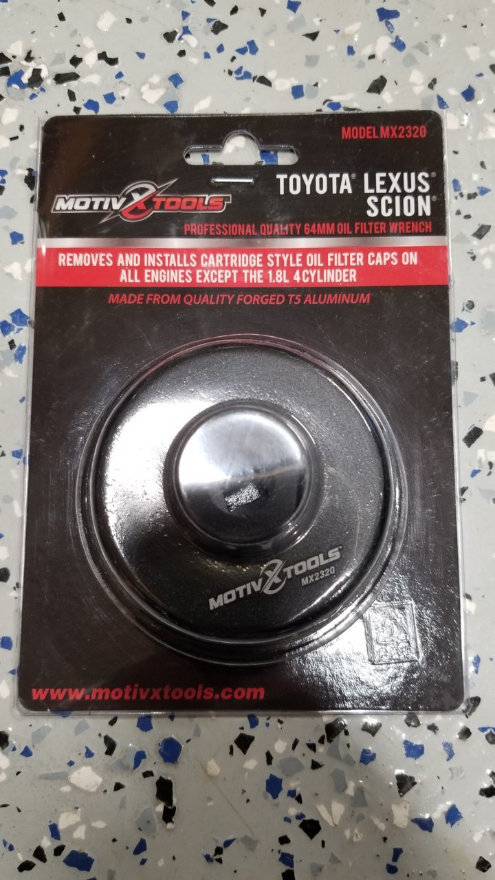

    For the ones breaking teeth off that housing post up a picture of the tool your using. I think that would be impossible with the MOTIV X tool I use.

  7. Apr 15, 2018 at 6:35 PM

    This is the one I bought. No problems at all.

    I have the same. When torqued to 18 ft lbs it shouldn’t be an issue. The issue comes from being put on way to tight.

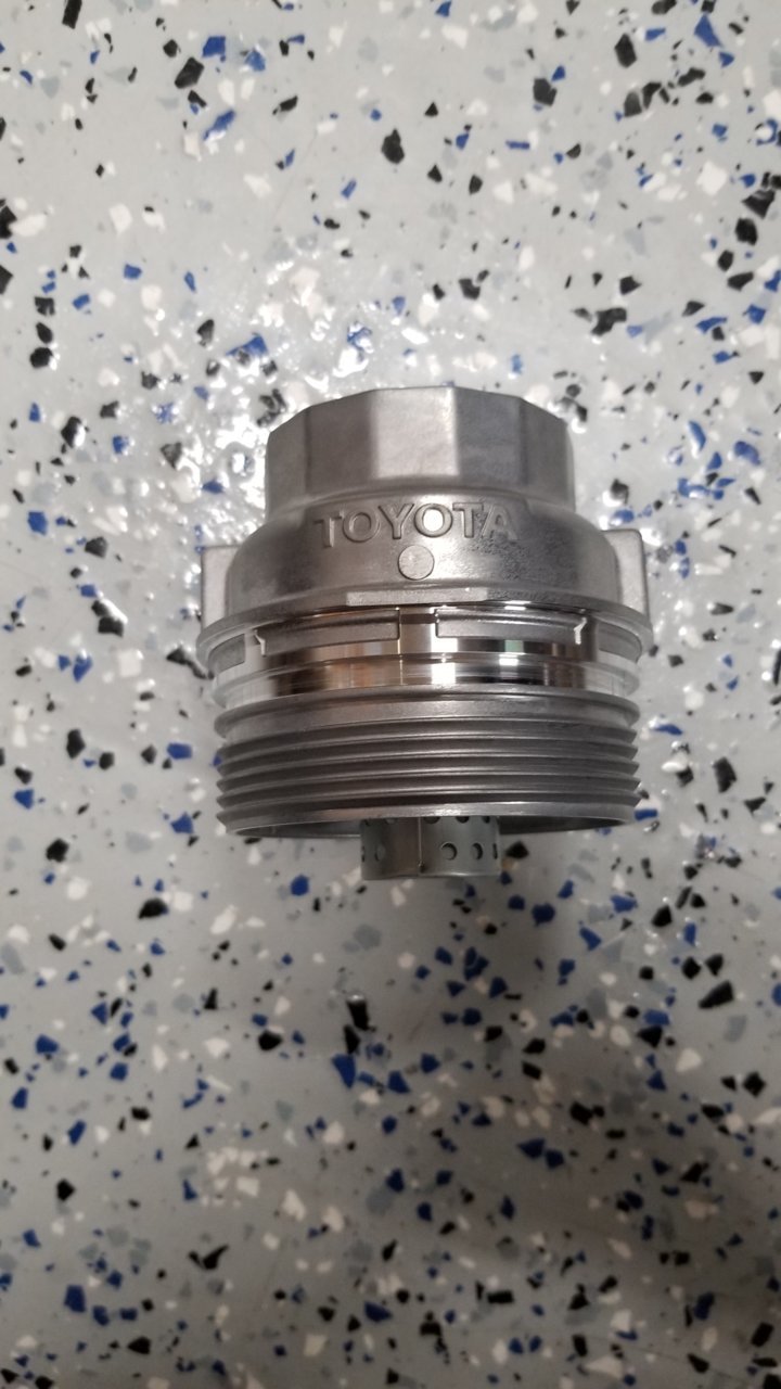

    Here's the aluminum cap @15whtrd was referring to and a photo of the tabs on both sides of the tube. You have to keep the tube from your existing cap when you replace it. Did you swap over the tubes @BTBAKER maybe that's why it didn't seat properly?
    Edit : Nevermind, the tube that comes with the aluminum cap is shorter, not longer.
    BTBAKER and 15whtrd like this.

    That very well could be. I did NOT swap it over. That’s why I love this site.
    I have one in my garage. My plan is to rotate them so I can thoroughly clean them in between. I wonder if they sell just the middle part so I don’t have to swap it every time?

    2014 TRD wheels and TRd pro center caps. Stock 2014 running boards. Stereo gps dvd deck two 12" subs w/amp. Dvd Headrests. Rear air bags with compressor and air tank.
    When I did mine I lightly pushed it to a tilt and with a little more pressure in snapped out without any damage at all and reinstalled it the same way.

    Here's the one I bought.
    Genuine Toyota 15620-31060 Oil Filter Cap Assembly https://www.amazon.com/dp/B008BHP68A?ref=yo_pop_ma_swf
    Along with this
    PBT PBT71114 Oil Filter Drain Hose https://www.amazon.com/dp/B005R3SSUY?ref=yo_pop_ma_swf
    I also got the fumoto valve and lock, and the filter wrench I listed above.

    I also would like to know the correct aluminum housing. Wanting to start doing my oil changes. No more free toyota care for me and dealer charged me $120 for oil change... i have always done my own but this new style will take some learning to get used to...just feels good and can save time and money.

    And the post before your has link to metal cartridge, but read a few posts before about the metal tube with all holes from your plastic one needs to go on new metal cartridge something like that

    Yea i was wondering the same thing...Why is the aluminum not supplied with the proper tube? Either way i just want to make sure i know what im doing. I have never worked with this newer style cartridge filters.

    Changed (tried) the oil in my wife's Camry after having the dealer do it previously only to find out the oil filter canister was so freaking tight I couldn't budge it. After trying and trying, the little tabs broke off cracking the canister and I was fucked. Figured I would tow it back to the dealer that did the change figuring they may be decent people and help me out. Wrong. That oil change cost me about $300 with the tow. Oh, and of course they didn't have an aluminum one in stock so I had to buy another plastic one there only to replace it with the aluminum one on the next change.
    Point is, buy the aluminum one before you get fucked by the plastic one. My Tundra has had the aluminum one in since the first change, its been great!
