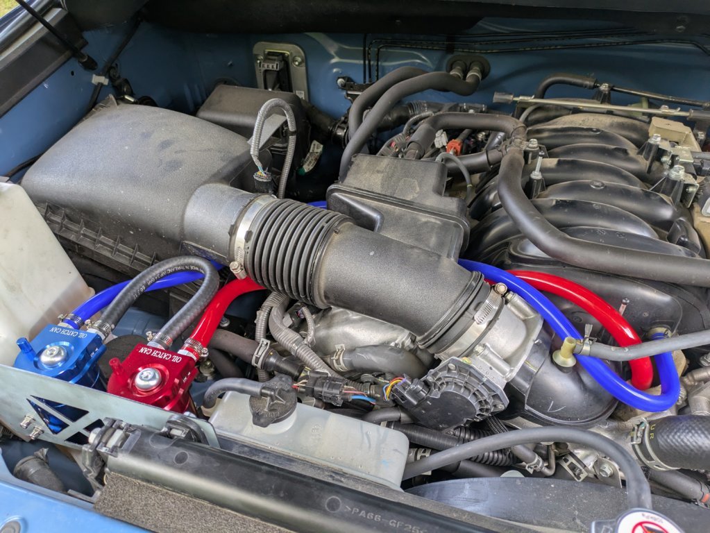

    I installed one couple weeks ago. This is what I found after 1000 miles.
    I don’t think is necessary to have one, it’s 1 more thing to maintain and I love to do maintenance on my truck.
