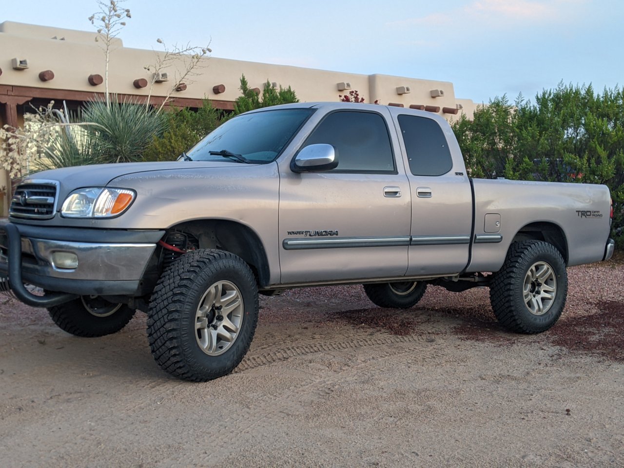

    I was running 265/75r16 Dick Cepek Trail Country EXPs on some Helo wheels for the past couple years. They seemed to be getting louder and running really rough at higher speeds, so before anything catastrophic happened I began the process of choosing a new tire. The wheels came with the truck when I bought it, and I'm a bit old school in that I much prefer something other than black wheels, so I also began hunting for a change in that department as well.
    Old Setup
    After some looking around I came across Aturro Tires, and I really like the looks of their Trail Blade XT. To make a long story short, I bought some Sequoia wheels that needed some TLC for $100, painted them (Rust-Oleum Stainless Steel), and wrapped them up with some 287/70/17 Atturo Trail Blade XTs. They were a little too close to the UCA, so I put a 1" hub-centric spacer on there for peace of mind.
    Priming the wheels
    Letting the clear coat cure in the garage
    Waiting for lug nuts and spacers
    Finally got'em on the truck
    The Atturos are like riding on glass! They are so smooth I can't even begin to explain how happy I am that I made the change, and they are next to silent as well.

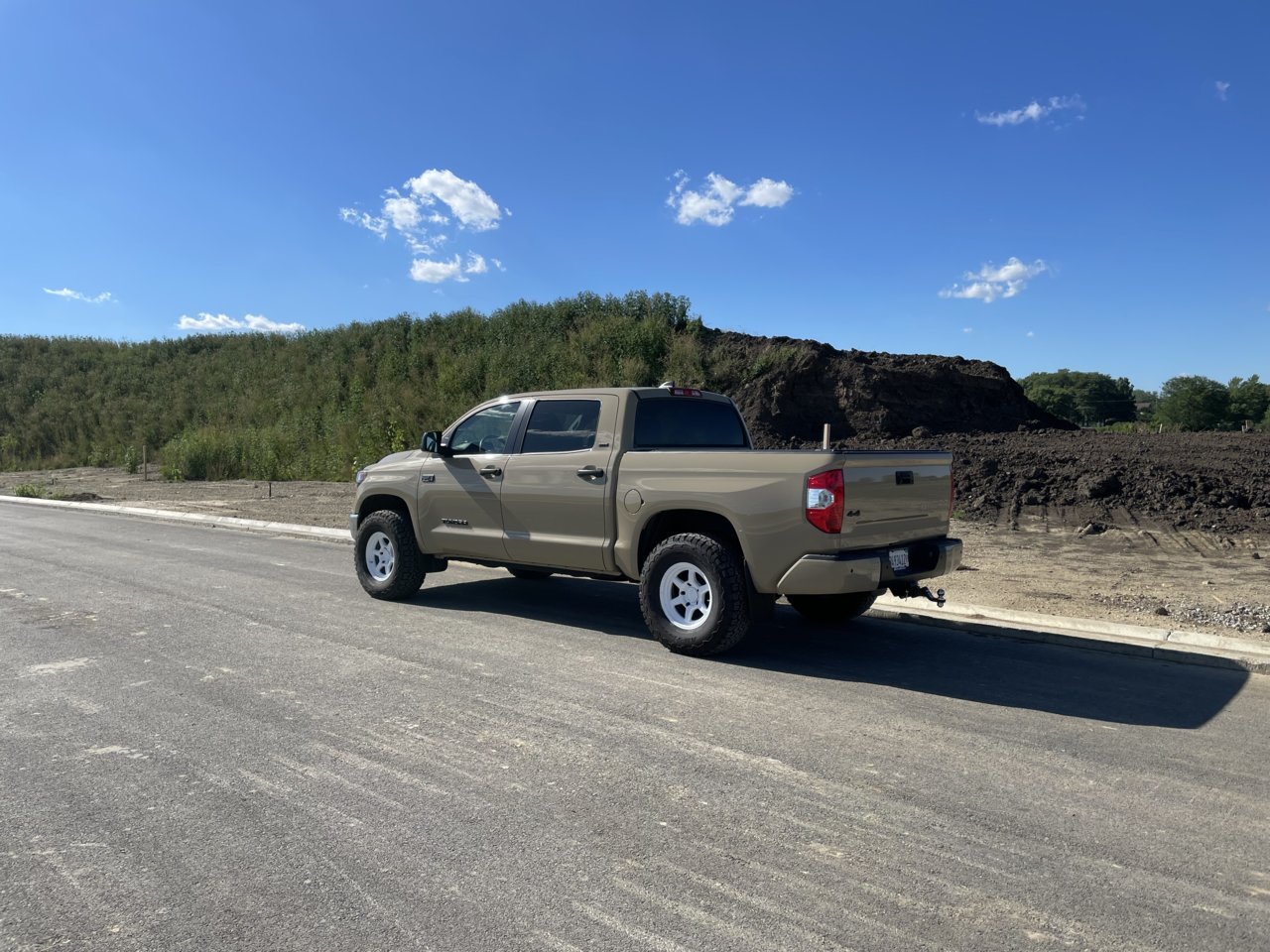

    Tan-dra
    Tan-dra MUD GANG 2006
    Dec 22, 2022
    #88976
    52
    2020 Quicksand SR5
    Bilstein 5100, 35’s on 17” wheels
    White wheels?!?
    upload_2023-8-30_21-42-56.jpgupload_2023-8-30_21-44-45.jpgupload_2023-8-30_21-42-38.jpg

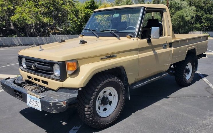

    I like it. Nostalgic to me. I grew up in the 80s in South Africa and all the Land Cruisers and Hilux came with these white steelies as upgrade options.

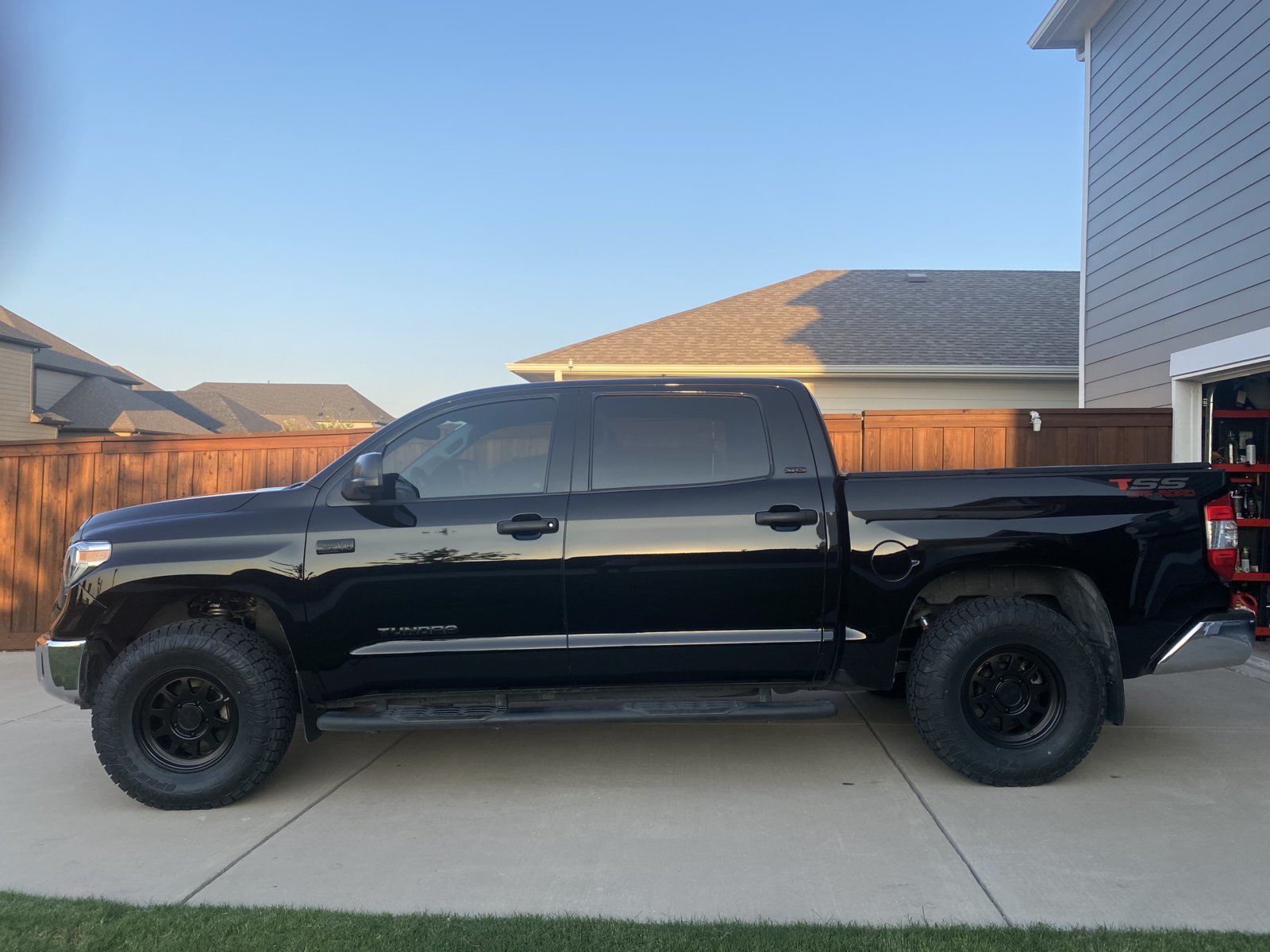

    I installed a 3/1.5 on my 2017 CM. Eibach Stage 1 2.5 + .5 Toytech spacers in front, 1.5 Toytech shackles in rear. Truck came with 275/60R20 Ridge Grapplers on 20x9 Gear wheels with 35mm offset. Looking to go up in tire size. Considering 285/65R20s or 295/65R20s. Pics? Input?

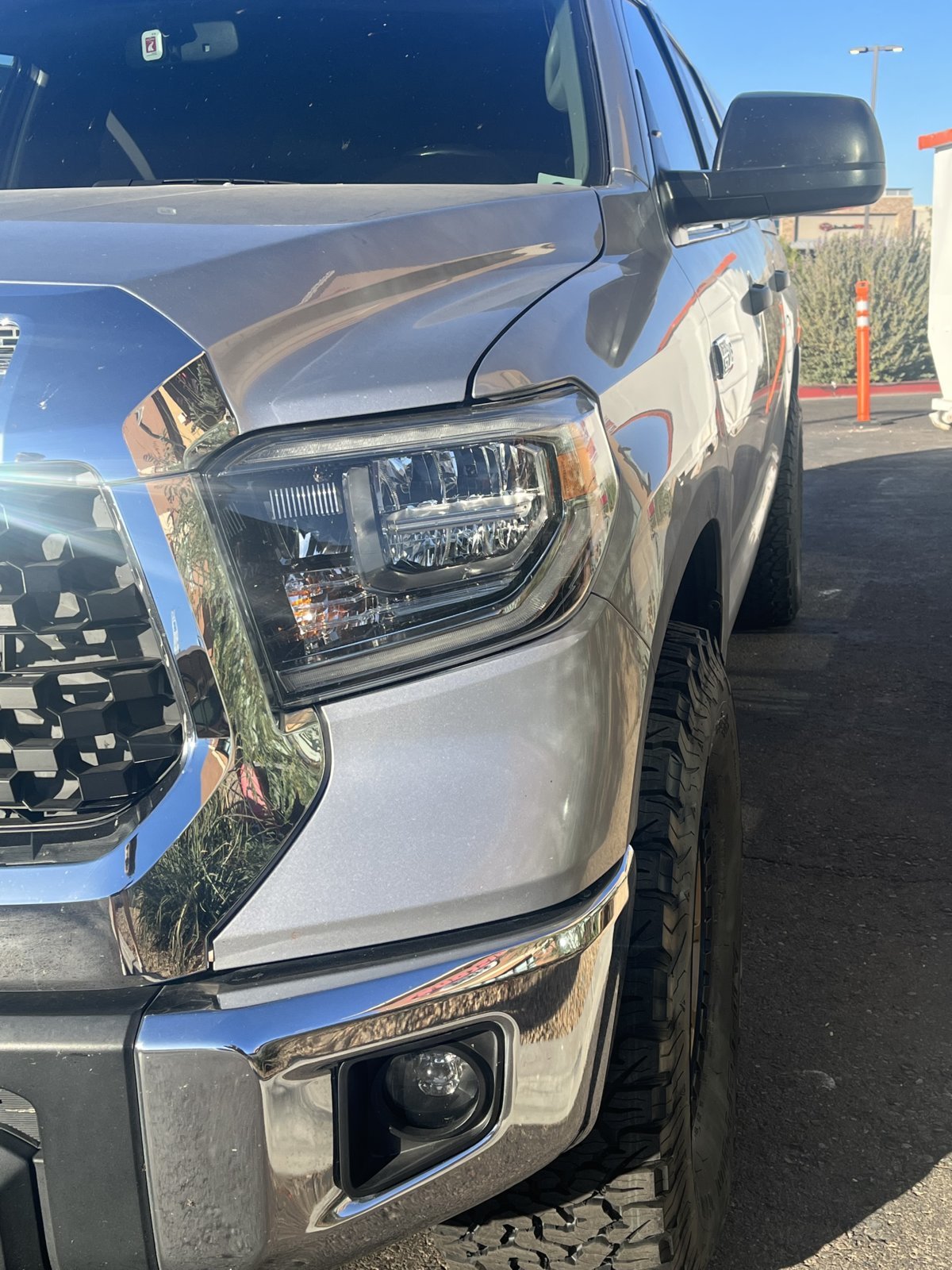

    SCS SR8 +25 offset wheels, Falken Wildpeak AT3W 285/75R18, 3/1 level. Removed front wheel well front mud flap, some rubbing at full turn on the front rear mud flap.
    Edit: I got tired of the rubbing so I trimmed some of the front and back of the wheel well plastic with some lexan scissors.

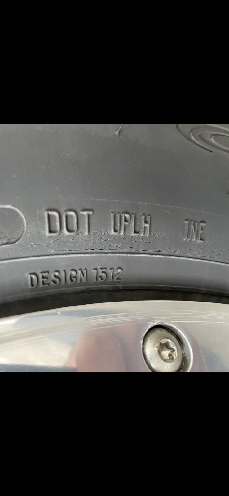

    Anyone know what date code these copper discoverer these are?

    Look for the DOT on the inside of the tire. Whoever mounted those put the date code inward.

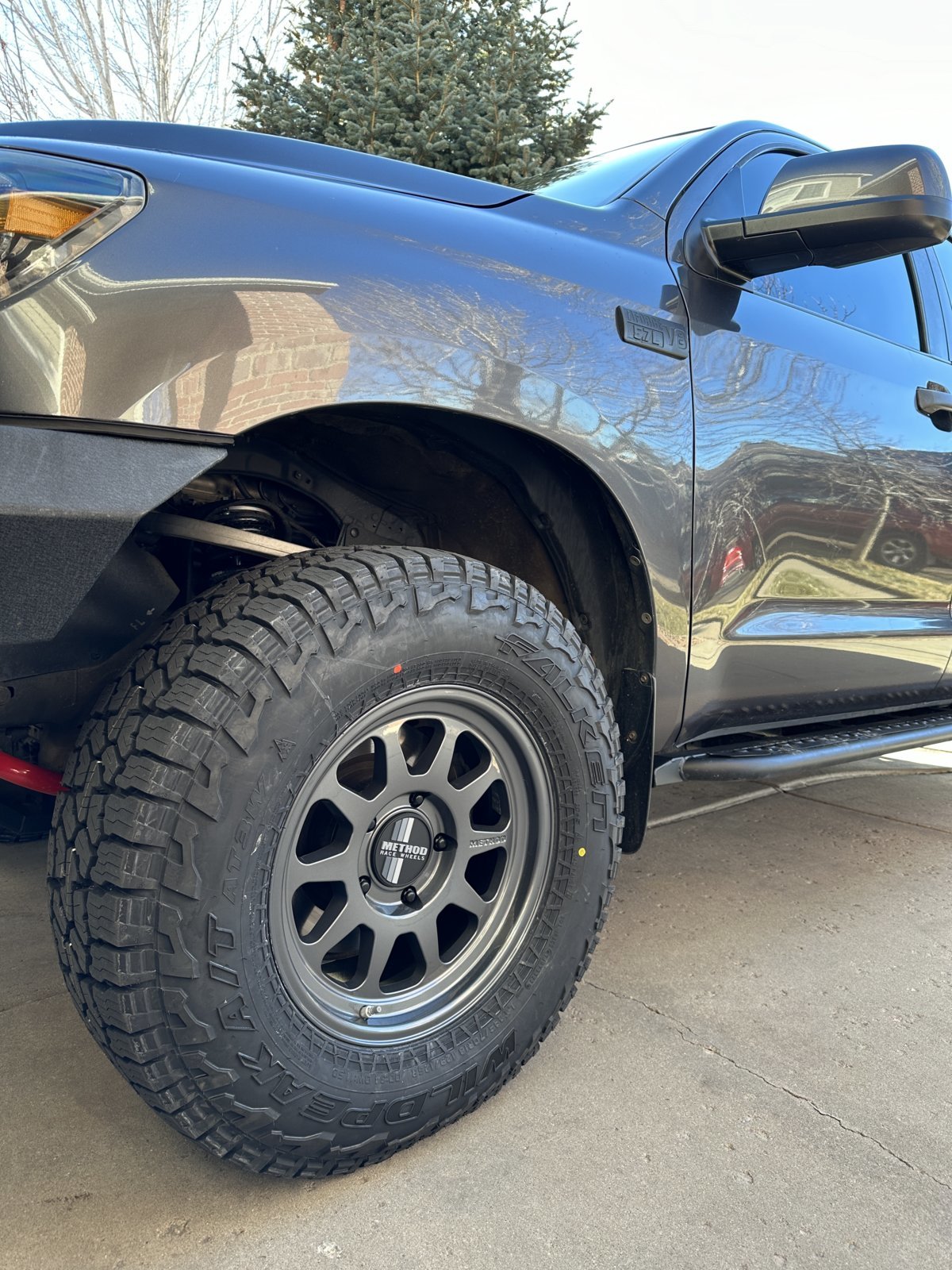

    IMG_3370.jpg IMG_3369.jpg IMG_3363.jpg [] Wildpeak AT3W
    295/70R18
    Method 316 gunmetal 18mm offset
    Fresh coil overs (about3”) and add a leaf in the back
    Ironman UCAs
    minimal rub on the stock rear mud flap
