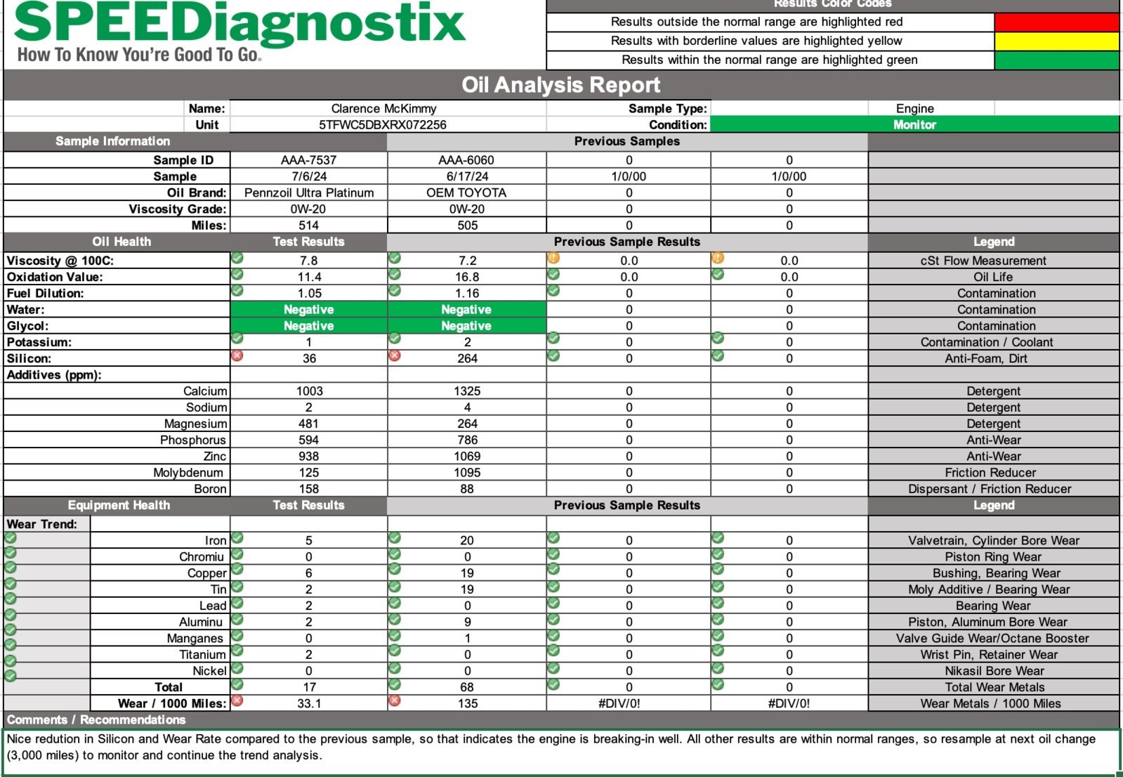

    Image 7-12-24 at 8.04 PM.jpg 2nd oil analysis from Speed Diagnostics, once they received it, within 4 days I had my results.

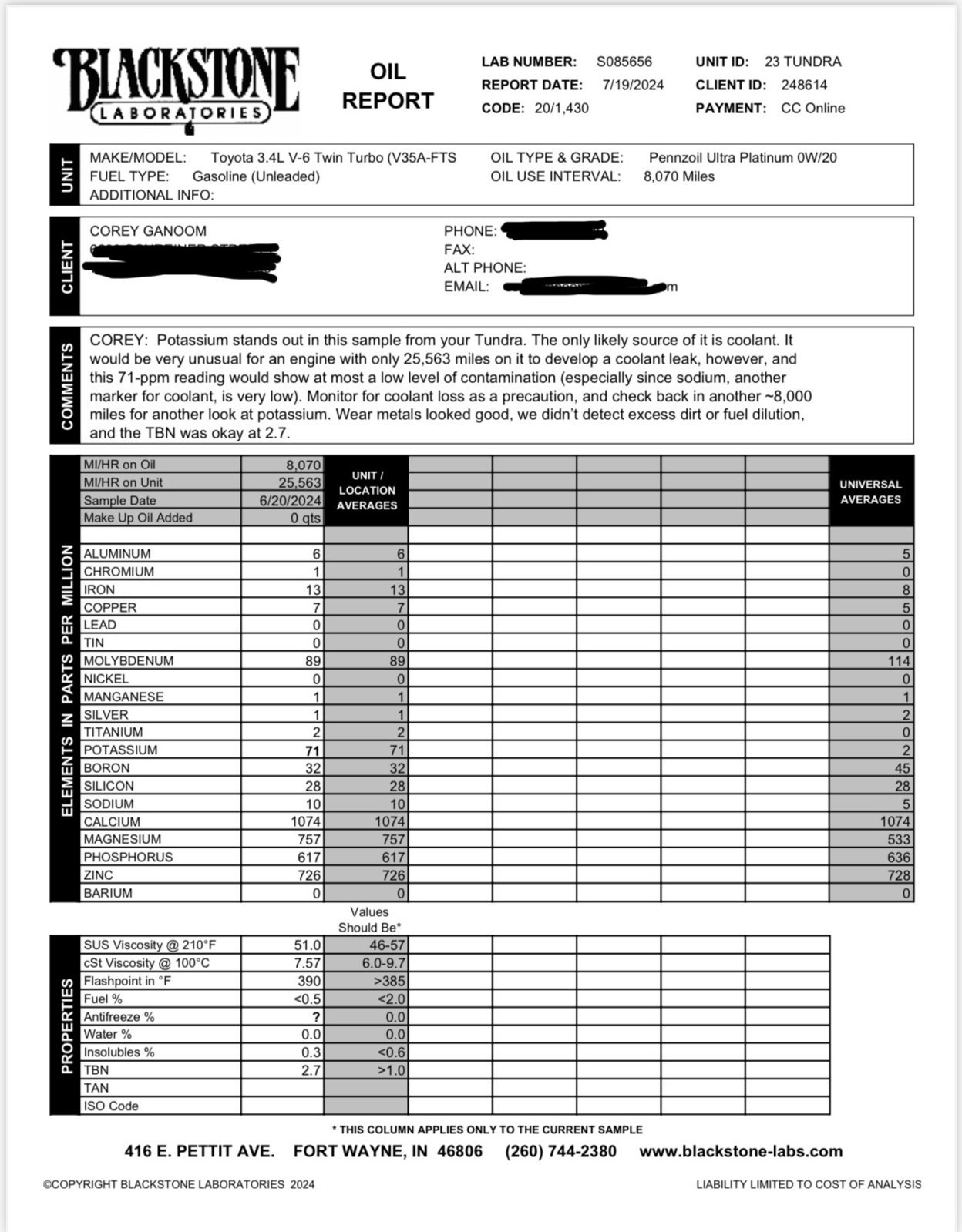

    3

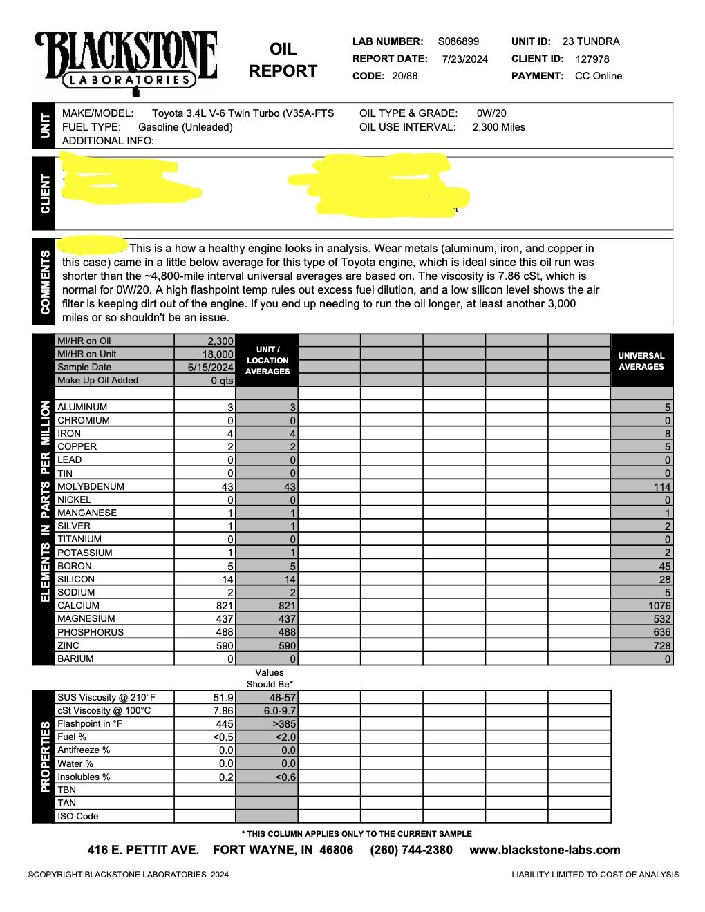

    Aug 13, 2019

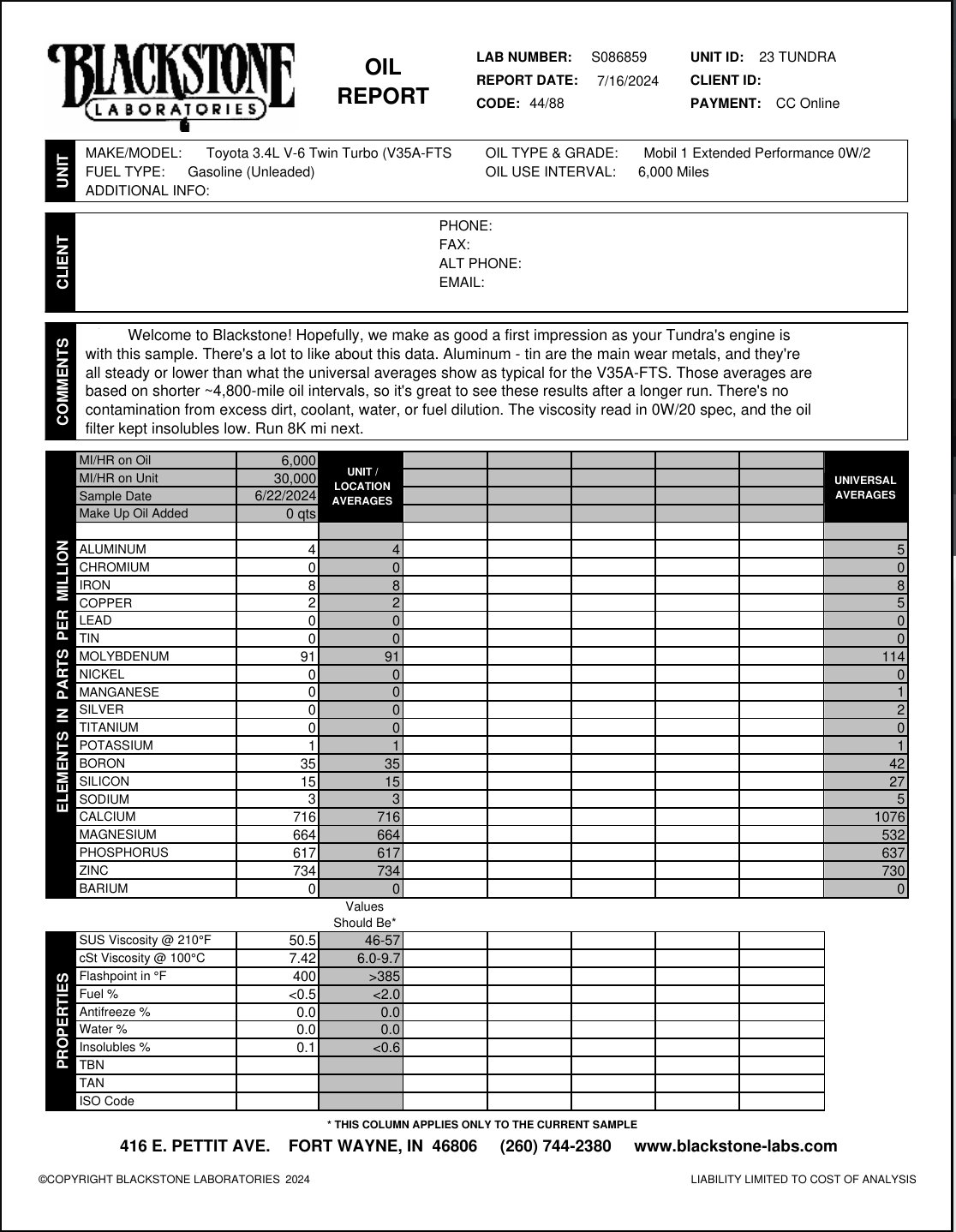

    Here's one without silver in it, 6k on the oil and 30k on the truck. This was with ~800 miles of towing a small boat on the highway and ~3000 additional highway miles.

  5. Jul 17, 2024 at 2:19 AM

    Remember when it was winter and everyone had their panties in a wad about fuel dilution? "they're making oil" they said. "they have injector problems" they said. The weather warmed up and we haven't seen a high fuel dilution since.

    good report.
    FWIW...those results are VERY close to my 32k report on my '20 5.7L.
    like near exact...and I have 106k now.
    BoulderGT3 and Tundrastruck91 like this.

    Yah I was happy with that report, I'm kicking around running 5w-30 euro for a longer drain verses the M1 EP 0w-20. The viscosity got sheard down from 8.8 to 7.5 so the extra viscosity and HTHS would be a perk. I don't think the oil would be in grade after 10k even without fuel dilution.

    I sent out an oil sample to Blackstone Labs in June after discovering my truck falls into the engine recall category. Blackstone received my sample 6/24. I just got my report yesterday 7/19. (For those who are wondering, it takes a few weeks to get results)
    I have a 23' Limited Off-Road non-hybrid that was mfg. 10/2022. I have mixed highway/city driving with this vehicle. I live in central Ohio and experience all different types of weather conditions. We have taken this truck on multiple long-distance road trips. I have hauled multiple yards of topsoil with this truck and have not experienced any abnormal engine issues. After the software update for the transmission, I no longer experience the extreme hesitation/throttle lag that many forum members noticed. The only changes I made to the truck were installing the mesh Toyota TRD air filters and throwing on the TRD Pro muffler-back exhaust dual tip tail pipe.
    With a newborn, wife, and 4 dogs, I certainly hope I do not experience engine failure in the future due to "debris." I could not imagine driving a compact loaner around town if the engine fails....
    I prefer to perform my own oil changes and basic maintenance because I have my own tools and capable, I know it will be done correctly, I do not like to wait at a dealership, and I am too busy to schedule on "their time."
    I installed a stainless magnetic oil drain bolt made by Votex with my first oil change at 5,000 miles.
    I use OEM Toyota (Denso) oil filters with each oil change.
    I use Pennzoil Ultra Platinum 0W-20.
    The second oil change was performed at 11,000 miles, the third at 17,000 miles and this last one (4th) was done at 25,000 miles.
    I did not want to extend the interval on the last change as long as I did, but my wife and I were expecting our son in May and we were extremely busy with work and preparation for our lifestyle change. Ideally, I would like to change the oil every 5-6k miles, however the TBN report shows I was ok with the longer interval 8k.
    Here is my test result from Blackstone Labs (I will be sending another sample with the next change to compare trends):

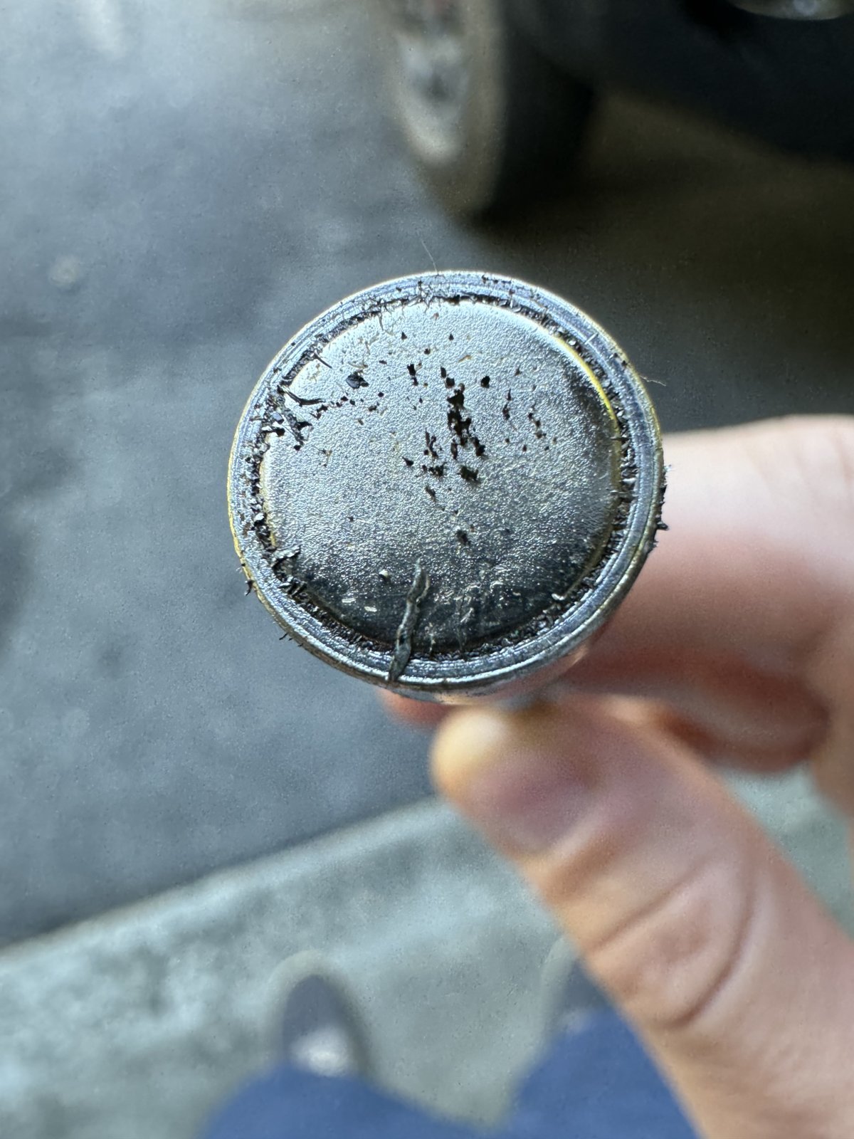

    Didn’t run an oil analysis report, but did request my used oil filter from my Toyota dealer after my 20,000 mile service on my 2022. Pulled filter apart and ran magnet through it, below is results. I assume it is fairly normal to see this amount in a newer engine, but I have no frame of reference or experience with what’s normal and what’s not.

    Someone will correct me if I'm wrong, but at 20,000 miles, I wouldn't expect an engine to still be shedding break in metal.
    That, to me, looks like a concerning amount of metal.
    I'm comparing to my roughly 5K mile '24 filter inspection, pics here:
    https://www.tundras.com/threads/wha...gen-tundra-today.104778/page-231#post-3656429

    Looks like yours at 5K was much cleaner! One would think by 20K they would be flushed out. Is concerning.

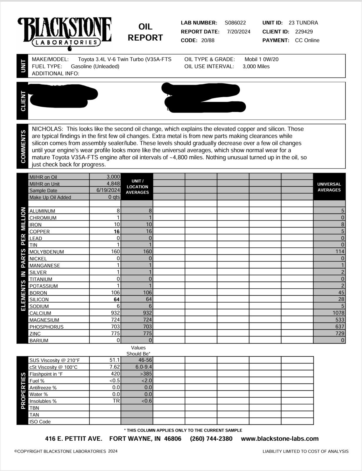

    Looks like I got a good report for my first analysis. Not sure whether to be happy or sad about that. ;-). This sample was taken with only about 2300 miles into the change cycle.

    Just got back the Analysis on my sample after the first 1,800 miles on the truck. 1,310 of those miles were in the first 48 hours of ownership (all highway 70-95mph) and the next 490 miles were all city (stop and go 0-60mph).

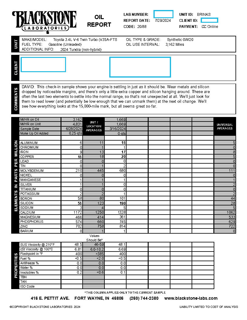

  30. Jul 29, 2024 at 12:58 PM
    #150
    dJunior
    dJunior New Member
    Nov 8, 2023
    #106594
    82
    CT
    After a long wait... here is my second report. Next one will be at 15K oil change.
    Side note- I cant belive how long it took for them to run this. My Forester report is a week older and still has not been done yet. S089590.jpg
    PNW Tundra Mike likes this.
