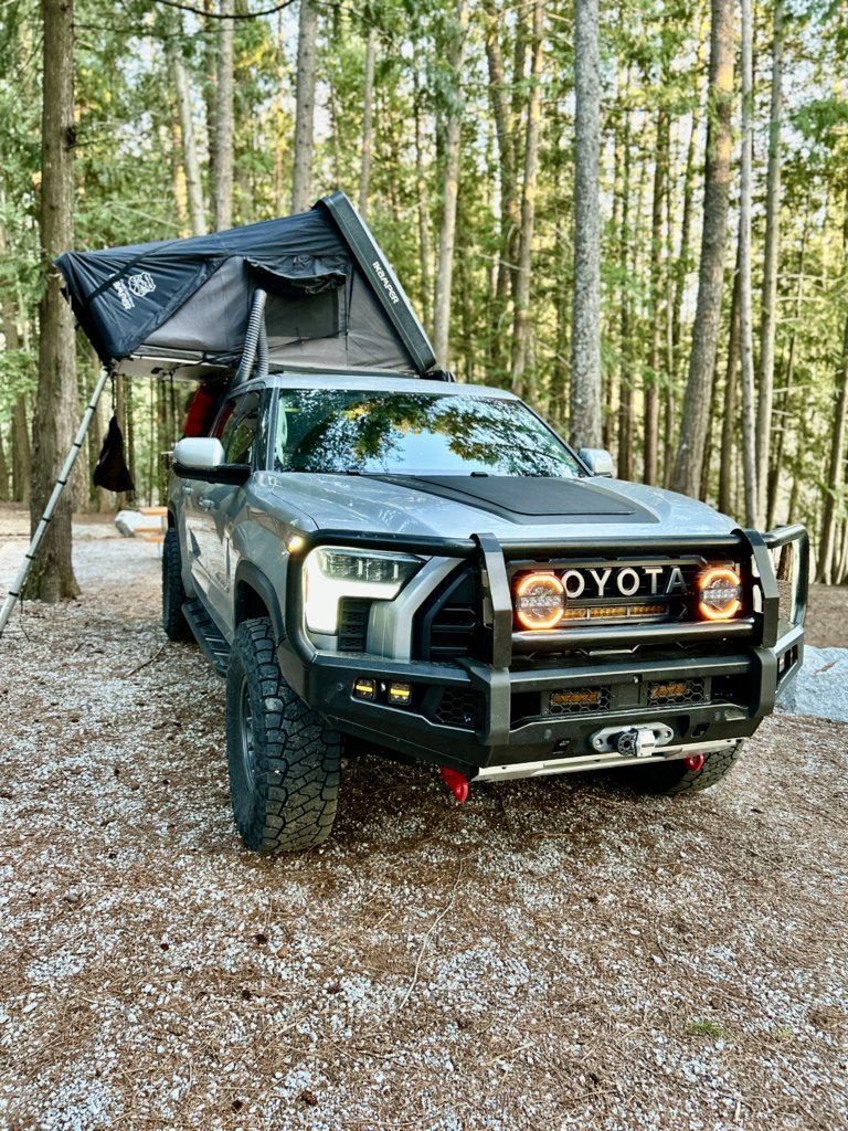

    This is the current configuration of my ‘22 with added 37’s. How-to info below:

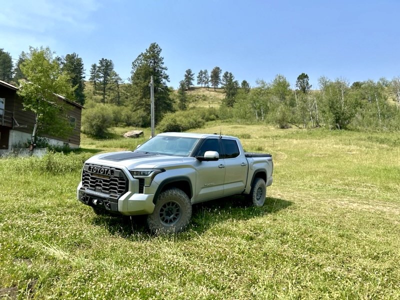

    How it started
