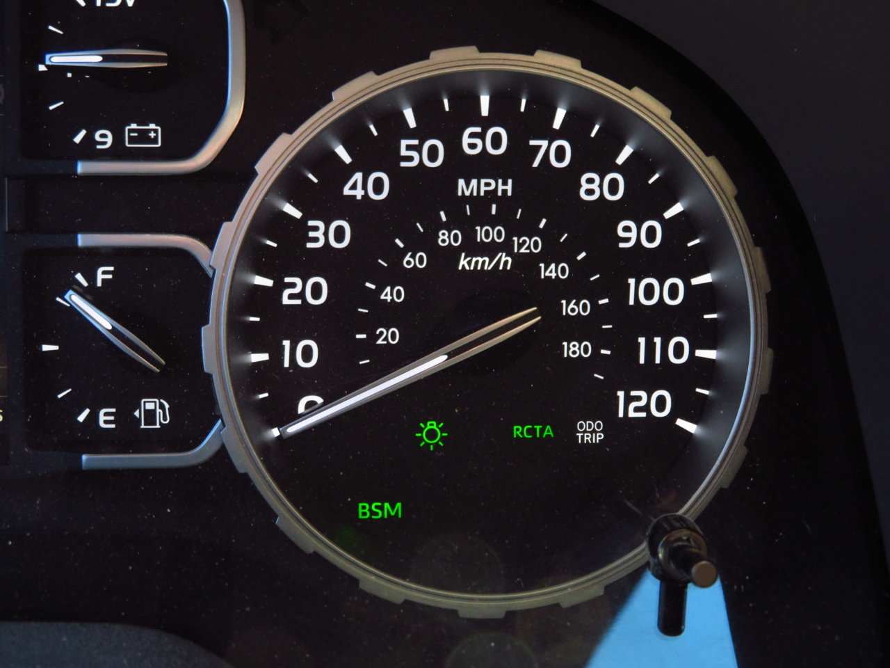

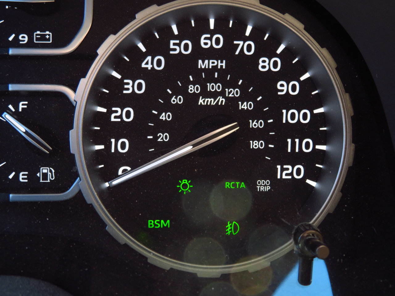

    Hmm, my 2018 does. First photo is headlights on, fog lights off. Second photo is headlights on fog lights on.
    Maddog94[OP] likes this.

    Hmm... As I said earlier in the thread, I could have sworn I had the same icon. I have to check the owners manual. Regardless, nothing appears now and I'm curious if I had this feature, why not now?
