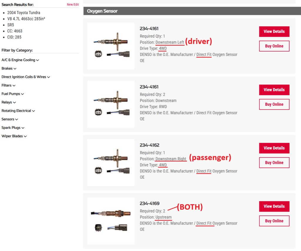

    3. Obviously, get new authentic Denso downstream sensor, look up the "DIRECT FIT" part for your specific truck (4WD vs. RWD) at www.densoautoparts.com (See the part number in pic below), best pricing for authentic parts will be at www.rockauto.com
