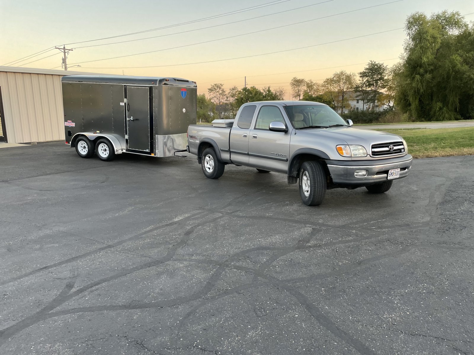

    I use it to pull my 12x6 trailer it gets 10.5 with overdrive off.

    Be careful not to do this under too much load, the pre 02 or 03 trucks are known to have weak overdrive gearing.

    Many thanks for all the effort to help with this issue. I just haven’t seen clamp failures like this. The plan is to reboot both drive shafts and install new lower ball joints. I figure that any maintenance like this would be better than a new truck payment any day.
    I really hate pulling my trailer without the overdrive however 3k rpms around 70 puts that little 4.7 right in the sweet spot for horsepower and torque.

    There’s also no law that says you have to tow a trailer at 70mph. 60mph in Drive will keep your rpm down and your mpg up a smidge.
