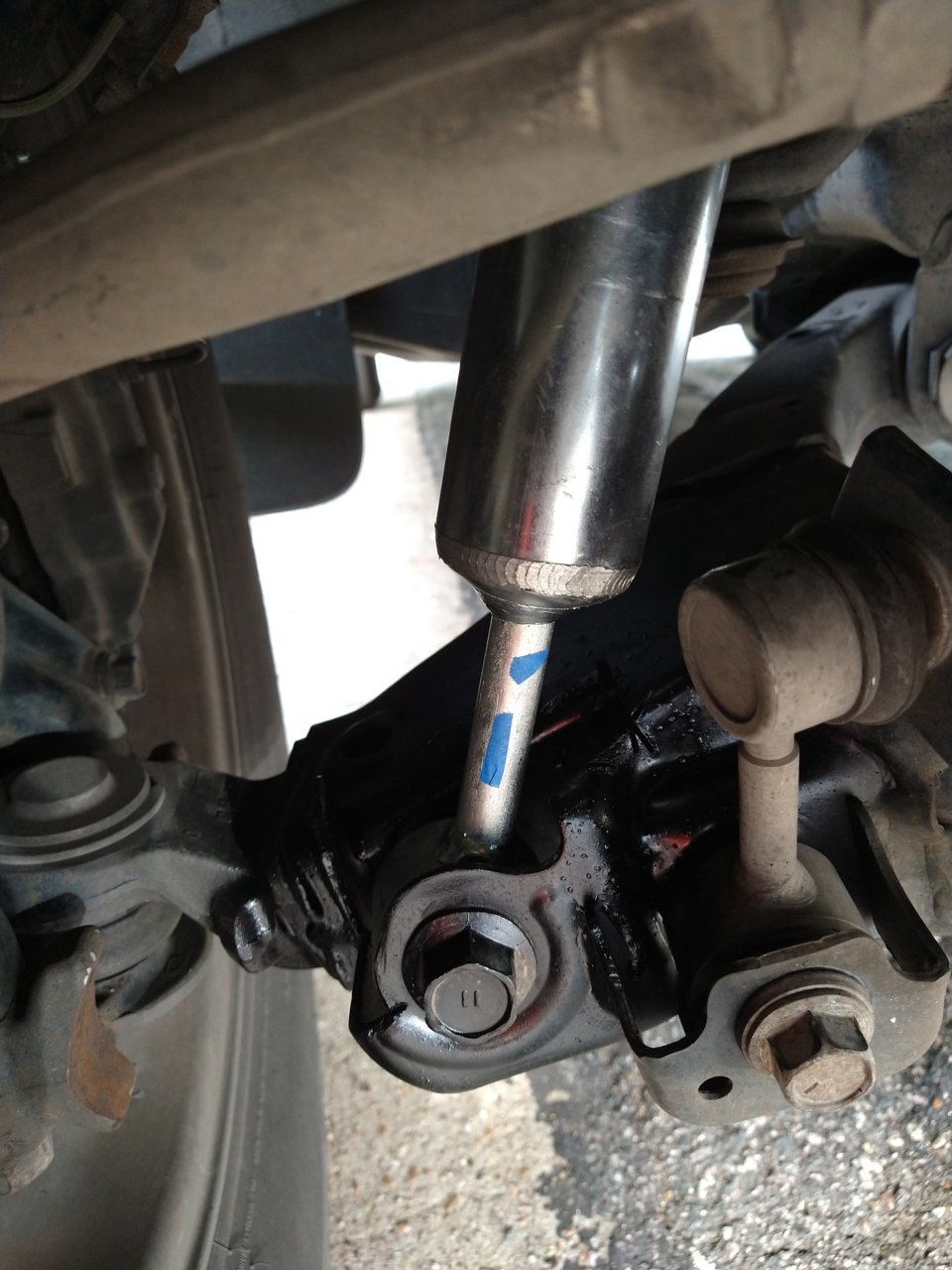

    Sounds good I'm just gonna try to do it myself. Like I should've with the coilovers.

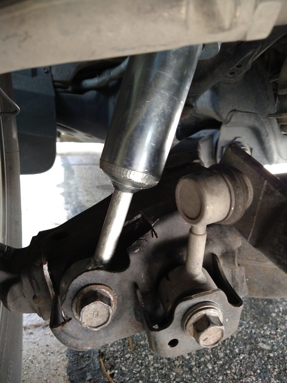

    Not sure why I didn’t throw them in the trash. Can’t sell due to being notched, but shops do this crap when not needed and are like everything is fine.:confused:

    If you look at the pic @Vizsla posted.... if it needs to be opened up at all, a side grinder would be your friend here. Just don't make those square cuts, instead start off on the inside opening area and take a little material off like his picture shows. This is easier when they are off your truck and before installing.

    All they did was clean up the cuts a little and spray paint it a little.

    Honestly if you never leave the pavement, you'll probably be OK. As long as those cuts didn't actually make it into the main body of the LCA and its only on that tab that the coilover mounts too
