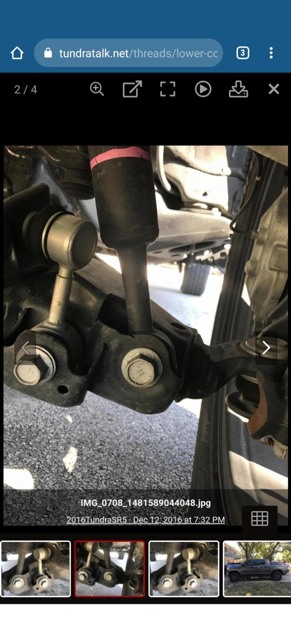

  4. May 19, 2021 at 9:32 AM
    Randy.lee88
    Randy.lee88 [OP] New Member
    May 19, 2021
    #63265
    29
    Silver sky metallic 2010 Tundra
    Here's a pic of what I'm talking about however this isn't my truck. On mine they didn't cut it as clean as this

    That's messed up! I've never seen anyone do that for a coilover installation. That cut makes a weak point in that area that, if stressed, will continue to tear.

    Dude that is very concerning. I don’t think it will fail right away, but even in the pic you posted which I realize isn’t your truck, the cuts run past each other. Sharp corners and extended cuts like that WILL crack further into the metal and eventually fail. The best way to do this cut would be to drill holes at the corners so they’re rounded, and possibly plate the cut area for reinforcement. That’s without really being able to look at it in person and think about the forces on the LCA, but I would be very concerned about driving with them cut like that long term. I would just keep an eye on it and make sure the cuts don’t start cracking.

    The clearance is required for extended travel coilovers on these trucks. If done correctly and left smooth it's NOT an issue. Mine had been like that for 120K or so.

    What shocks do you have? I've never heard of doing that with any kind of shock regardless if it's extended travel. OP idk what I'd do if I were you but it sounds fucked. Find a friend with a welder and at least weld it up where any cuts are to avoid stress concentrations.

    Dispute the charges with a quickness, that is some sketchy work at best. They cut the front of it too.
