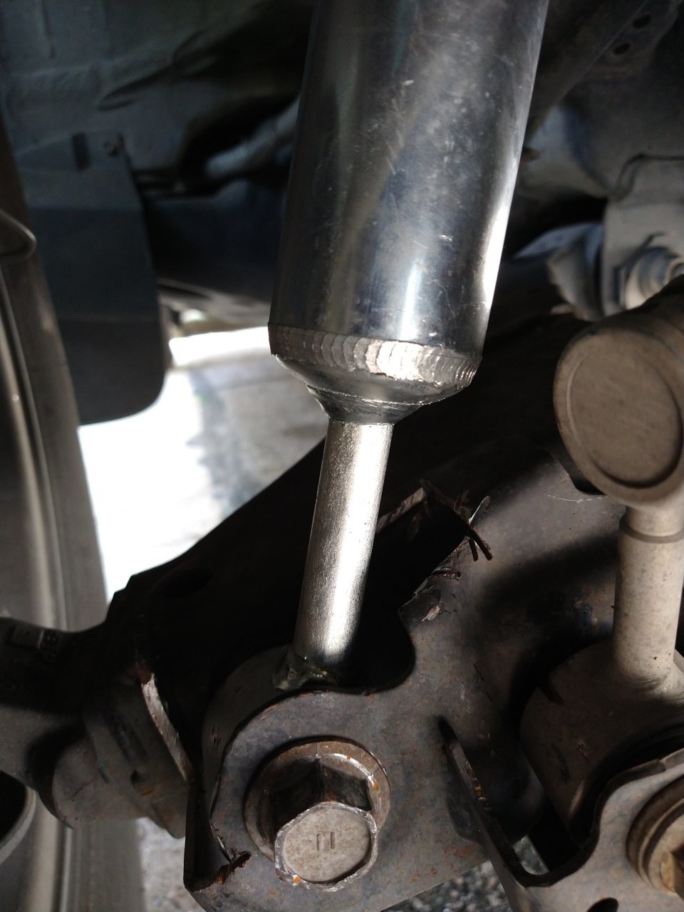

    There is NO NEED to do that. Craziness defined. I have the exact same coilovers. Not exactly cheap at all. The same price point as my OME's I had on my 07. They come preset at 3". Mine are set at 2.75". Plenty of clearance with the LCA at full droop. I have Zone UCA's but those are for a good alignment like the SPC's of course. Pic vvv20210519_153958.jpg

    OP that looks terrible, at least you got your money back. Had to notch for Fox 2.5”, both extended and non-extended. But it’s because the stem is much larger, and offset to the rear. More like making the existing notch wider, but did have to go tiny bit deeper with the extended travel. ADF71CD5-F0C4-408E-B6C1-A873ECC94B71.jpg

    Silver sky metallic 2010 Tundra
    See I would have been fine with that
    Vizsla[QUOTED] and Black Wolf like this.

    #56
    43,515
    That makes total sense. The 2.5's are beefier all around of course and sometimes you have to allow for that. Especially for you folks that get air time out in the desert....:thumbsup:
