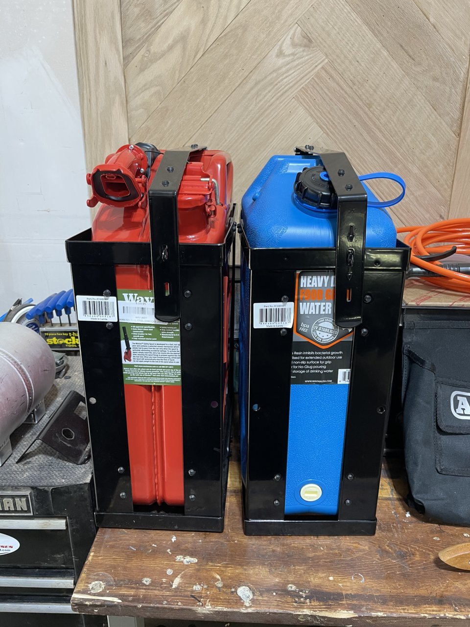

    PS. These are still available. Got a couple of folks interested in OR. Free to someone in WA that can come get ‘em. Or if someone can mule them down to OR I’d appreciate it

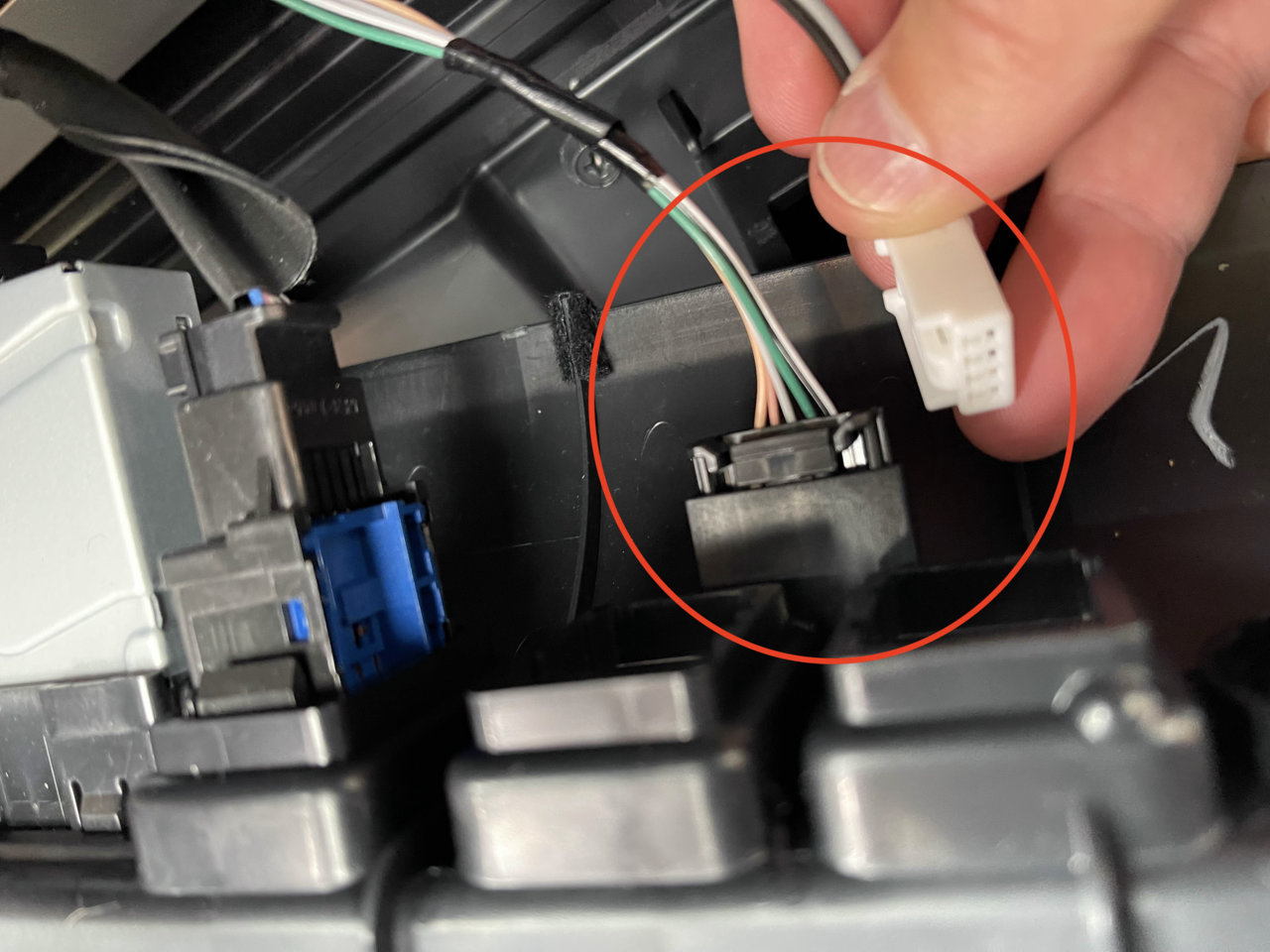

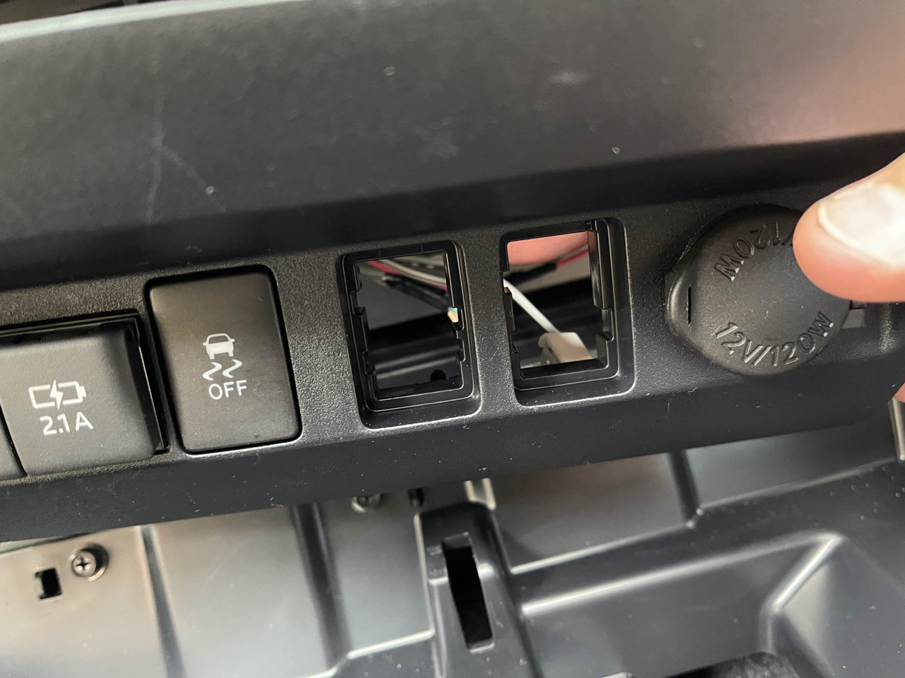

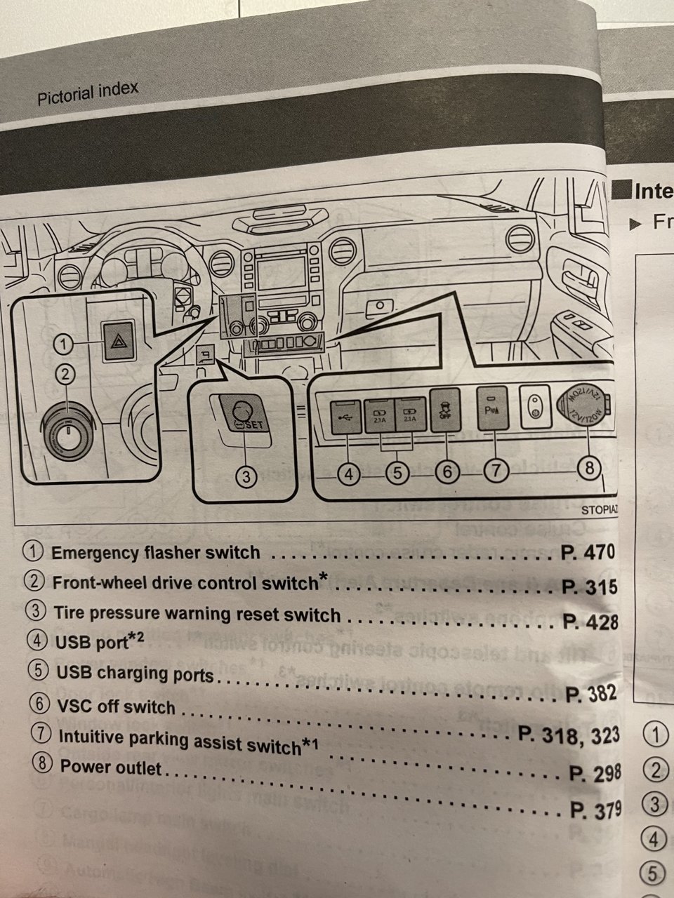

    @RainMan_PNW I have a low priority ask if you are interested in solving a puzzle. I tried digging through all the wiring diagrams you've posted here, but quickly realized I don't speak this dialect of Engineering.
    When I pulled apart my dash today I noticed there are two sets of wires behind blank switch panels right next to the USB ports. Any idea what these are for? The blanks actually had holding pockets for them, but they don't plug into anything functional.
    First pic are from the interior side with the blanks removed. Second pic is the two wire bundles in question.IMG_2671.HEIC.jpgIMG_2672.HEIC.jpg

    Okay, I dug up the manual. Looks like one wire bundle is for the parking assist switch our trucks don’t have5D12D36A-D7C1-45DC-AF92-1438914F93BC.jpg
    And it looks like the other is an audio port of some kind. Maybe for the alternate stereo that we don't have in our trucks? The primary manual has an "AUX Port" reference, but says to check the Nav and Multimedia manual. That manual has no info for an Aux port...so I think we have a gap in their manuals.

    I believe the white connector is for the Glass Break Sensor.

    One is for the glass break sensor, and the other is for parking sonar.
    The instrument panel wiring harness is pre-wired for both.
    For GBS, you can buy a kit (includes the sensor, and an ECU that plugs in up under the dash on the driver's side) - for the 20/21 TRD Pro it already has the hood latch sensor in it.
    For Parking Sonar, you'd have a lot more to add to get it working...I'm in the middle of actually doing that for someone here soon. It's not cheap.

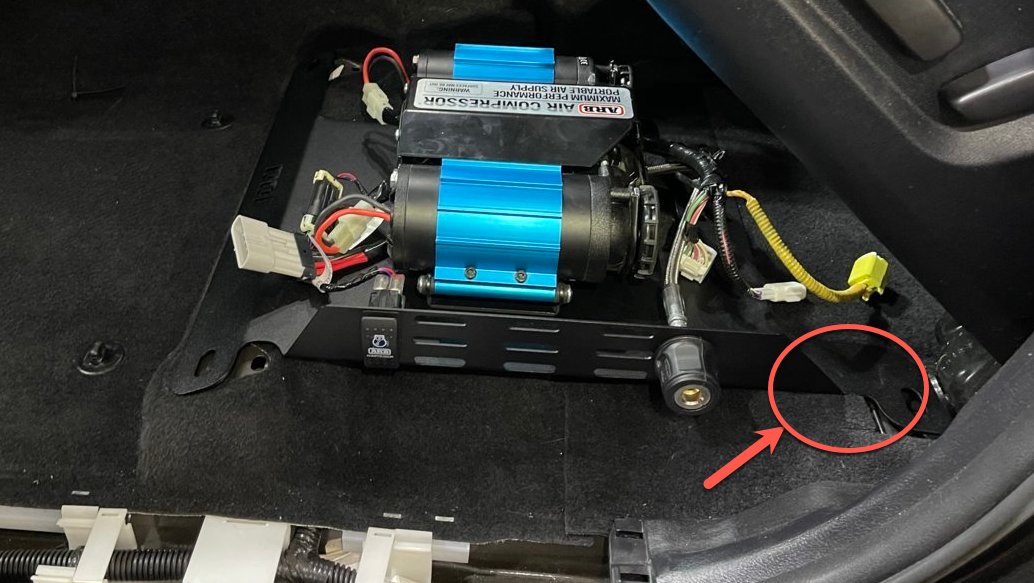

    On my truck, there was a bracket under the carpet inside this circle that I had to modify the DDI mounting plate to clear. It looks like that bracket is on your truck too, but doesn't seem like you had the fitment issue I did.

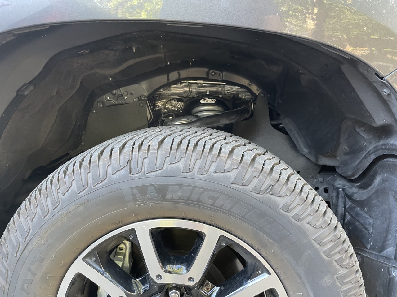

    Finally got the Eibach Pro 2.0 on. Level left to right, 1/4” rake with out of box setting (2 1/4” lift in front). Will add CB +1 after the alignment this week. New tires in a few weeks.
    Not nearly as cool as Rey, but I am enjoying the process.

    How is the ride so far? Eibach seems to be making more and more traction on trucks and their new rear reservoir kit looks pretty nice.

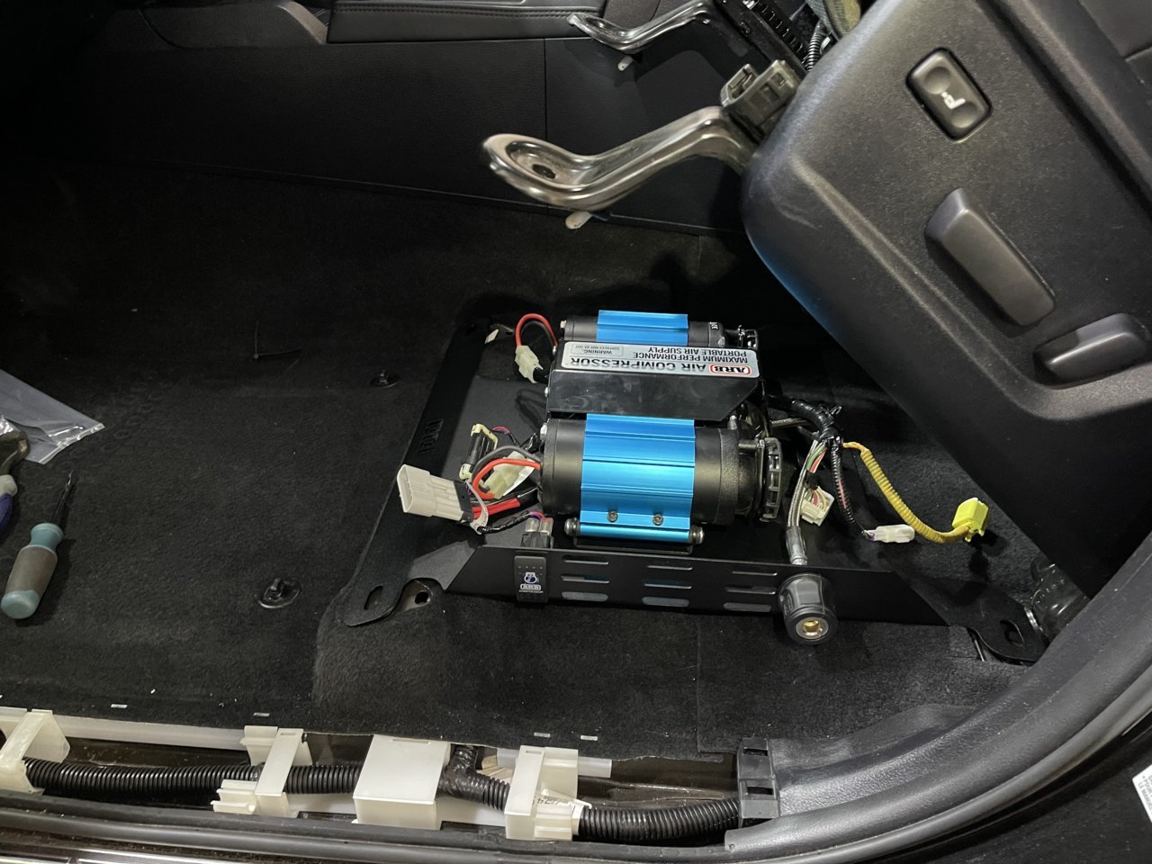

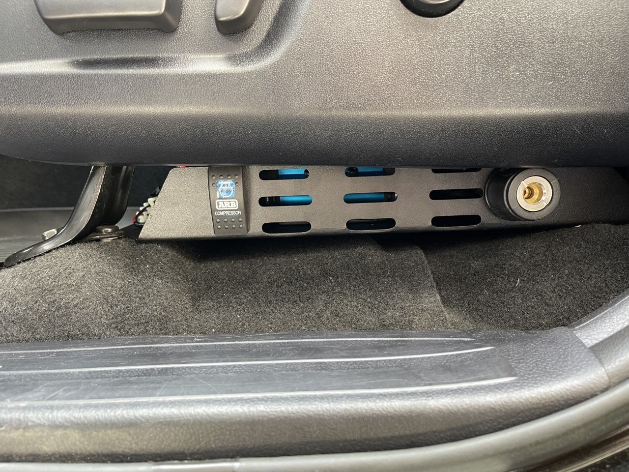

    So my ARB kit was the mobile unit that was in a case. So I converted it to fit permanently. I lengthened a couple wires to make it work. I need to revisit the relay I used and upgrade to thicker wire. It’s getting pretty hot during use. But other than that it’s been great. For the quick disconnect I used arb line from the outlet of the arb. Just found the length I needed.

    I only have a short couple of drives on it but so far so good. Feels firm, no nose dive with hard brakes ( did a couple on purpose to help seat) and less roll in the local round-a-bout. And speed bumps are much smoother. Ask me again in a couple months!

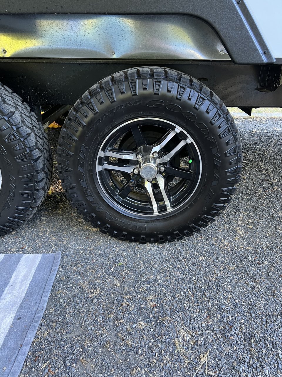

    Saw this Minnie setup today at Cabela's, thought of yours @Green Thunder. Looks like he lifter the trailer?

    Minnie’s now have a package with beefy tires and suspension. My in-laws bought and new Micro Minnie this past spring. Tires on it are more aggressive than most stock trucks. Here is a picture I had snapped this summer when we were camping with them. They don’t have any skirting below the frame line to keep the clearance.

    @Dsptundra is right, lots if not all of those models now have the “Offroad” package. It is another mandatory option. Think they just flip the axle and put on offroad tires. Mine are not as aggressive as what Dsptundra posted, but they are not nasty ST tires oozing oils.
