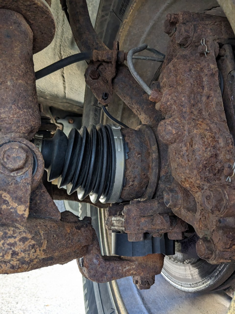

    I crawled under the front of my 2005 Tundra last night. I'm planning to replace all the control arms, ball joints, shock assemblies, etc....basically the entire front end.

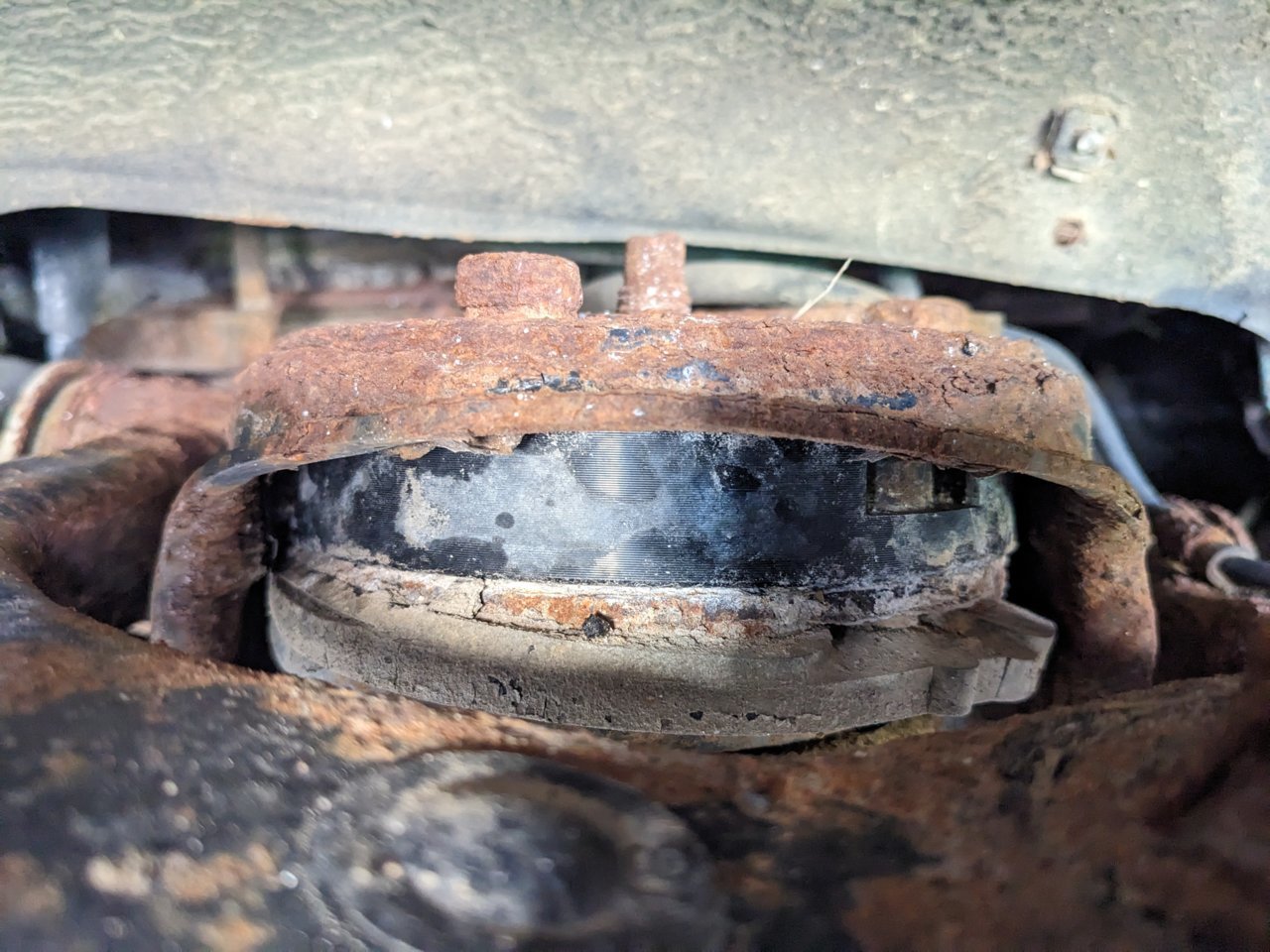

    Anyway, I saw these spacers that I didn't notice when I looked the truck over before I bought it (I think they were covered in mud from the guy's long driveway).
    Are these spacers just a leveling kit? Looks like about an inch or two thick.
    I like the way the truck sits, so I'll probably reuse these if they aren't harming anything.
    The hardware is pretty rusted, can any one identify what/where these are from so I could maybe get new hardware for what I start swapping components?
    Thanks for your help.

    Please tell me you bought this truck for the price of a mcnugget meal.
    Generally you want to avoid spacers on these trucks. And that amount of rust...
    You will never, ever, be able to easily replace anything on this truck. Minnesota loctite.
    I'm sorry. That's the way it is.

    If you start dousing it with pb blaster daily, you might have a chance to replace some of that.
    You might consider driving it just how it is, for what it's worth. You're opening pandoras box if you start disassembling that.

    Ooof. If that's what the calipers look like, I'd hate to see the frame. Just the bucket for the strut that has the spacer is toast. And you'll want all new hardware to go with your suspension. Make sure you use OEM LBJs. And that rotor looks pretty toasty also.
    You may want to give us some pics of the frame to look over before you proceed with a front rebuild. You may be putting lipstick on a matchstick frame and that wouldn't make sense. Unless this has had the frame replaced recently, I can't imagine it's safe to drive. (more info)

    You sir, are entering a world of pain. And yes, that’s a spacer on top of the strut. That’s a shield on the lower ball joint, not a spacer. That coilover shock is likely factory and toast, wouldnt keep the spacer if replacing the shock. Would definitely do a deeper dive to assess the frame rust before proceeding. And hopefully you purchased this truck for the price of a happy meal, although it’s probably gonna leave you sad.

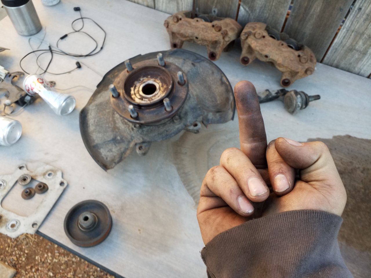

    how have folks been changing out the hub/bearing components on the steering knuckles?
    I don't have access to a shop press (unless I buy one from Harbor Freight). Is it too much to handle with a screw type bearing installer/remover (the one I have states that it's for front wheel drive vehicles....so maybe this one is too small to fit these bearings)?
    I haven't asked the shop that does my inspections...maybe the younger guy there would do it for a few extra bucks.
    Your thoughts?

    I was under the impression you needed a 25 ton press for those

    The front wheel wheel bearings call for at least a 20 ton press. The procedure is multi-stepped requiring several press dies to accomplish. I’ve got 2 OEM Koyo bearings sitting on my shop bench ready to go. Lack the 20 ton currently. Lack the time as well. So far down the list….

    MechEng13...."I'm going to fix my own truck"
    Everyone on this forum....." The hell you will. First let me drop this knowledge bomb for you....:nuclear:"
    hahaha...seriously though, I appreciate the help folks
    20ton I can handle (with a $250 Harbor Freight Press).....25ton presses get expensive quickly.

    HF has a 50 ton that isn’t too bad either. Also a coupon will make that 20Ton less than $200 if you time it right.

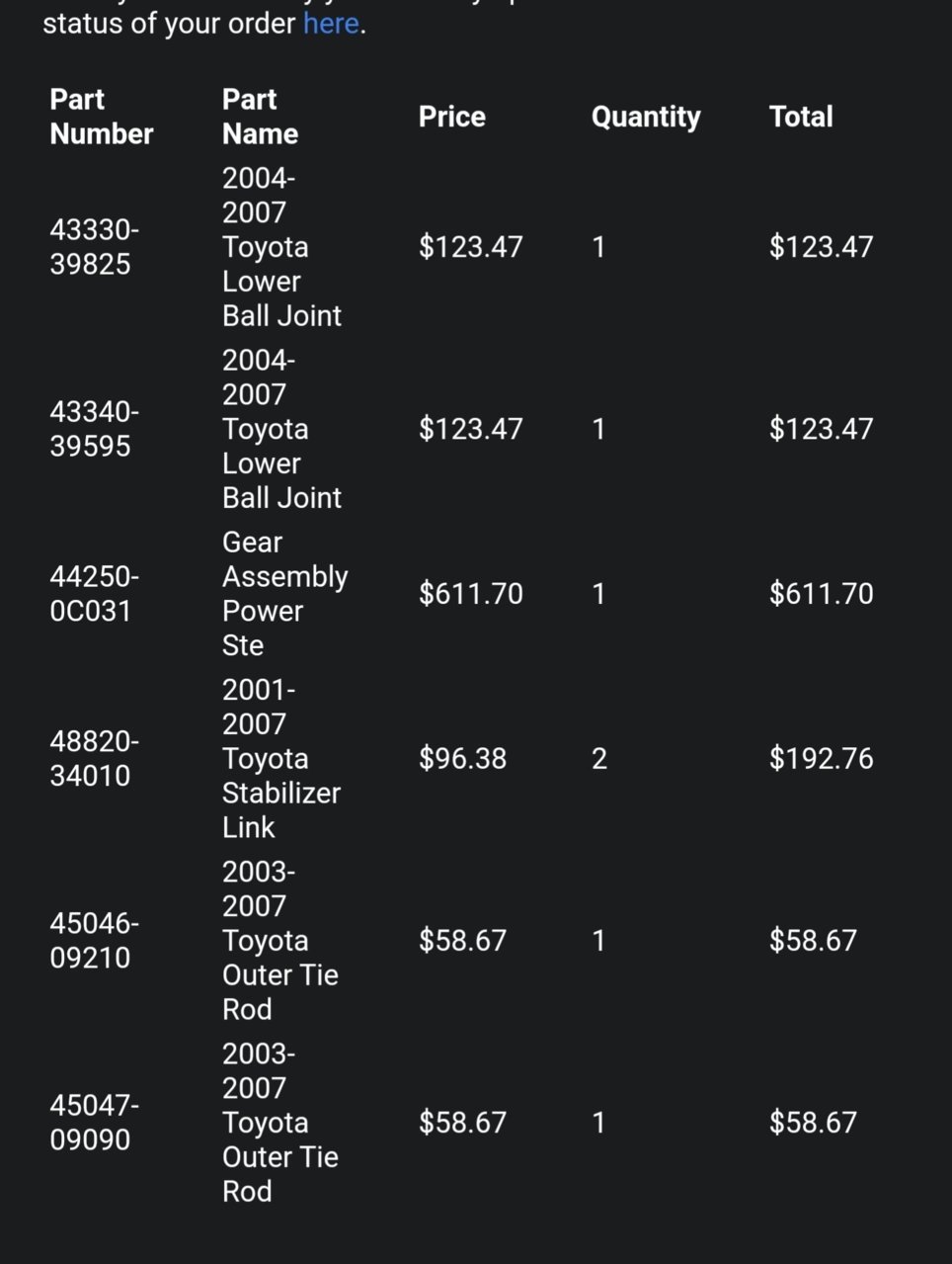

    I went over to my local dealer and they gave me close to w/s pricing. Still found it cheaper online. Gear assembly is back order so they price a reman.

    I'd find a shop to do the bearings for you. It's a pain with the way our spindles are shaped. That or get a second set of hands with your fancy new press. For the hubs, durago has a set on RA. They're in my truck now.
