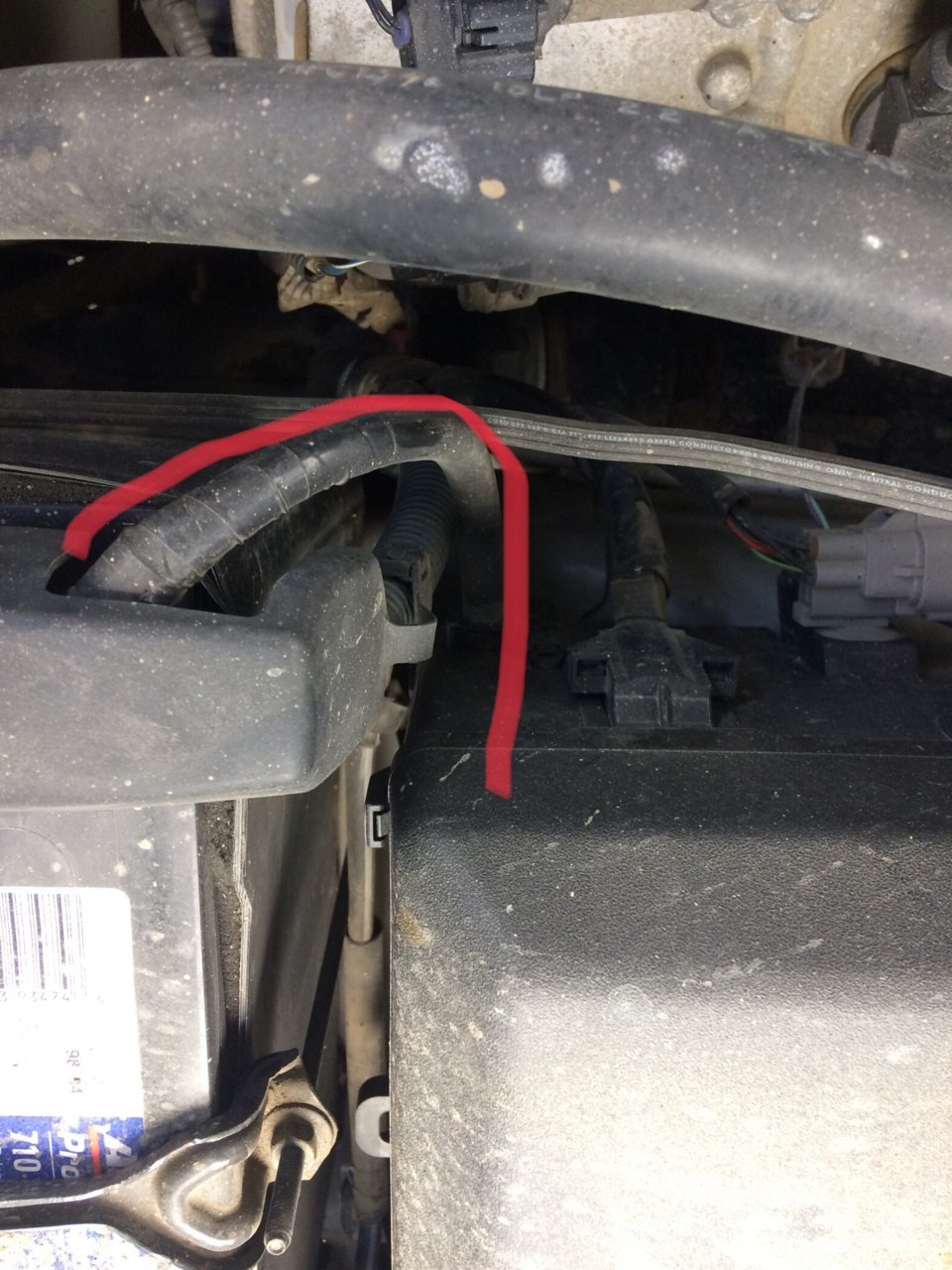

    Umm. Unless something is wildly different on 3rd gens, there is no ground cable from the battery to the fuse box.
    This cable to the fuse box is a positive cable:
    One ground to the inner fender, and the larger ground cable to the engine block:

    yes. you are correct. i'm kicking myself right now. that is the issue. thank god for fuses.
    i'm just going to sit here and continue my self-flagellation...
