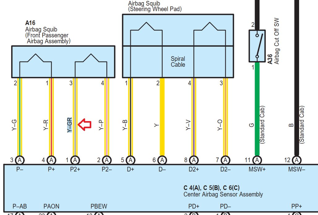

    Glad you bumped this with a quote today. About that wire a few posts back - it looks orange to me. You say it's yellow with grey stipe. Please confirm - it's a stripe down the length of the wire, and you're not taking those stripes around the wire as a "stripe", right? There's a big difference here and it matters for tracking purposes.
    I have 06 EWD's because I'm a fellow '06 owner. When I search for "Y-GR", there's only one wire that's yellow with a grey stripe, and it's for the airbag squib circuit, for the front passenger airbag. I'm not a fan of SRS so I can't begin to tell you the function of the wire, but IIRC the squib circuit is responsible for deploying the airbag, so ... you may want to exercise caution with that wire?

    Well, guess what, when somebody is sitting in the shotgun seat the passenger side air bag light comes on. I will definitely get on that wire. Would you know if its a hot wire?

    Mine does too. Not sure if it's hot or not.
