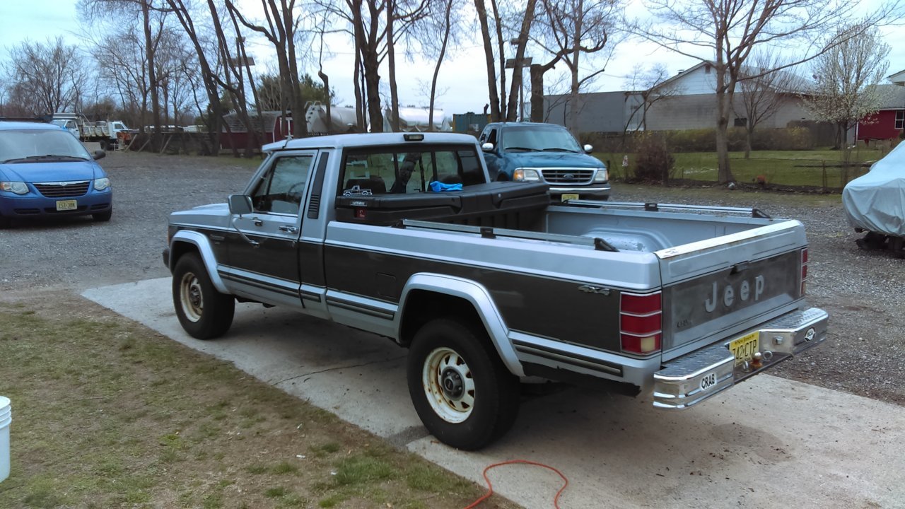

    I always wanted one of the older Cherokee Chiefs like Stacy David worked on. I can't even imagine where you can find one for $1,500 though, even back when he did this episode of Trucks!

    i paid 1600 for my mj like maybe 12 years ago. they're getting hard to find and dam near impossible to locate one with no to minimal rust. there are some out there that are exceptional but big money. the one below is the last year of AMC, 1987
