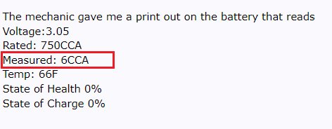

    I'm going to bring the battery to the Interstate store that I purchased it from next week and see if they can dig into it a bit more.
    The mechanic gave me a print out on the battery that reads
    Voltage:3.05
    Rated: 750CCA
    Measured: 6CCA
    Temp: 66F
    State of Health 0%
    State of Charge 0%

    And yeah, single digits CCA is no bueno. I've never been a fan of Interstate batts.

    Take what the mechanic gave you, for example.
    Your battery is rated for 750CCA (cold cranking amps). In most cases you need at least 200-300 CCA to start a vehicle. Even if your battery had been fully charged, there's a solid chance it wouldn't have enough CCA to blast the power required to start the vehicle.
    The battery, as he tested it, was bad. I'd prefer to test it after a full trickle charge just to get realistic numbers, but ... yeah. What is showing there is no bueno.
    A common symptom of a failed battery is exactly what you described: Lights on full blast, but no ability to turn the car over. i.e. the voltage is there to power everything, but not enough amps to push that blast of voltage down the line.

    Ifeel like there is some kind of extra resistence in the starting circuit but I don't know where... any ideas?

    i bet it's just the battery
