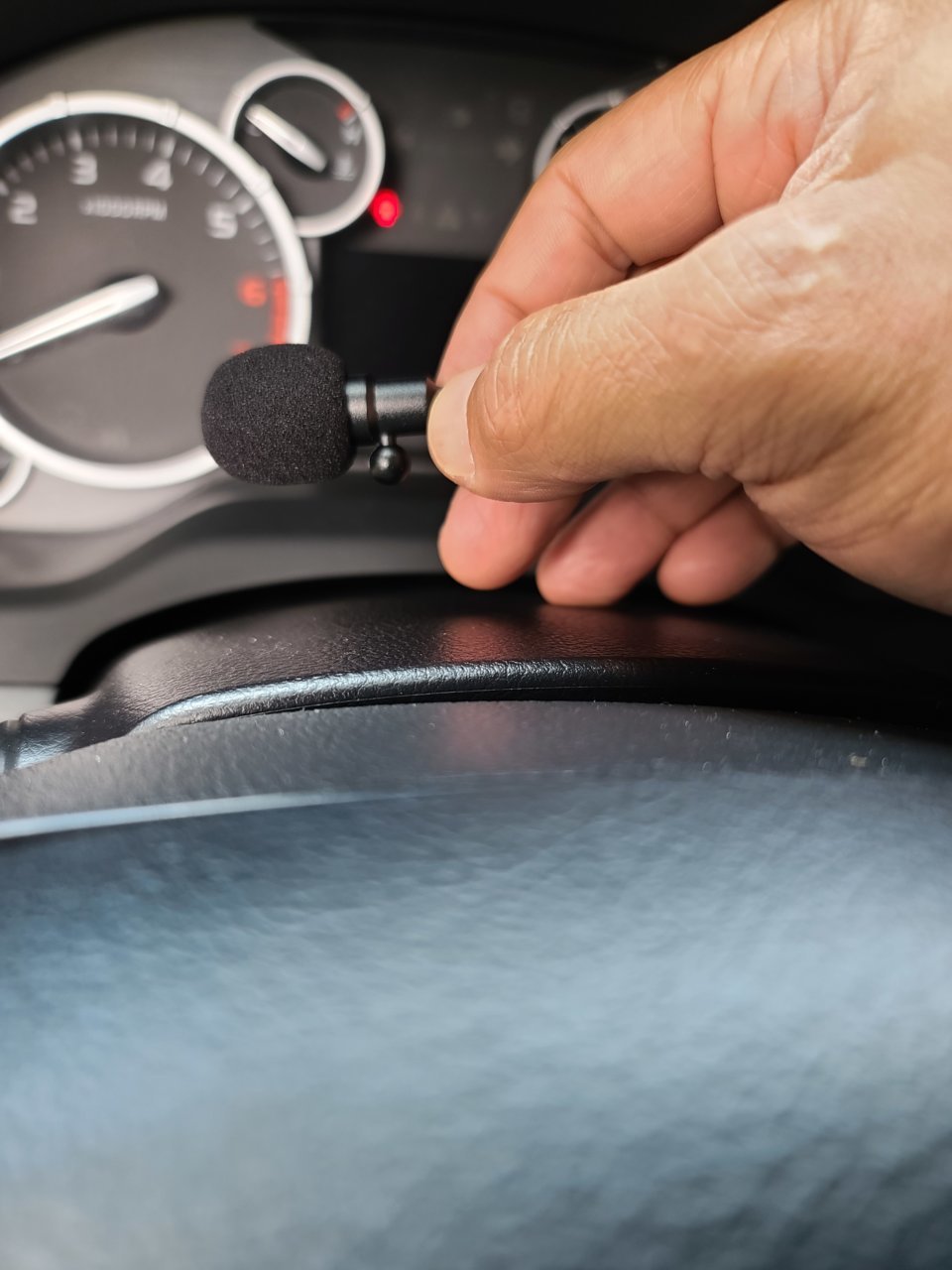

    Looks like the mics the field reporters wear :rofl:

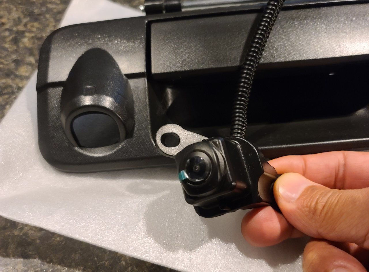

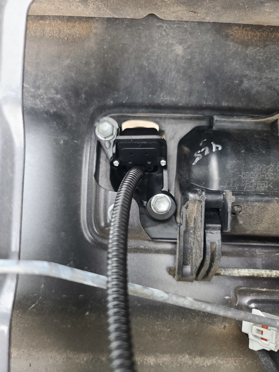

    The tailgate handle/camera came in

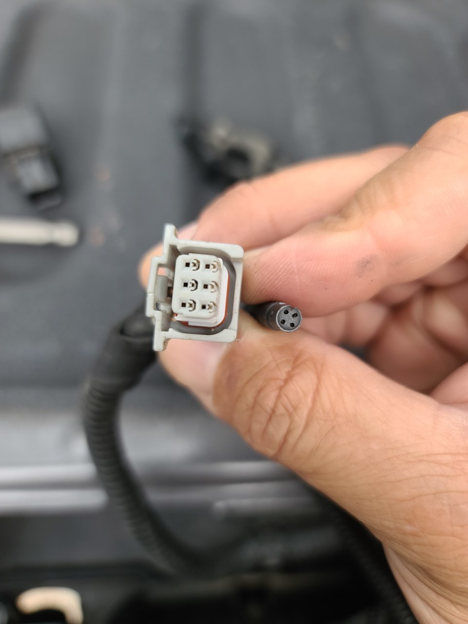

    The camera will bolt in but the connections are different. The 2.5 gen is 6 pin and the 2nd gen is 4.

    That’s not a 2nd Gen connector - that’s an aftermarket connector. You’ll have to get an adapter, and no idea where

    Yeah I've been researching. I need a pin diagram for my 2016 then maybe figure out what the aftermarket harness wires do to possibly source a corresponding terminal or splice into the stock terminal/harness

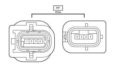

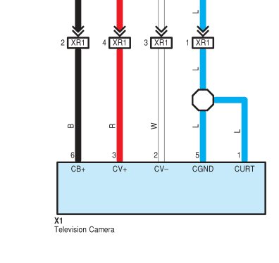

    This is the camera itself. XR1 is the connector at the tailgate and X1 is the connector on the camera.

    Thanks man. The 6 pin terminal. Any pin labeling for that?

    The numbers listed on the diagram in the blue box for the camera are the terminals at that connector.
    1= CURT (must be a second ground, because it splices to pin 5)
    2= CV- (video negative)
    3= CV+ (video positive)
    4= (empty)
    5= CGND (ground)
    6= CB+ (power)
  20. Sep 4, 2022 at 9:05 AM

    Ah so it's basically a 5 pin. The aftermarket terminal is 4 pin. I bet I can mess around and get the corresponding wires spliced where they need to go. Thanks Casey

    I'm thinking I could cut the 4 pin male terminal off then splice into the OEM wiring

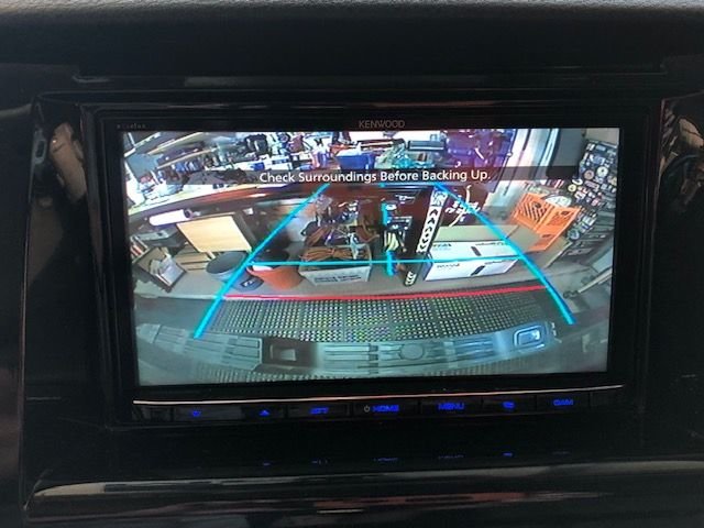

    I'm guessing Pin 1 is the guidelines... Aftermarket cameras have a loop that I believe is a grounded line that you cut to remove them. I might de-pin that one and see what happens, since I've been looking at this for a while.

    My Kenwood has adjustable lines, so I was wanting to use those and dial things in a little more than the factory ones. It’s more of a curiosity thing than something that I need to do

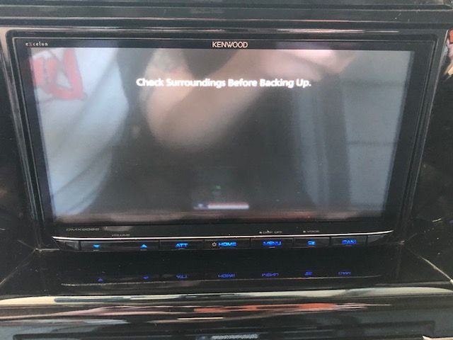

    I think most decent after-market HUs parking lines can be turned off.
    Some of them have a predictive(?) like my wife's Cadillac that move with the steering wheel.
    Not sure if there is any way to cancel the OEM parking lines..
    As @TRDFerguson stated, my Kenwood also has adjustable lines.
    I like them better than the OEM, but I haven't found a way to turn them off.
    My camera works ok, I wouldn't mind a clearer picture though.
    I had issues with it not working correctly a couple of years ago and it seemed to fix itself..
    It would sometimes give me a blank screen but still had the text warming on it.
