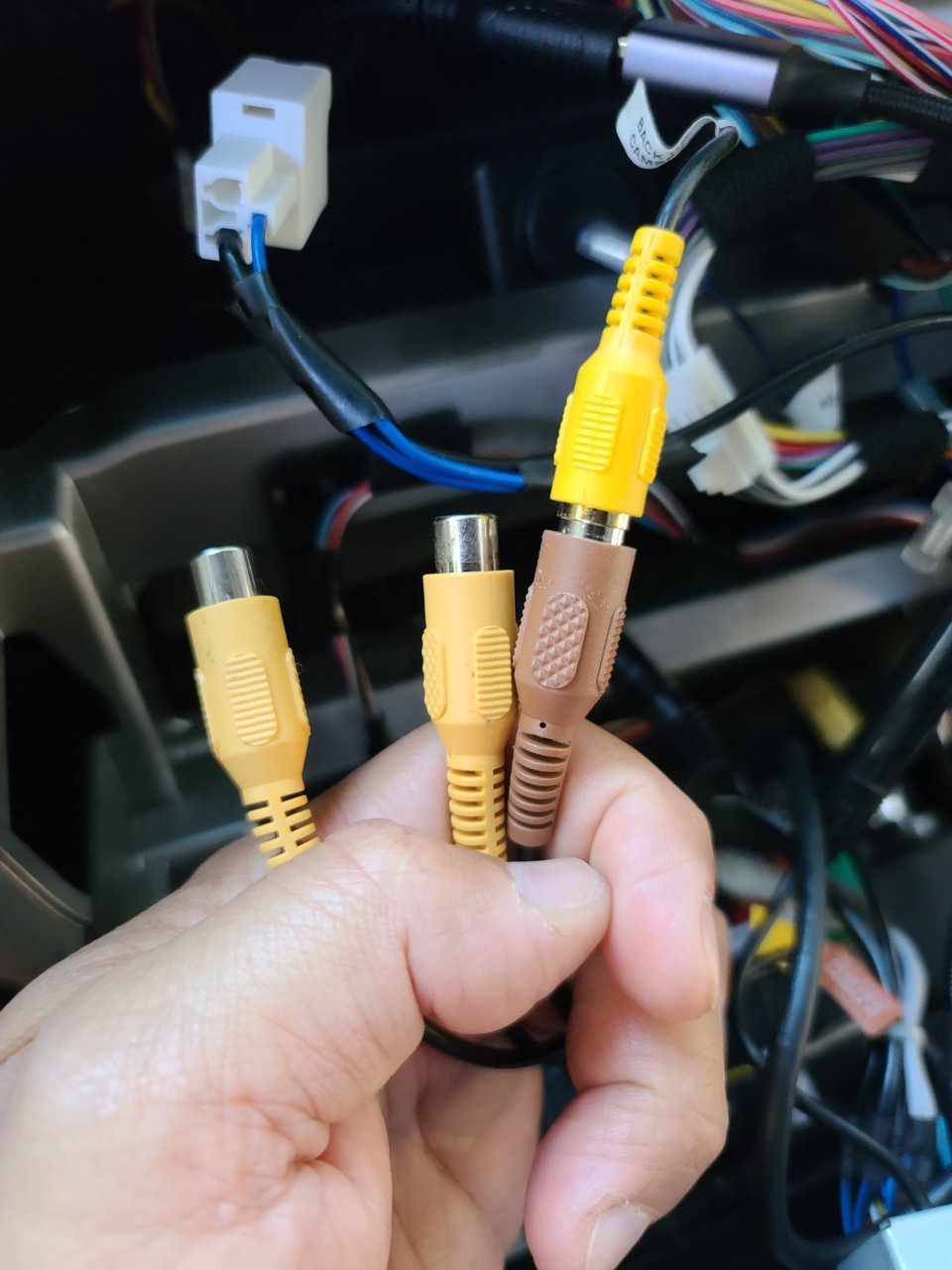

    Did you get your camera working? I had an extra harness from the Maestro kit that I accidentally skipped over during install.

    I did! Unfortunately with this nicer, bigger screen my camera is horrid. Has anyone done a cam swap using the stock placement?

    Someone else had the same thing and they swapped something in the connection. Let me see if I can find that post.

    I have it hooked up right it's just that OEM cam is poop

    Did you get the camera clarity issue figured out? How are you liking the unit so far?

    No. I ordered another tailgate cam that has better resolution and I'm gonna pop it out to try and fit it in mine.
