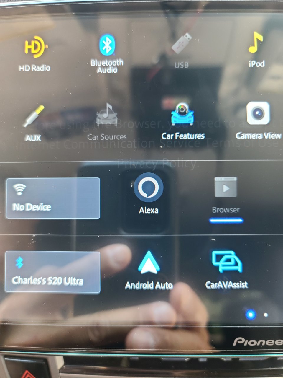

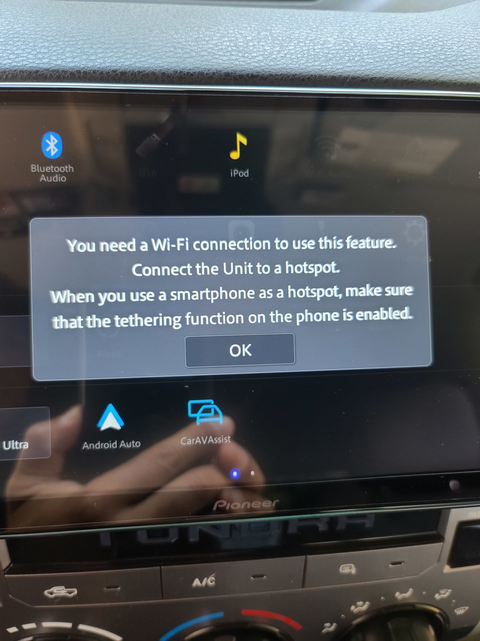

    And I'm also running into the lack of a browser option. Seems like it doesn't recognize my phone's wifi connection.

  6. Aug 27, 2022 at 2:40 PM
    #156
    texasrho83
    texasrho83 Old Member
    Mar 30, 2017
    #7025
    10,696
    Charles
    Conroe TX
    2016 DC MGM 4x4
    See build link
    I got the wifi thing going. Had to change my hot spot frequency to 2.4Ghz. Radio won't run on 5.

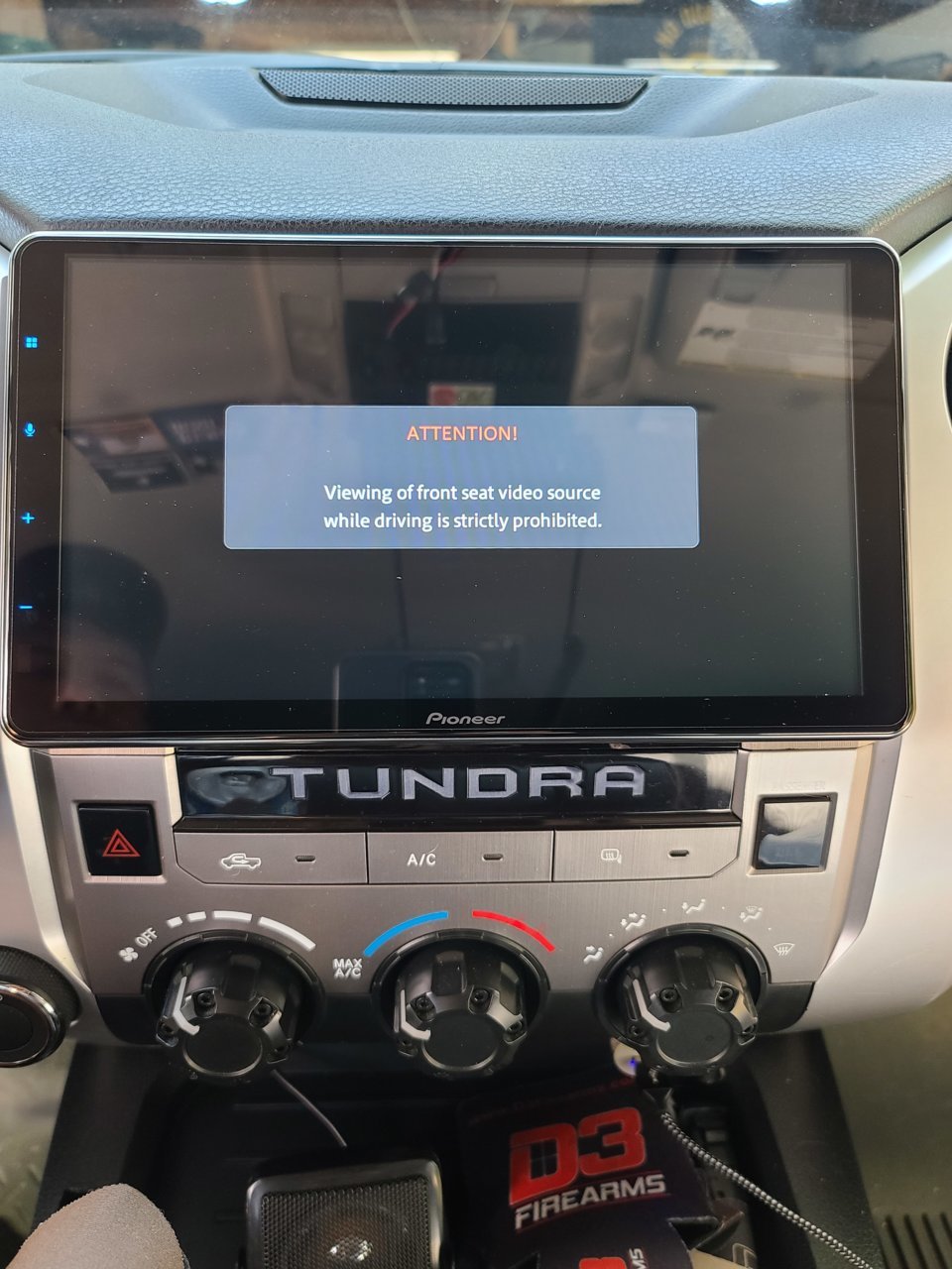

  20. Aug 27, 2022 at 4:17 PM
    #170
    Tundra234
    Tundra234 New Member
    Nov 30, 2018
    #22402
    18,183
    George
    Florida
    2020 Tundra DC SR5 Barcelona
    Alot of them
    Do you need the mini HDMI cable connected?
    Brettstation37 likes this.
  21. Aug 27, 2022 at 4:27 PM
    #171
    texasrho83
    Mar 30, 2017
    #7025
    10,696
    Charles
    Conroe TX
    2016 DC MGM 4x4
    See build link
    I have it connected to my new HDMI port. I hear audio but no video.

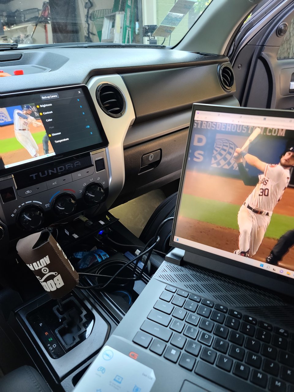

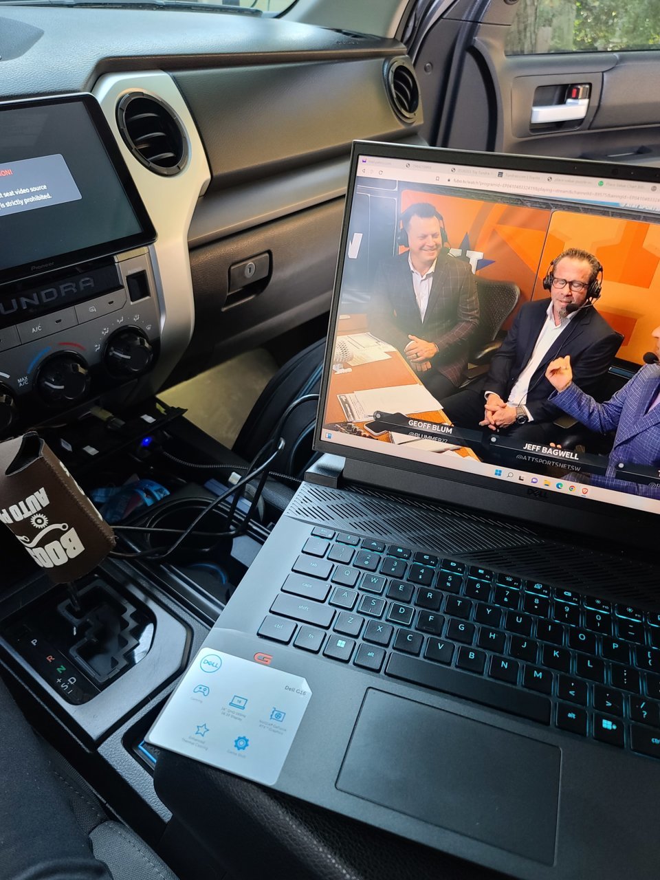

  22. Aug 27, 2022 at 4:32 PM
    #172
    texasrho83
    Mar 30, 2017
    #7025
    10,696
    Charles
    Conroe TX
    2016 DC MGM 4x4
    See build link
    Ok weird. So if I go into the settings for picture adjustment, I can see what I'm casting via HDMI but when I want to view it full screen it won't let me.
  23. Aug 28, 2022 at 8:55 AM
    #173
    Brettstation37
    Brettstation37 New Member
    Mar 24, 2020
    #44254
    492
    Brett
    Catskills NY
    2020 Tundra CrewMax TRD Sport
    I have the Mini HDMI to regular HDMI to watch video on screen and can do so while driving down the road

  25. Aug 28, 2022 at 8:57 AM
    #175
    texasrho83
    Mar 30, 2017
    #7025
    10,696
    Charles
    Conroe TX
    2016 DC MGM 4x4
    See build link
    I had to do the onscreen bypass to get video.
