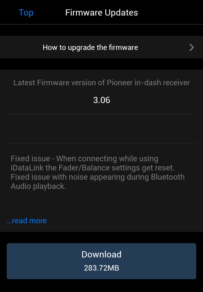

  14. May 6, 2025 at 4:06 PM
    #584
    texasrho83
    texasrho83 Old Member
    Mar 30, 2017
    #7025
    10,792
    Charles
    Conroe TX
    2016 DC MGM 4x4
    See build link
    New firmware update available
  15. May 6, 2025 at 4:09 PM
    #585
    Tundra234
    Tundra234 New Member
    Nov 30, 2018
    #22402
    18,431
    George
    Florida
    2020 Tundra DC SR5 Barcelona
    Alot of them
    Thanks. Wish they would fix the reboot issue.
    texasrho83[QUOTED] likes this.
  16. May 6, 2025 at 4:45 PM
    #586
    texasrho83
    Mar 30, 2017
    #7025
    10,792
    Charles
    Conroe TX
    2016 DC MGM 4x4
    See build link
    Mine hasn't rebooted in a while :fingerscrossed:
  17. May 6, 2025 at 4:47 PM
    #587
    Tundra234
    Nov 30, 2018
    #22402
    18,431
    George
    Florida
    Alot of them
    Mine will do it quite a few times over a couple of days and then it's good for weeks. It's almost like it loses power. I may still try the ground fix that i saw online for another brand that did the same thing.

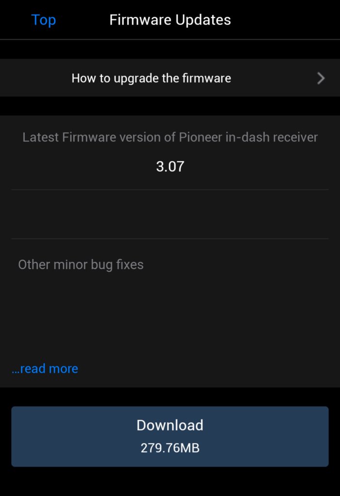

  24. Jul 17, 2025 at 11:39 AM
    #594
    texasrho83
    Mar 30, 2017
    #7025
    10,792
    Charles
    Conroe TX
    2016 DC MGM 4x4
    See build link
    Firmware update
  25. Jul 17, 2025 at 11:56 AM
    #595
    KTMRider
    KTMRider New Member
    Aug 4, 2020
    #50324
    289
    Ken
    2020 Tundra
    King's all around, Dirt Deeds 10" exhaust, 18x9 Method 305 NV, Falken Wildpeak A/T3W 305/65/18 tires, tinted windows (shhhhh)
    I'll try that firmware and see if I lose the ability to view the front camera. I had to go back to an older version in order to program and view the front camera while driving.....
  26. Jul 17, 2025 at 1:28 PM
    #596
    Tundra234
    Nov 30, 2018
    #22402
    18,431
    George
    Florida
    Alot of them
    Their firmware updates are useless for the most part.
  27. Jul 17, 2025 at 2:27 PM
    #597
    texasrho83
    Mar 30, 2017
    #7025
    10,792
    Charles
    Conroe TX
    2016 DC MGM 4x4
    See build link
    I'll download it anyway so I can say it's currently updated for the next buyer.
    Tundra234[QUOTED] likes this.
