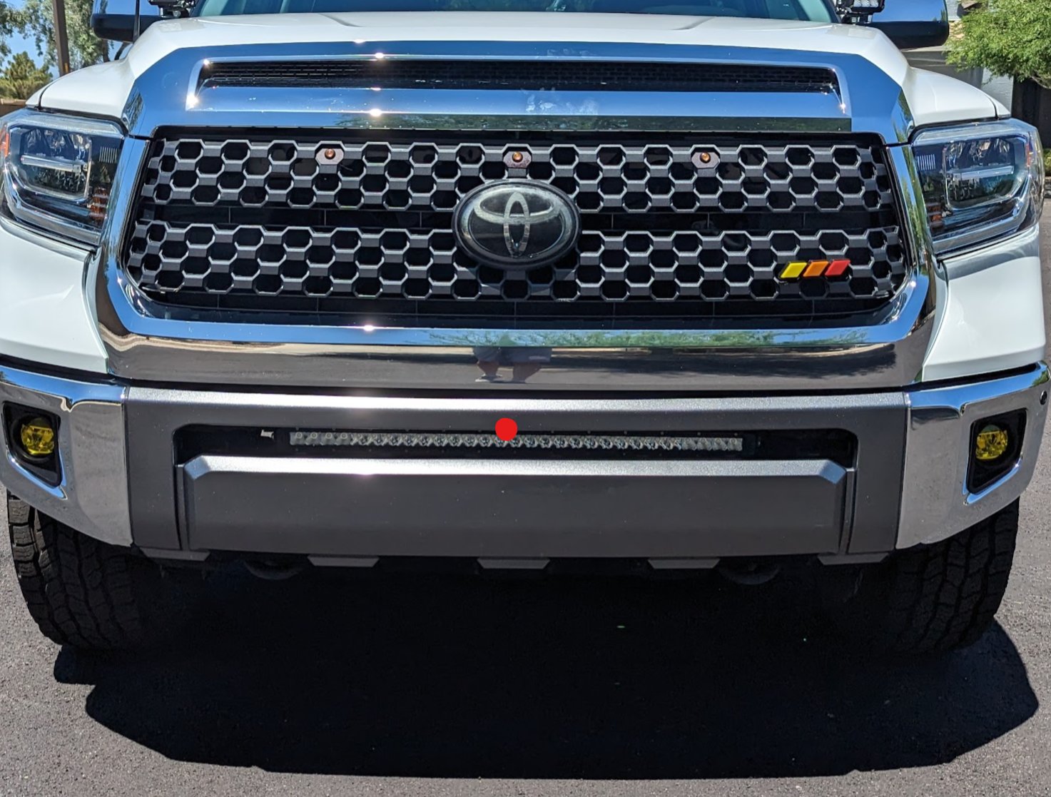

    Not getting a FRONT (2nd) camera to work.
    I've tried two aftermarket cameras, and can't get any signal on the HU. I'm using the "2nd cam input" yellow RCA from the HU directly. I can toggle between the views, but the front is black- no signal. I think I'm just wiring it wrong? someone is saying "purple wire"

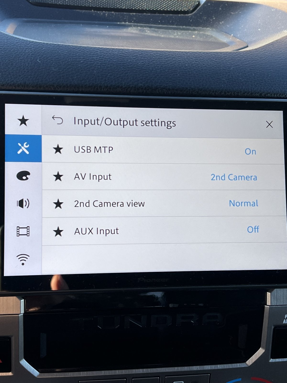

    Are your setting like this? Does you camera require power, and if so, is it powered?

    Yup those were the settings, and the camera is wired for power. I am able to flip between the cameras, but the 2nd camera is just black.
