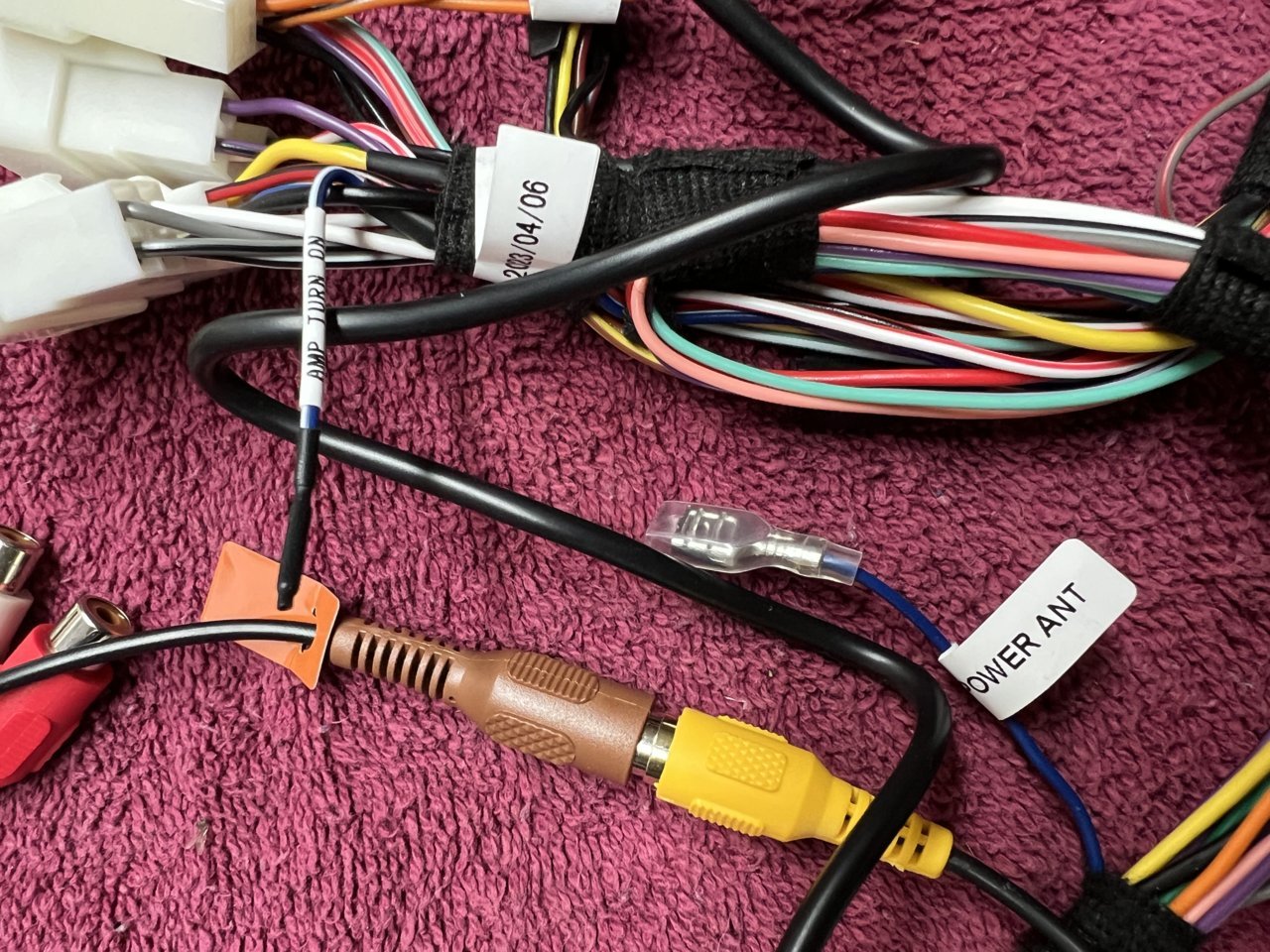

    In the middle of a 3800 install, found this post, is this the correct configuration for the OBD wires?
    What about the antenna and amp turn on, where do they go? I don’t plan on an antenna, can that be depinned?

  6. Sep 26, 2023 at 10:00 AM

    That all looks ok- but it's been while for me. I don't have the other pic, and I don't even remember that connection.

    Cool, thanks, did some more digging and I think it’s correct.
    What about the parking brake bypass, just cut the green one in the harness and connect it there? Do the antenna and amp turn on do the same thing, so I could use one for the amp and one for the bypass module?

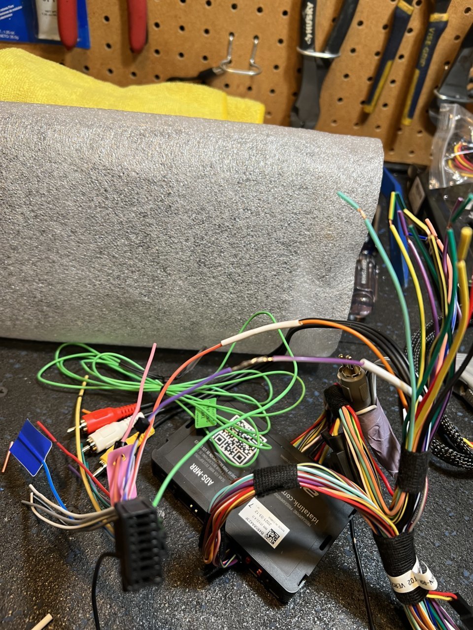

    Can anyone help me figure out my backup camera problem? Got the unit installed today. If I use the camera button on the radio, the backup camera comes on. If I put the truck in reverse, I get nothing. Any ideas?

    Did you plug into the specific cable that feeds the camera power when you're in reverse? It's usually labeled.

    I plugged the brown and yellow rc cables together that were labeled. Is there another connection?

    You need to trigger the reverse to the Pioneer...it's a purple wire.

    Damn it, I figured I’d miss one thing lol. I’ll have to pull it out when I get back home or tomorrow morning. Does it go straight into the back of the HU?

    It should be a purple wire directly on the Pioneer harness.

    Would that connect to a factory connection or is that something that connects to the TO2 harness? I hope I’m describing those right.

    I believe it connects to the TO2 harness. I'll have to find my instruction sheet to refresh my memory.

    Thanks for the help. All my stuff was pre wired from Crutchfield, so I guess I need to pull it back out and make sure I made all the connections. I really thought I did. Unless anyone has a picture of the specific connection they can share.

    This may be it. I soldered and wrapped all my connections, and then dressed the whole harness in a sheath, but I snapped this while it was all still hanging out. IMG_4612.jpg

    Thanks for the picture! I’ll pull it back out this weekend and check everything. I’ll let y’all know what I find.
