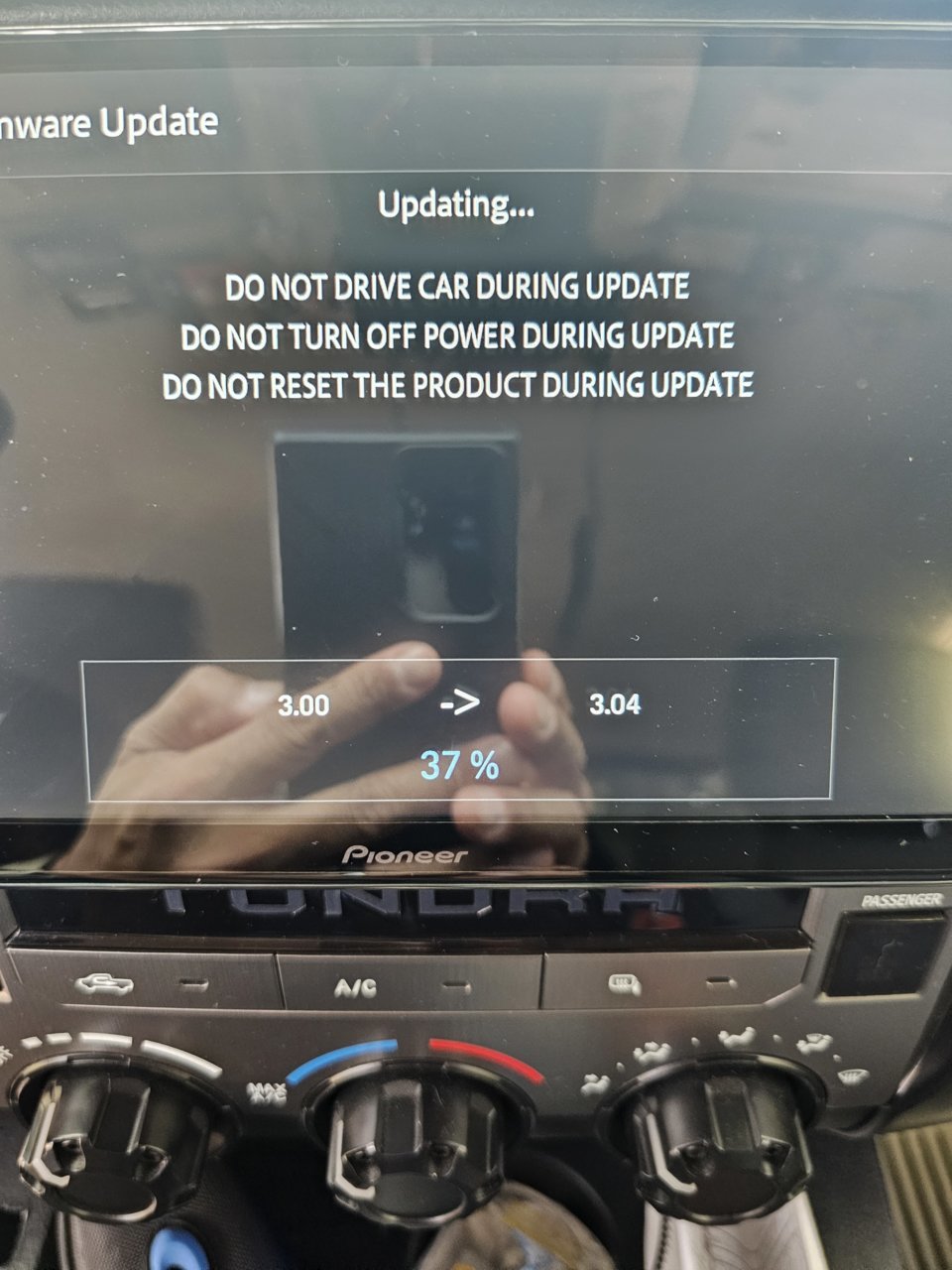

    New firmware update 3.04

  19. Jul 29, 2023 at 10:43 AM
    #469
    panicman
    panicman [OP] Everyone remain calm.
    Mar 28, 2018
    #13960
    1,890
    Eric
    2018 SR5 CM TRDoffroad MGM
    Great...
    Smooth? Or is it buggy?
  20. Jul 29, 2023 at 10:45 AM
    #470
    texasrho83
    texasrho83 Old Member
    Mar 30, 2017
    #7025
    10,901
    Charles
    Conroe TX
    2016 DC MGM 4x4
    See build link
    I had a helluva time getting my radio to take the transfer but it could've been user error

    I was thinking about checking for an update yesterday because mine did a reboot on Thursday and Friday.

    Where did you find the update? I don't see it on the Pioneer site.

    In the Car AV assist app.

    Smooth. The touchscreen is more responsive now.

    I'm registered to CarAVassist but it doesn't do anything when I hit the connect button.

    I followed this video when I updated mine.

    I got it updated. While i was sitting there idling, my lane departure turned orange and my collision avoidance indicator came on....WTF. Maybe its because I have my sunshade in.
