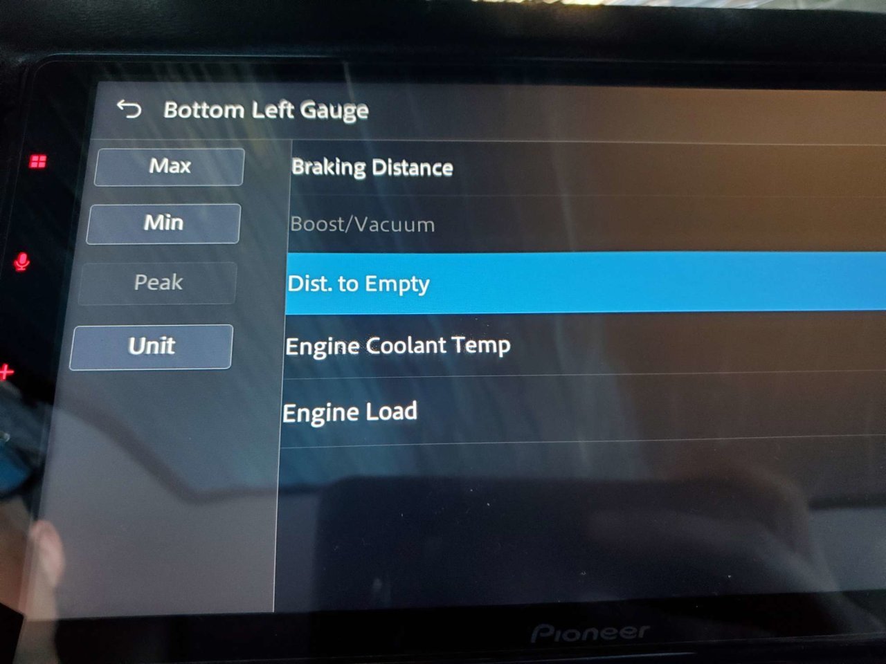

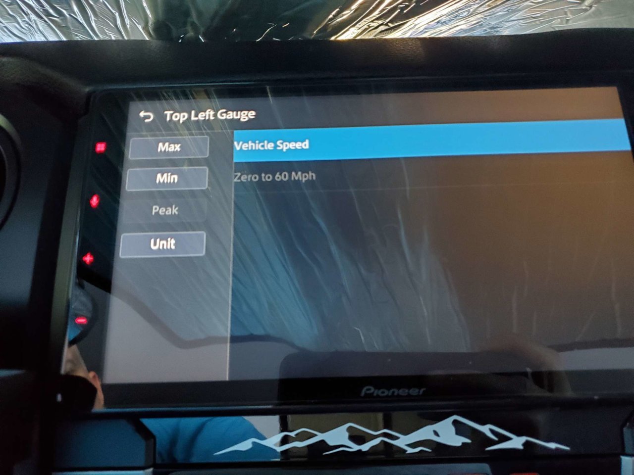

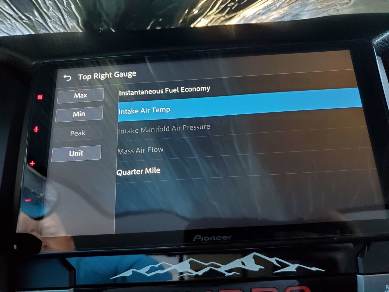

    What guages are you guys getting and how? I did the Validate PIDs but I don't get trans temp or anything like that. It appears that the only options that I have are the default guages that are in the head unit.

    Did you plug in the 2wire jumper for the rr module? I believe it was talked about somewhere in this thread

    My 2020 uses the data cable but yes, I tried the 2 wire connector that goes to the OBD plug as well.

    This is what I have. These are P1 and P2.

    I have tried all of the OBD comm setting too, but which one should it be on?

    Wow. Not a trans temp in sight. Im confused by this as well.
    Except one other idea. Are you validating pid’s with the engine running? I know my trans temp will not show up if the engine is off. (May work in key on position but i can’t remember. Definitely does not work with key in ACC position)

    Yes I tried with the engine running...still nothing.

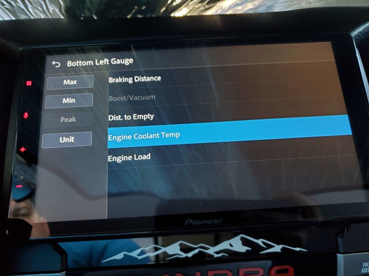

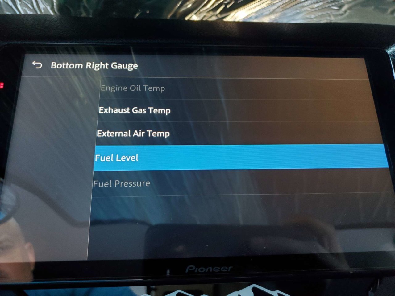

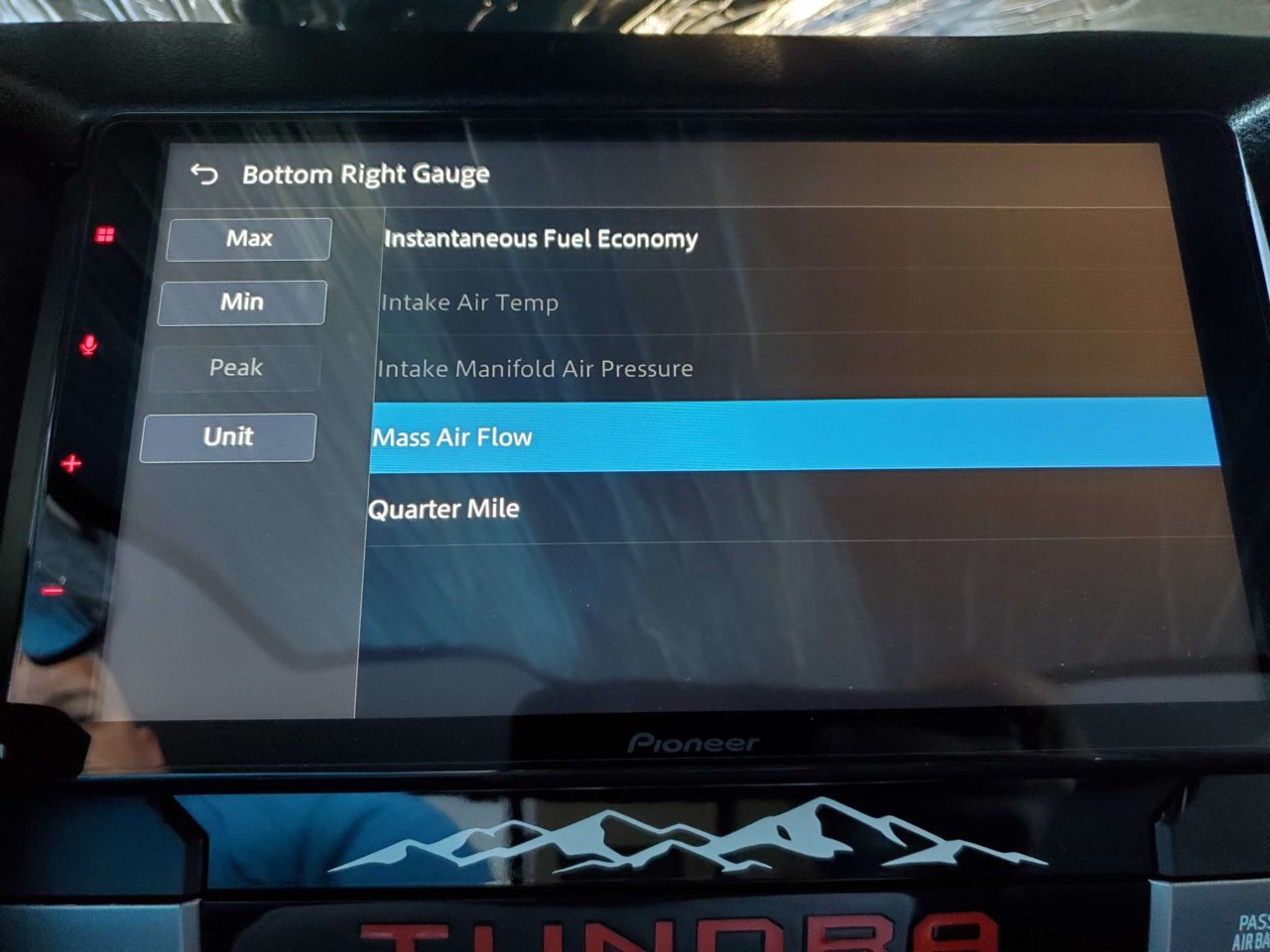

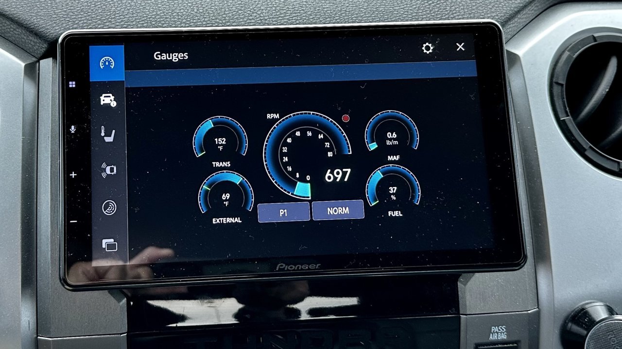

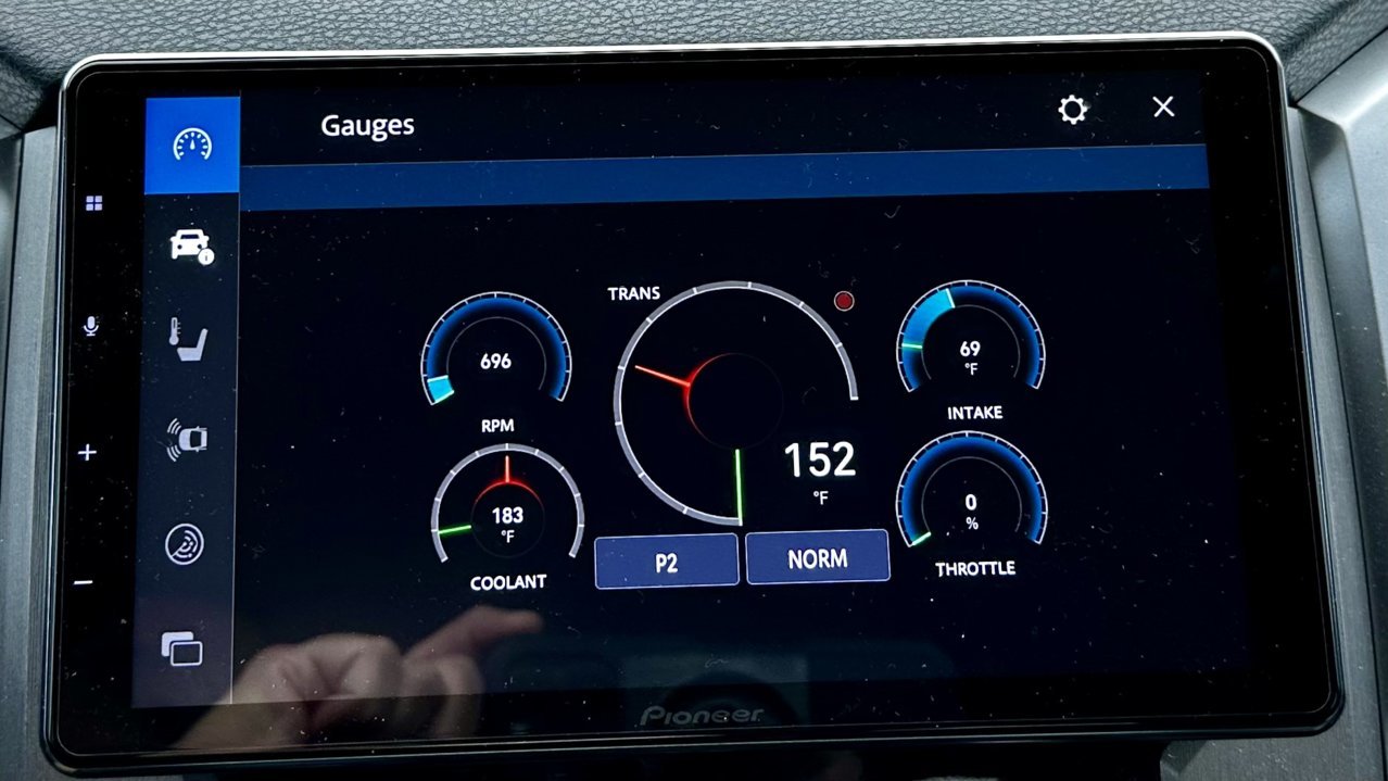

    @Tundra234 - Here’s what I’ve got. 2019 SR5. Nex7600
    9E7DD5AA-AC58-4ADB-8C94-776122BA673C.jpg E7758C5D-56D5-4C83-A787-A4DFEC719198.jpg

    How did you get them? Mine isn't pulling anything other than what I showed.

    I hate to say that I don’t know. But, I don’t know. I had them for a while. Then they went away and I couldn’t choose them. Then a couple of weeks ago they came back. I have no clue as to why. There wasnt any kind of software or firmware update.

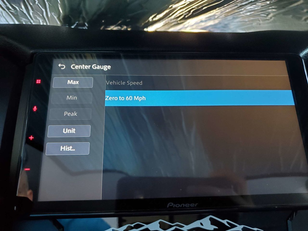

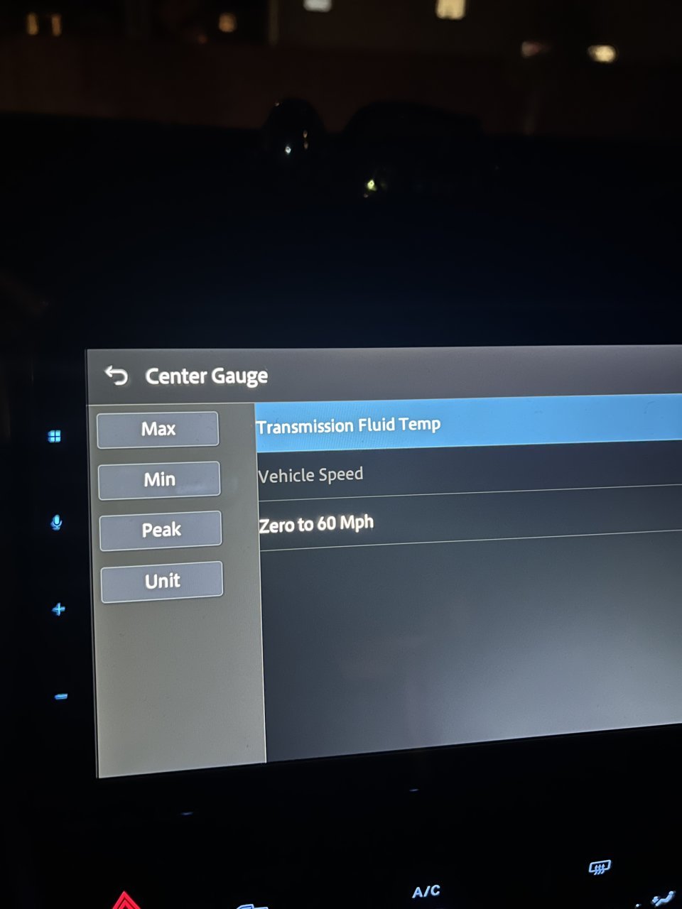

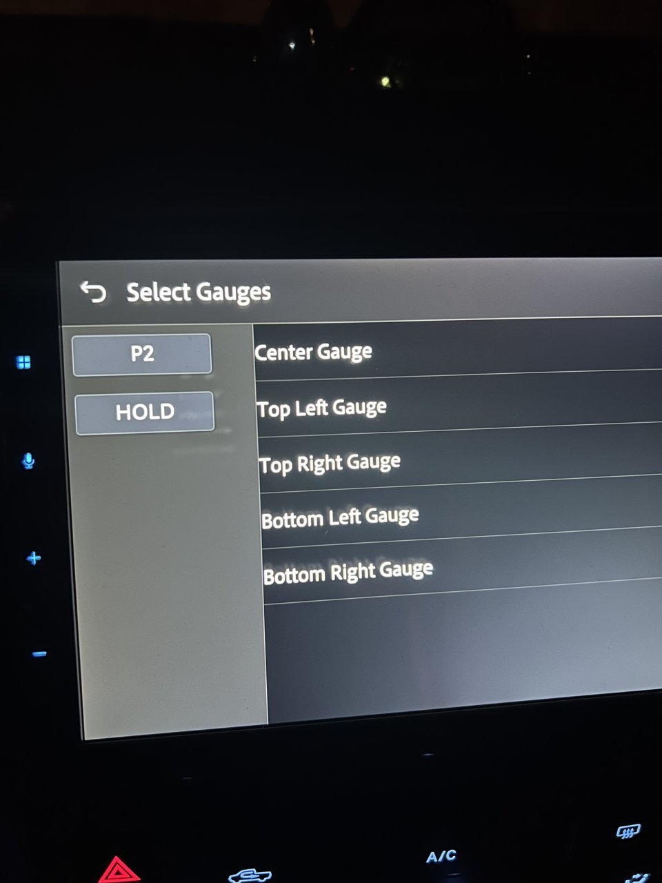

    Mine didn’t show either. I validated PIDs several times and kept hunting and they showed up, but I don’t remember what I did. I followed OGDark Knights advice and they suddenly were there. I’ll go look again.
    ok, in Car Features, I select the cog wheel for settings. Then Select Gauges. There is a menu for P1 and P2.
    When I am in P1 selection mode, I can select Center Gauge and Top Left gauge, and they display Transmission Fluid Temperature as options.
    Here, in P1:
    Then, selecting Center Gauge:

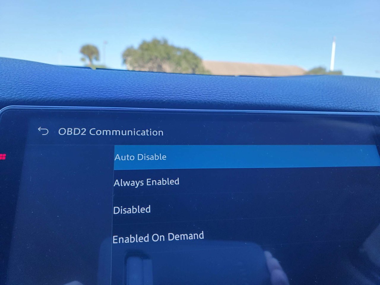

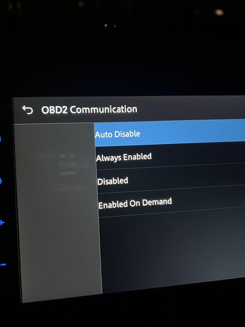

    Thanks. Can you see what your OBD setting is set on as well? I have tried everything.

    Set to Auto Disable. Is that what you’re looking for ?E101D177-05E1-48CF-B72B-7478F77CB26D.jpg

    In P2 mode, I can select trans fluid temp for the top left gauge, but no others.

    My OBD is set on Auto disable as well. I didn't use that app but I am on Firmware 3.0.
