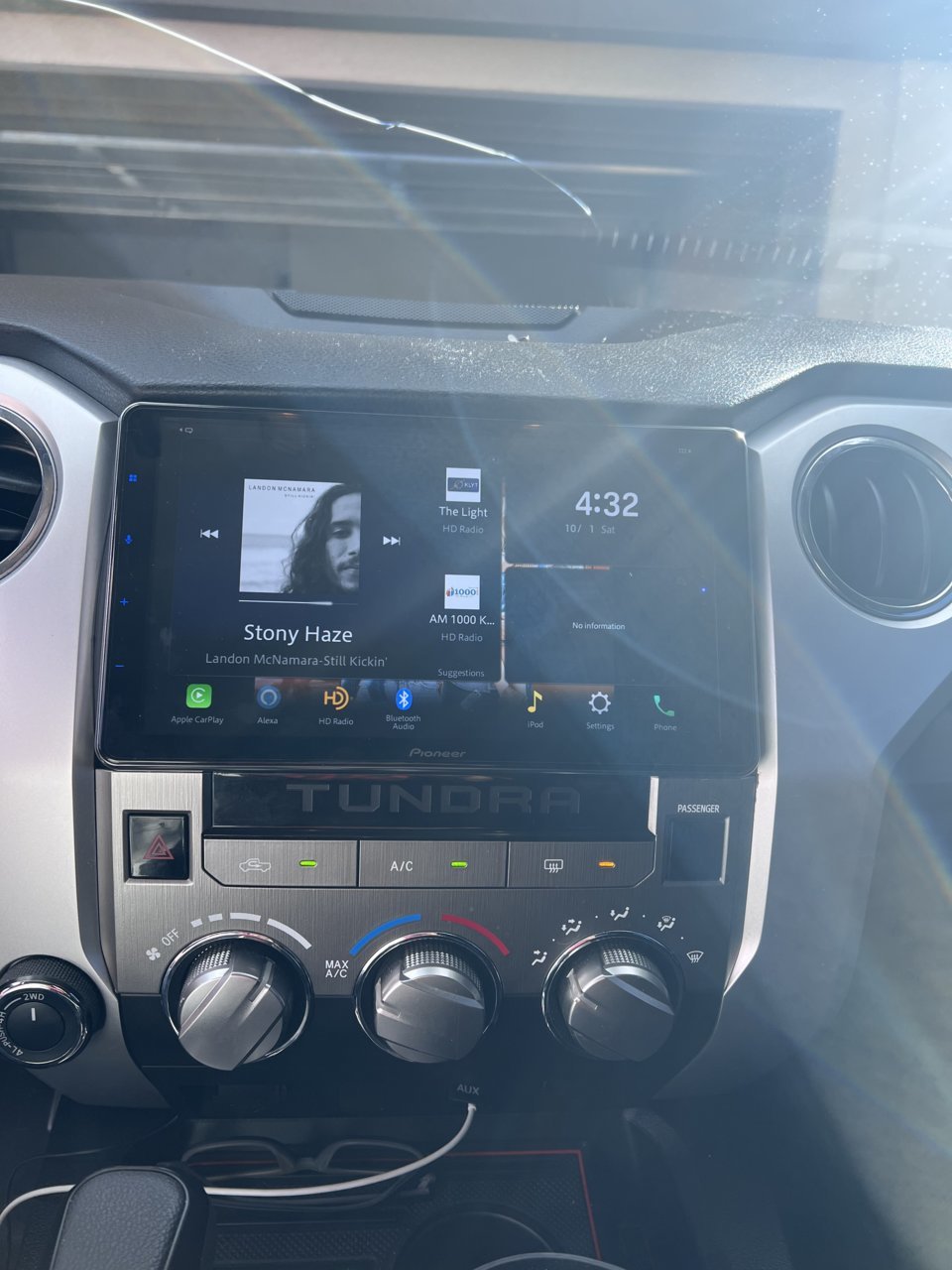

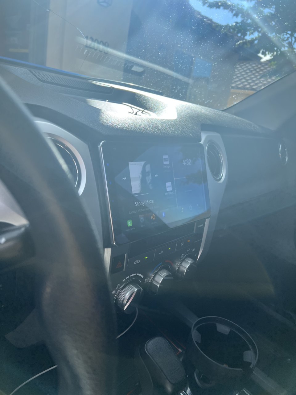

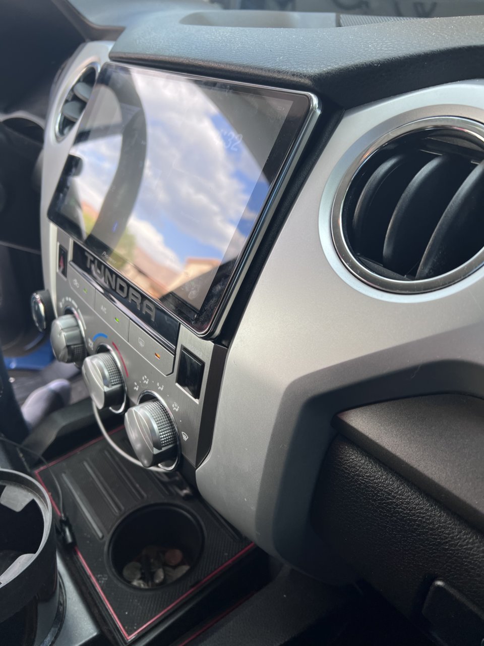

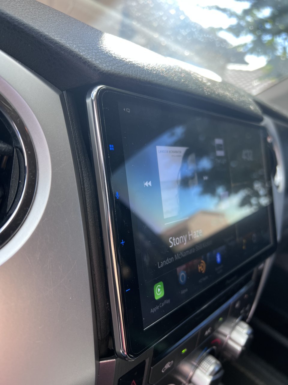

    Got mine all installed with the flush mount method. Overall, pretty happy. Still need to work the gaps on the sides of the HU, but some weather stripping seems to be a solution for now.
    If anyone has some tips on how to get the radar to work, I would appreciate the help.
    What is the long USB C cord that came with the unit for?

    It's to hook up your USB port

    That looks great!

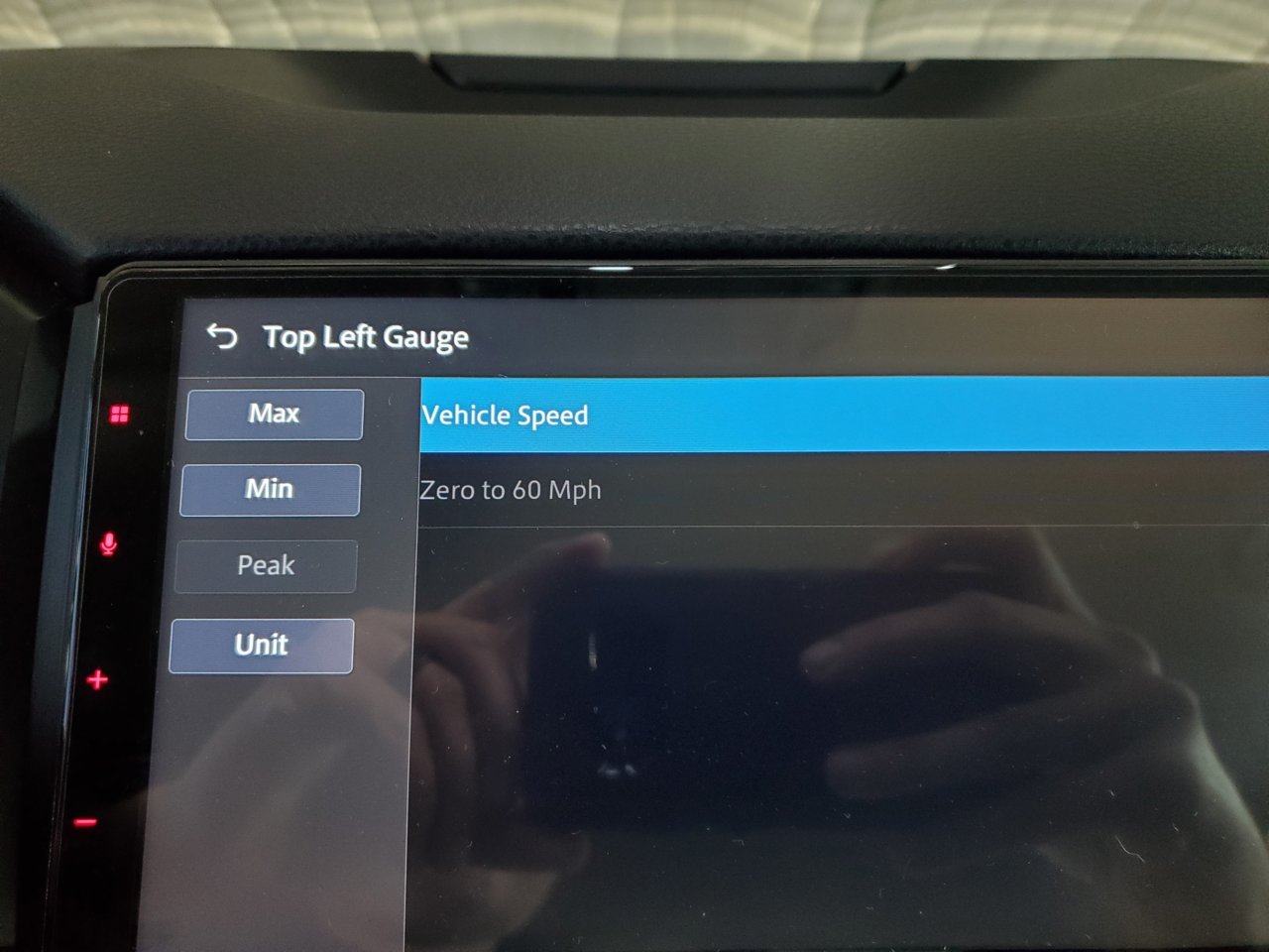

    How did you get trans temp on yours? I tried the OBD plug to see if anything is different and there isn't. Mine is a 2020 so the OBD stuff goes through the data cable so I do t need the OBD connector at all.

    Gauges》Select Gauges》pick which position you want it to be in 》here's where it gets weird: you'll click where you want it and then it'll give you a list of choices. You might see Trans temp, you might not. I clicked on the gauge position where it was then clicked on it to appear. When it does, I played around with its position to show up in the place I want it to be. Lol sorry I can't be more specific but that's how I made it happen for me

    For trans temp to be in the large center gauge you must click p1, to ensure p2 is showing. Then you will be able to set trans temp as large gauge which translates to showing as the only gauge on Home Screen if gauge options are one of your chosen views.
    see post 69 & 77 in this thread

    I don't have the trans temp for some reason. I turned the switch to ignition and validates PIDS.

    Try it running??

    Also not every PID is available in all gauge locations

    I'll try that but I'll also write down what is available for each gauge on P1 and P2.
