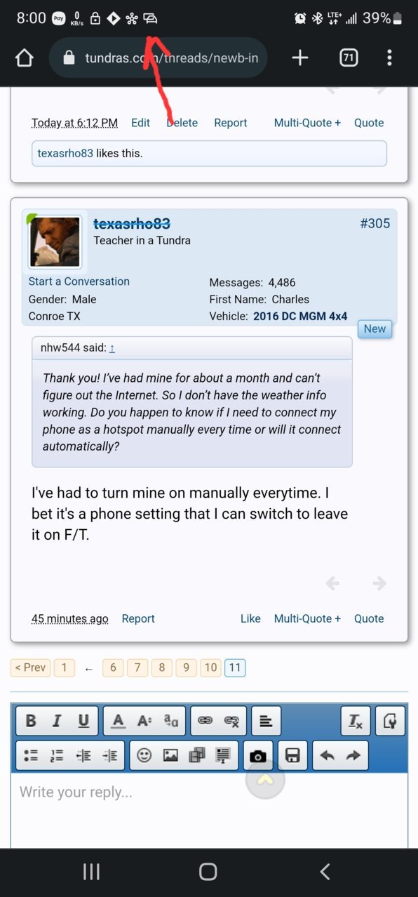

    I've had to turn mine on manually everytime. I bet it's a phone setting that I can switch to leave it on F/T.

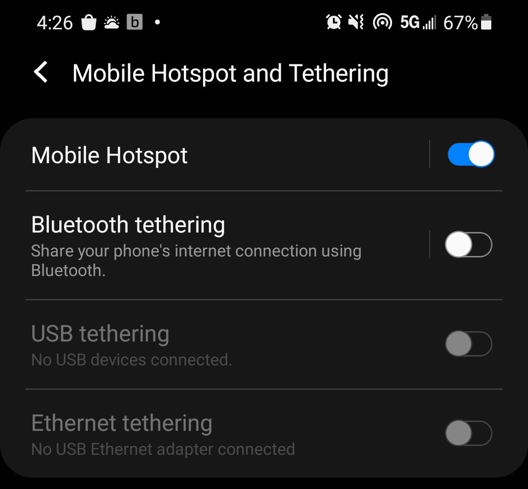

    Do you have this on in your phone? I had it set to OFF. Maybe that matters...
    Ragnarkov[QUOTED] likes this.

    Nope. My mobile hot spot is always off unless my son's iPad needs a connection in a restaurant.
    I'm going to go back out and see if I can get a consistent reaction to specific setting combinations.

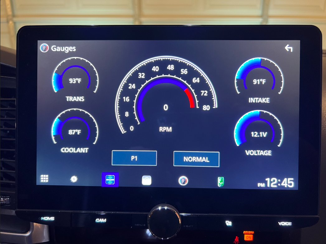

    Do you have trans temp on yours? I'm wondering if I'll get different PIDs if I use the OBD connector instead of the Maestro data cable. As a side note, I know you can get OBD fusion to display on certain radios...I'll have to find that Info again. What came of your backup camera issue?

    I do have trans temp on my home screen. It's below my sports and time widgets.
    I haven't gone back into the tailgate to fiddle with the camera again but I may get the time to do it tomorrow

    It gives a fair amount of info. Trans temp, RPM, speedo, even braking distance and 1/4 mile info lol your OBD Doctor type plug in gives way more info but I'm pleasantly surprised at what the radio shows

    I have that other stuff but I didn't see trans temp. I'll look again tomorrow. Have you messed with the OBD settings at all from the setting menu when you have the car features up? Just curious on what the setting are for...OBD disable, OBD enable, OBD auto-disable etc.

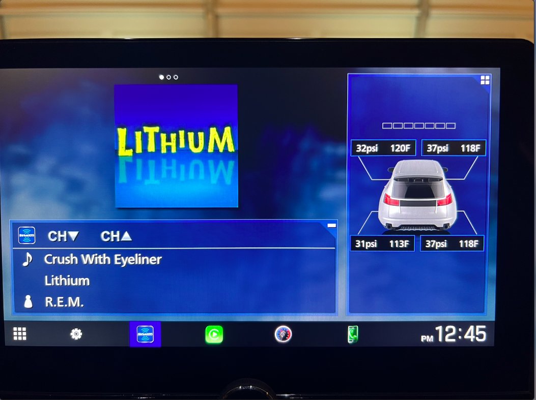

  26. Sep 18, 2022 at 10:30 AM
    #326
    BrandonL812
    BrandonL812 New Member
    Aug 5, 2018
    #17783
    1,519
    Brandon
    2021 Tundra Platinum
    DD ss3 max led fogs. interior and exterior leds swapTRD Shift knob.
    Are you able to assign or set tire location from your radio?
    I have the jvc 10” and i was able to set tire location under the system and maestro menu. You have to drive it down the block and back to wake up the tpms, then you can set each tire by following the on screen guide for each tire to let air out. The car will honk to let you know you can stop letting air out. Repeat for other 3.
    Mine was also flipped. My rears reading was on the passenger side.

    As of right now, I don't know if there's an option to do that. Seems wierd though... if it can't read the tpms properly, what is it supposed to do when you do a tire rotation? I'm tempted to swap 2 tires and see if it reads the swap, even if it doesn't correct the readings. It might be reading the trucks output, and just not aligning it correctly. So even with a rotation it will be wrong to the same degree...

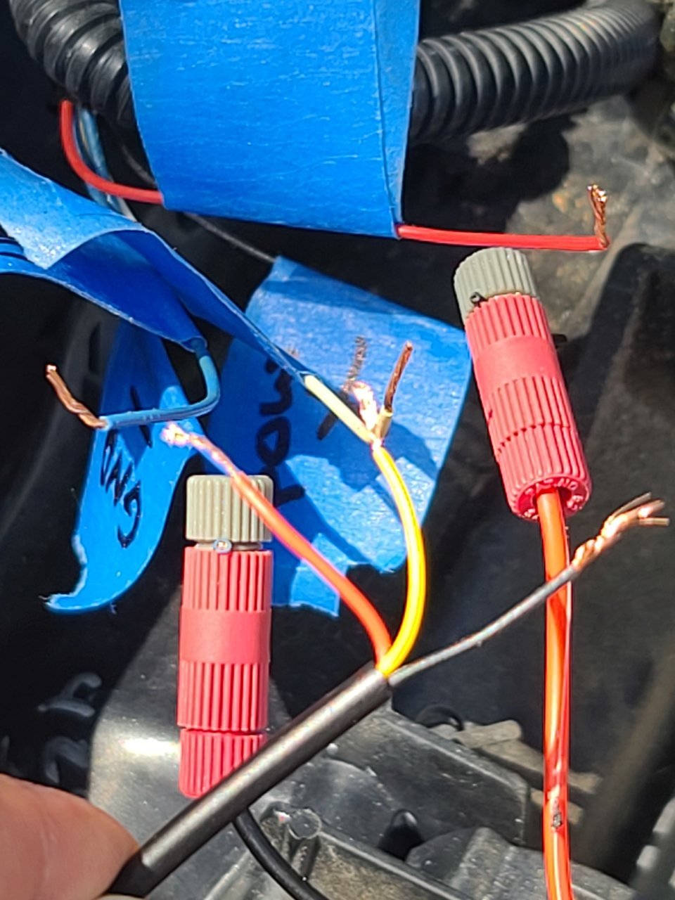

    So I've got the 2 bigger ga wires hooked up to power and ground from the OEM harness. The smaller trio of wires I figure go to CV+, CV-, and Guidelines.
    Problem is when I hooked up the reds together, the black to CV-, and the yellow to guidelines wire, I get no video feed. I've swapped grounds and hots. Still no feed.
    Any ideas?

    That seems weird it wouldnt allow you to assign tire location.
  30. Sep 18, 2022 at 12:51 PM
    #330
    e30cabrio
    Oct 20, 2017
    #10410
    6,504
    West Valley, Phoenix, Az.
    Boosted 2013 Sequoia TRD FAUX
    I put my tires to 35 rear & 30 front, the dealer yesterday said they set them to 36.
    Before I went to the dealer I had both passenger side showing 35, driver side 30 now they are 32,31 driver side and the passenger side are 37.
    I have transmission temp, like it.
    BrandonL812 likes this.
