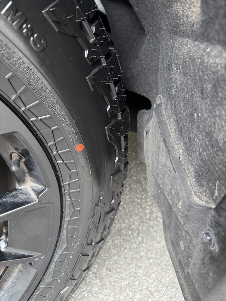

    To the best of my knowledge, you want somewhere around ~33 backspacing for max clearance.
    Coincidentally a 1" spacer puts stock OR rims in that range.
    Irrelevant for 35s likely. You may need to pin the splash guards.

    Thats what i'm trying to avoid. I know noones has put these tires in these sizes lol, i searched everywhere. Might just go with toyo at3 in 285/65/20 since they're knows to fit, and also at 56lbs they are 10lbs lighter. But I really wanted the at4s, sucks.

    TBH if you are slightly mechanically inclined I would get the at4s.
    Just double check that they aren't too wide and rub the UCA.
    35s are basically bolt on and go, they typically don't require any changes to fit them, and if they do rub at all it's so minor that you can either ignore it or trim a tiny bit/pin back.
