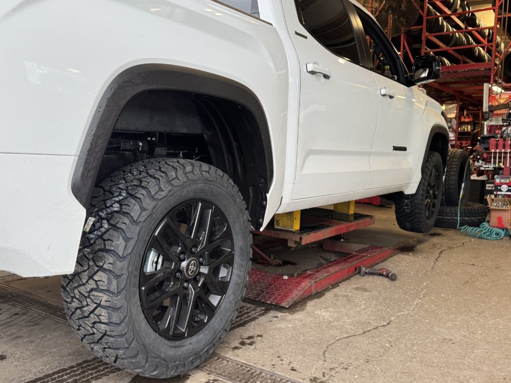

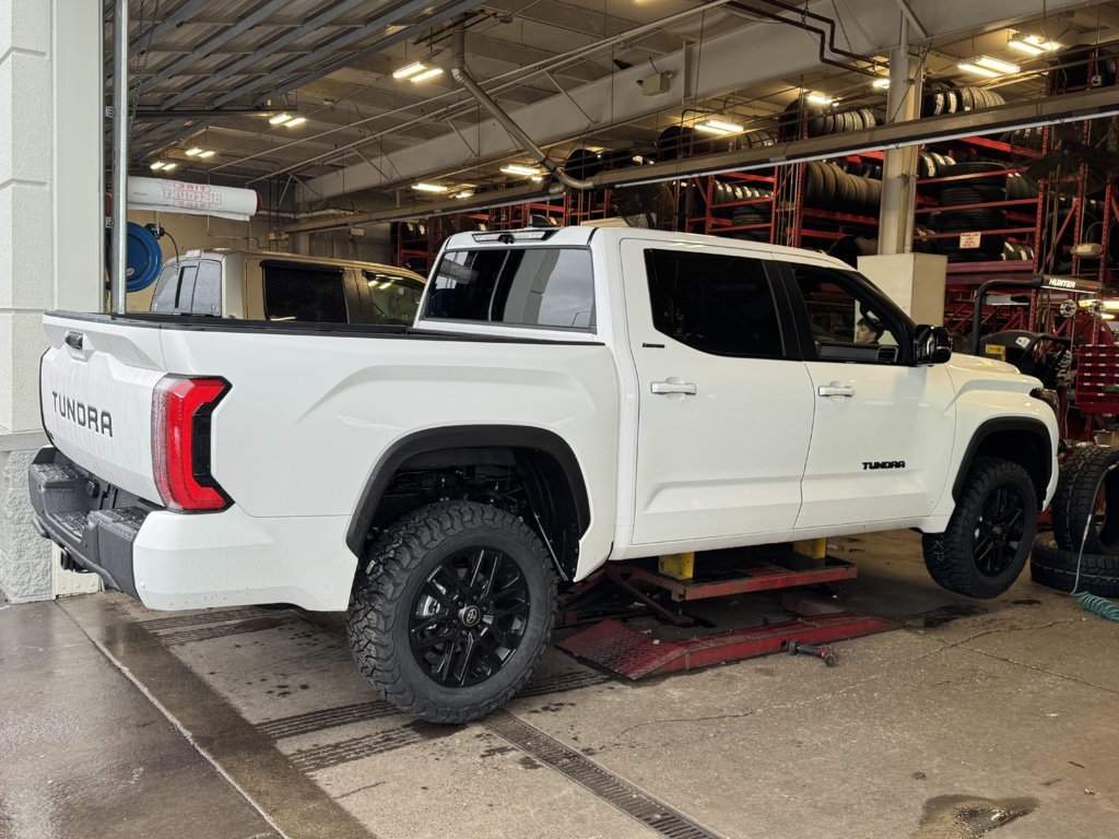

    Resurrecting this old one.
    For anyone wondering and wanting to stick with factory 20's. 285/65/20 fit with no rubbing. Went with the 285/65/20 Toyo AT3 after much debate. Liked the actual size and weight compared to the falken at4.
    Also went with the fabtech 1.5" level and some afe tow points.

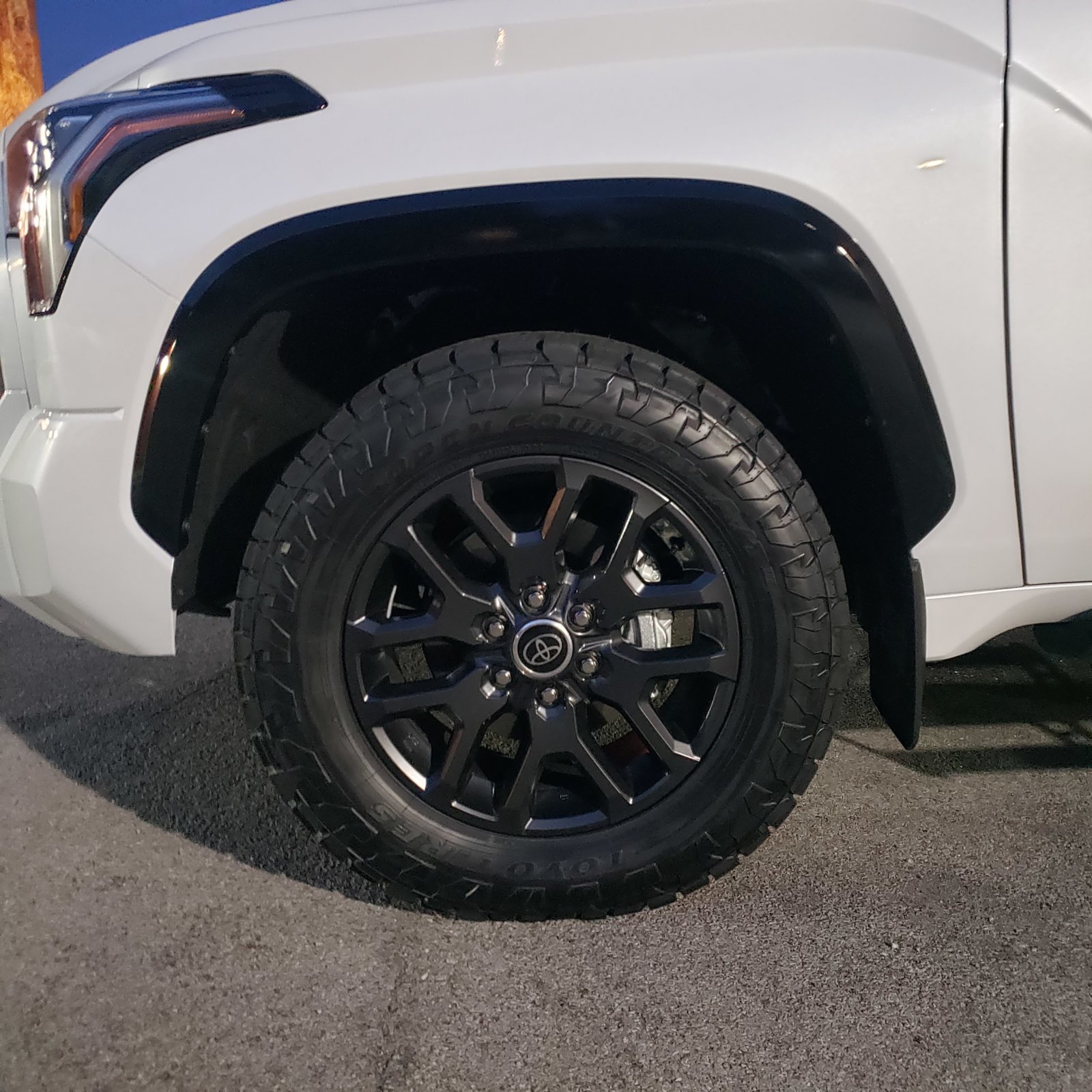

    Kept my stock wheels and went with Toyo AT3 275/65r20s. No lift or level and no rubbing. Great tires...no regrets!

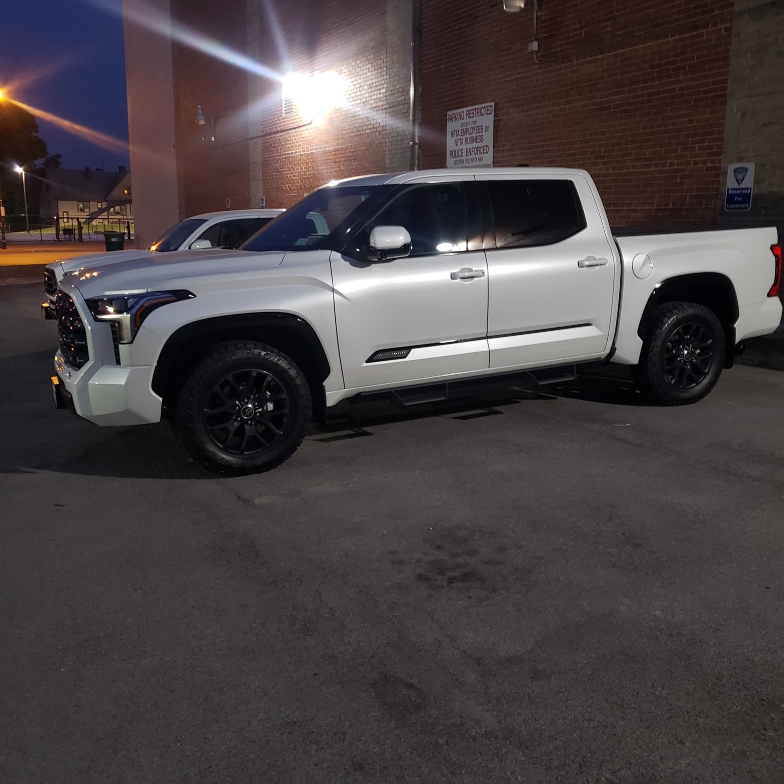

    Your truck looks wonderful. My 25 is going in for 285/65/20s and OC at3s tomorrow, along with a RC spacer lift until the factory lift debacle gets resolved.
    Very clean looking truck, well done !

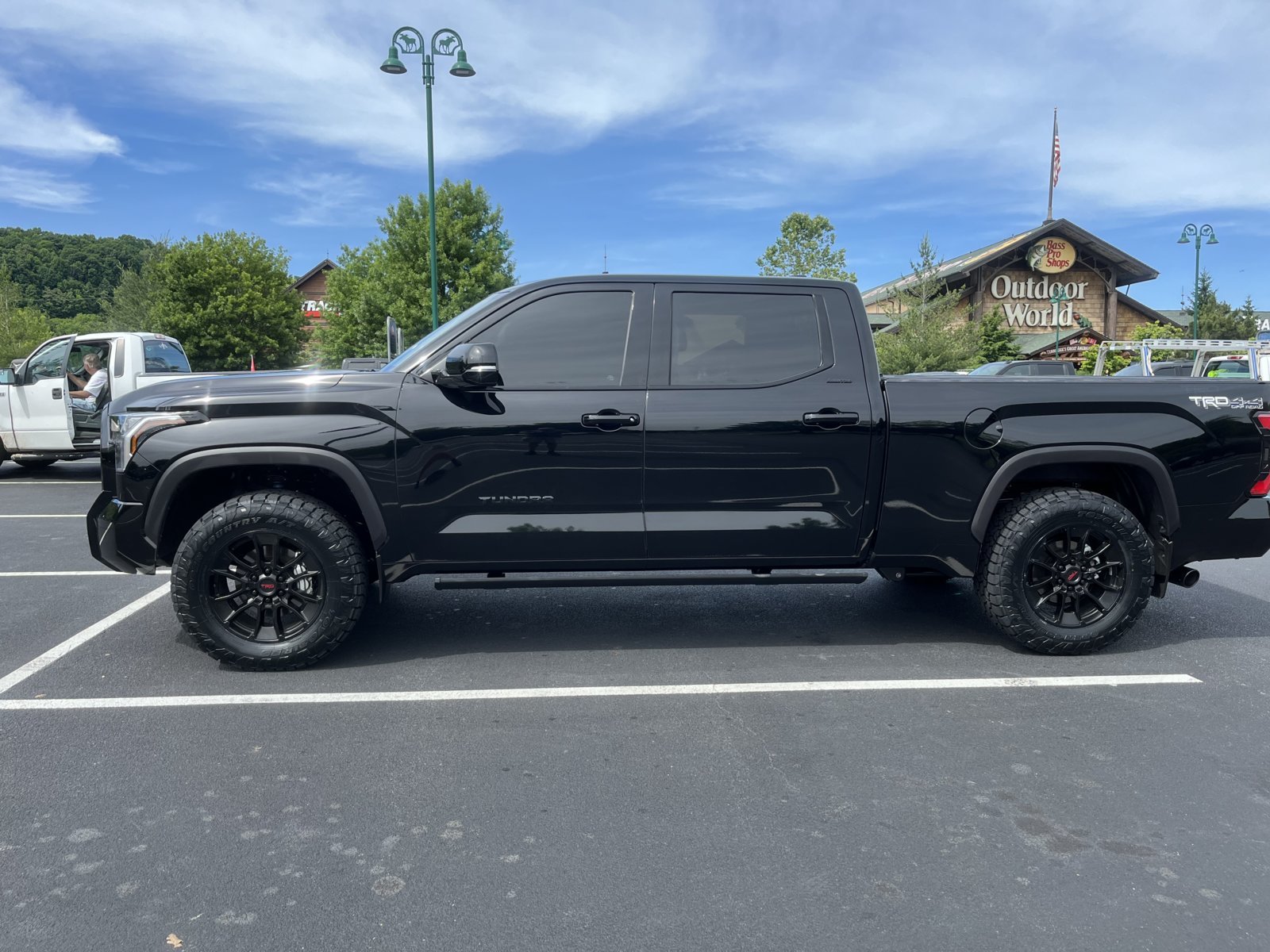

    I went with 285/60r20 BFG KO3 tires on a completely stock 2025 Limited. Love everything about this setup including looks and ride quality. Sometimes you can have it all.

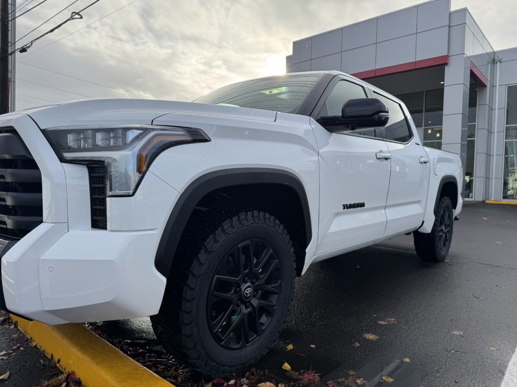

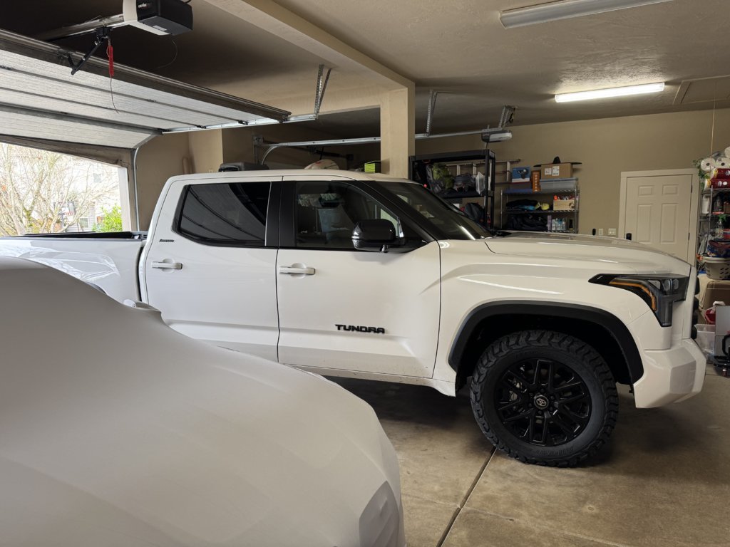

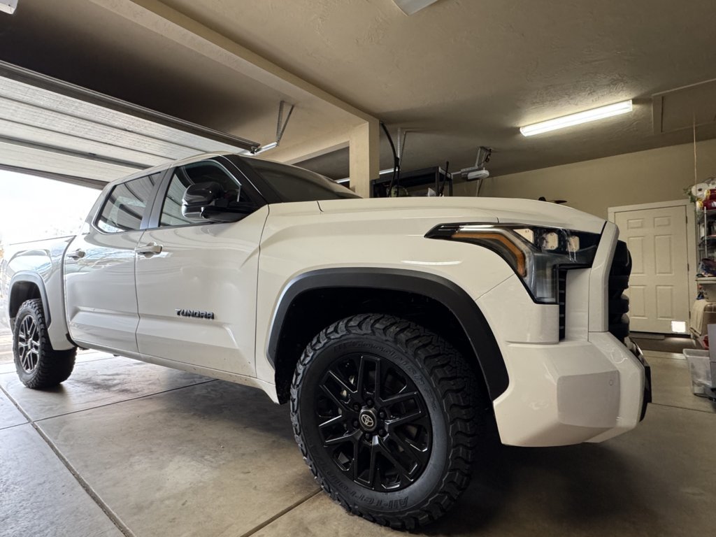

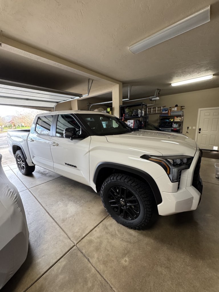

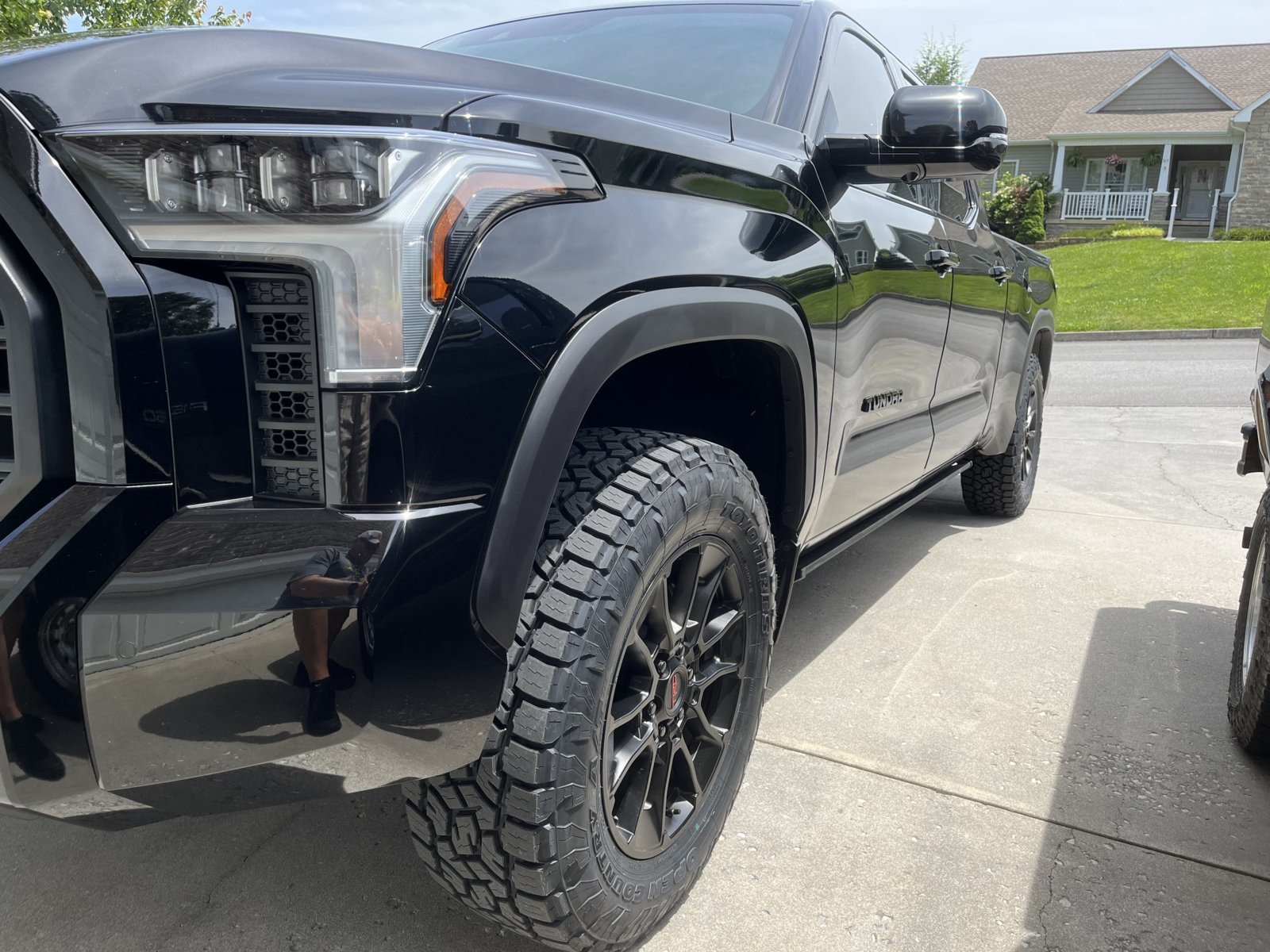

    Happy to help. My truck is ice cap white. I brought home a silver 2024 on 35s to test the garage fit. I’m sure this is what you are referring too. Photo dump below.
    As for the MPG drop I’d say 1 to 1.5 MPG but keep in mind the truck has ~500 miles on it and all of my driving so far has been in town.
