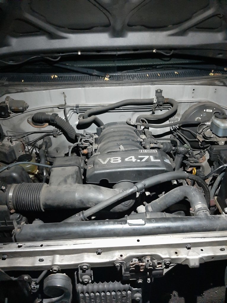

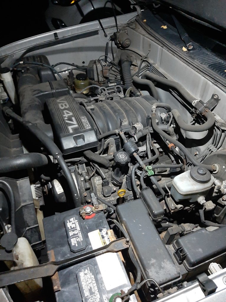

    Pics please of engine and suspension. LBJ and TB should be top of your list.

    I just noticed my rack bellow is showing a leak in the rack. Inner tie rod, I suspect. Started sometime between getting my 275s on, and recently installing the 285s. Added a few oz of 205 in there, and I need to wipe down the bellow to see if it nips it in the bud as I hope.

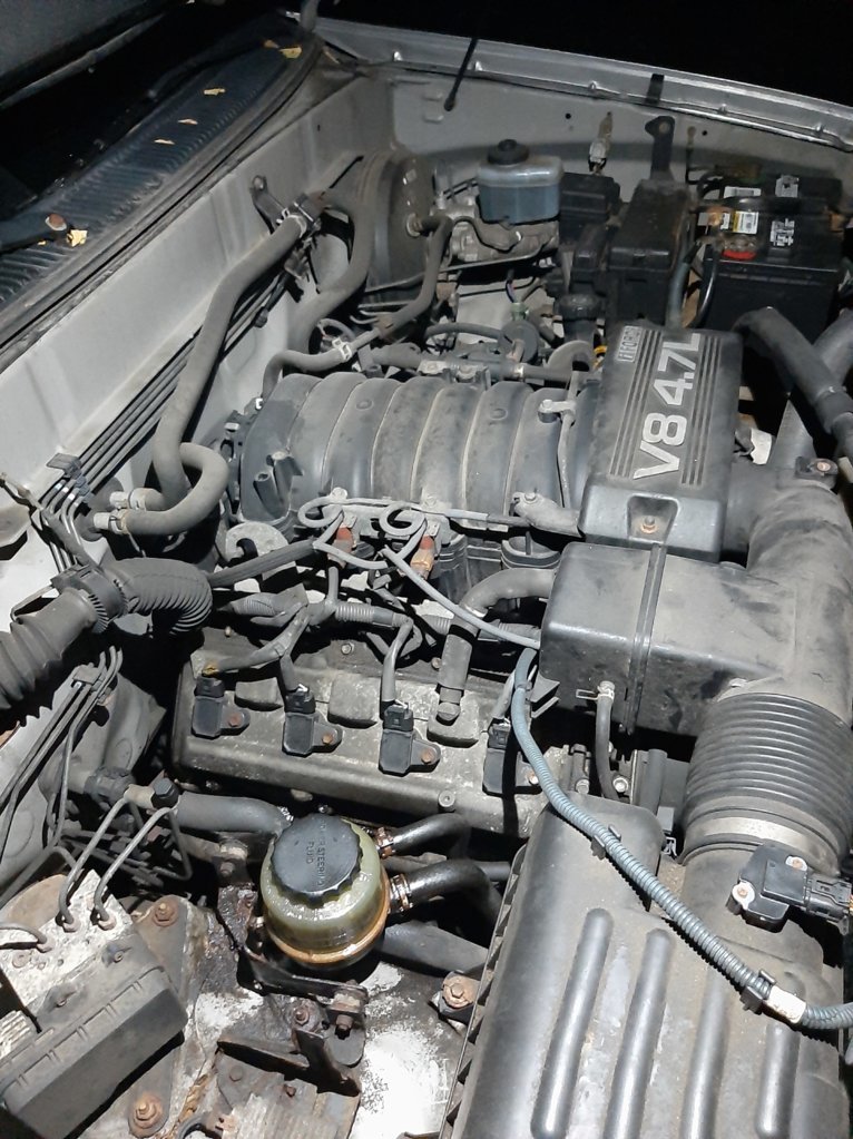

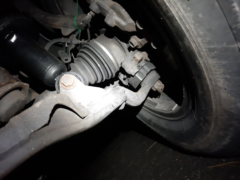

    Hey guys, thank you for the advice and the welcome!

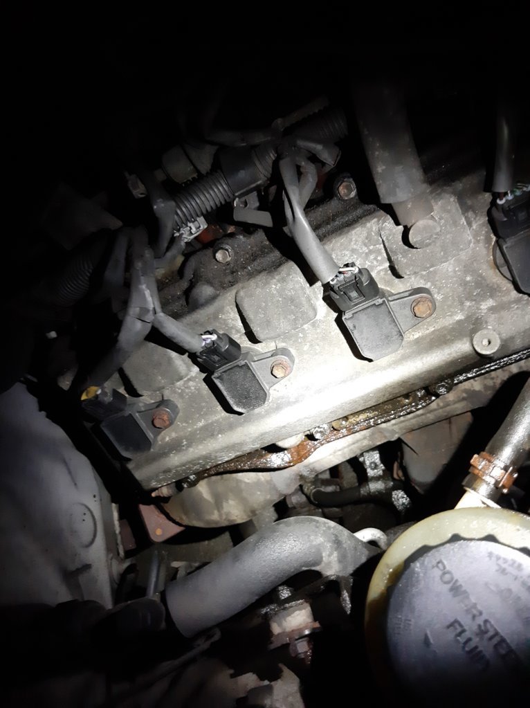

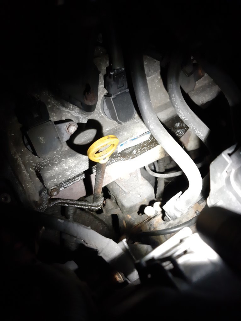

    Looks like there’s some oil leakage around the valve cover gaskets on each side. I haven’t driven it enough to get pulse for how bad it’s leaking yet, but I’m gonna replace those and the oil cooler and oil filter gaskets like jerryallday suggested.

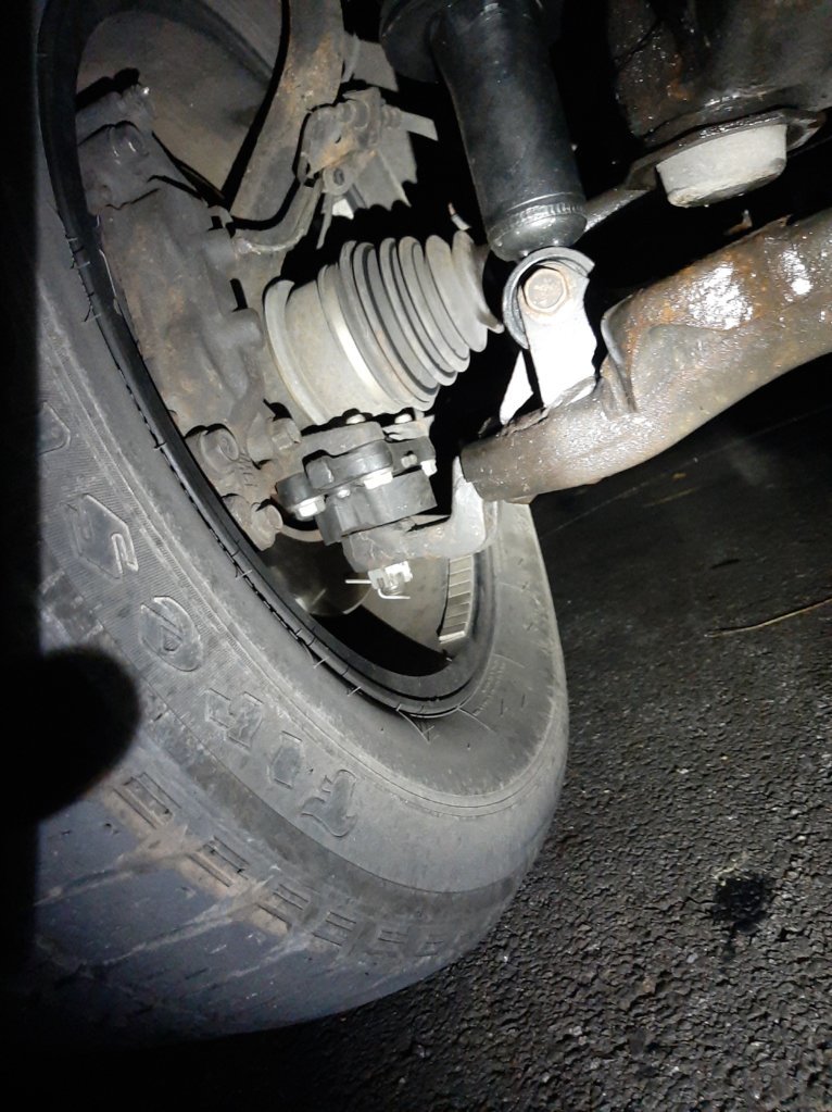

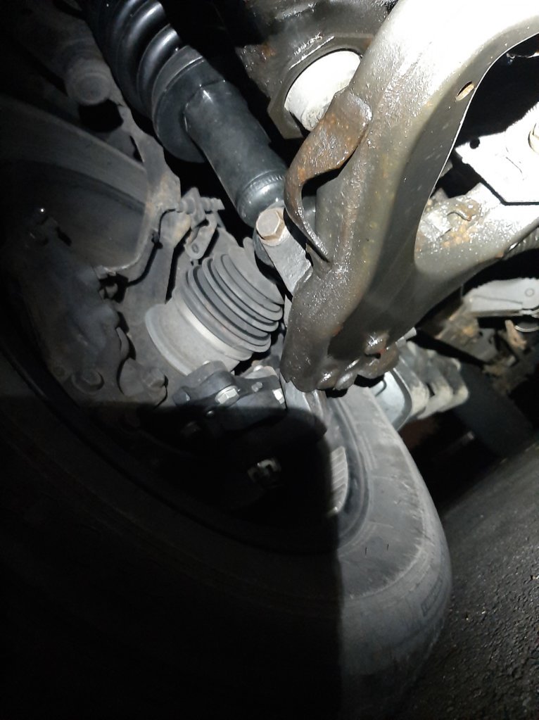

    The lower ball joints look alright as far as my untrained eye can tell. They look a little less oxidized than some of the nearby suspension components so I’m inclined to believe they were replaced at some point in the somewhat recent past, though I’m planning on replacing them with OEM LBJs and bolts just to play it safe.

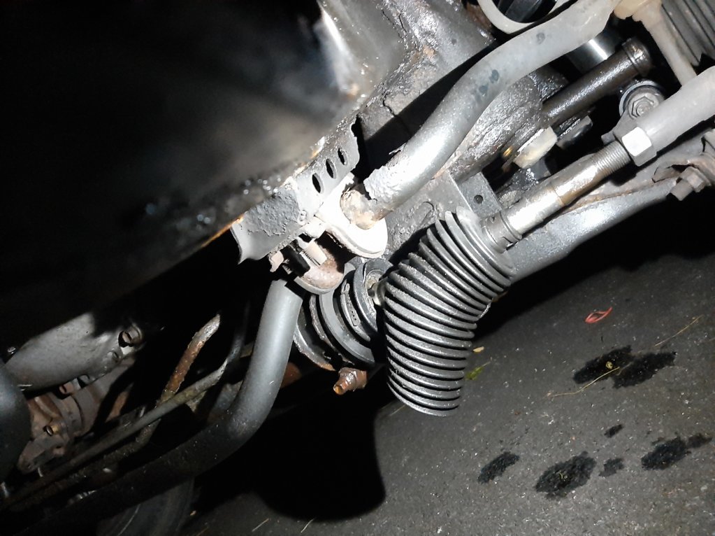

    I do have a torn rack and pinion bellow on the passenger side. Aside from a bit of a power steering whine, the power steering hasn’t proved to be problematic thus far, though I’ll certainly be keeping an eye on it. AT-205 might be the the way I tackle that while waiting for parts to come in if it seems like it worsens.
    I’m planning on ordering all the replacement parts from RockAuto other than the LBJs and bolts since I didn’t see OEMs listed there, thanks for the heads up about the RockAuto discount code!
    The brakes were one of the handful of things that were replaced just before I bought the truck. The parking brake seems to be good, I’m in the habit of engaging the parking brake any time I park and it seemed like it had appropriate tension/grip. I’ll check out the cable to make sure there’s no slack. I’ll also make a note to grease the caliper pins while I’m doing the LBJs.
    I apologize for the poor lighting in the pictures. The rain started coming down just as I was getting out there late this evening. I’ll try getting some better pictures of the suspension, and truck as a whole tomorrow. Let me know if there's any specific areas that you'd like to see.

    Definitely need a brake fluid change (dirty master cylinder fluid). Valve cover leak and steering rack boot as you already know.
    Not sure I know what that green wire going over the knuckle is all about.

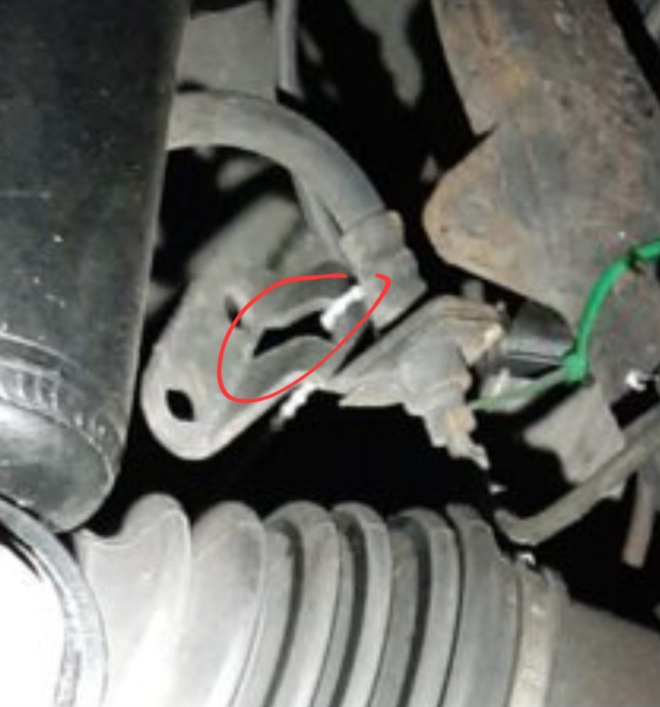

    The green "wire" is actually two zip ties. It looks as if they were intended to hold that brake line bracket on the knuckle that always breaks, but it's not holding it because you can see it flopping on the side.

    Get a stainless hose clamp on that brake line (where the green zip-ties are). I found a way to run it through the slot in the original bracket so there was no rub on any of the line.
    I'll 2nd the AT205 stop leak, works like a champ. I found that some of my valve cover bolts were loose though (common problem I think?). Don't smokum to Alabama though (over tighten).
    I would get that rack boot zip tied up temporarily until you get new ones.
    One LBJ looks new, but for sure neither one is OEM. Oem do not come with grease zerks. At least mine didn't and I haven't seen any that have.

    X2 on getting that brake line secured. Mine ruptured the brake line and I lost all pressure because of that.

    Passenger LBJ has been replaced, very recently in fact, hopefully not catastrophically, and it was replaced with new hardware which is nice to see; driver is potentially original. I'd change driver, at least, with OEM only. 100k-125k is your LBJ lifespan **IF AND ONLY IF** you used OEM parts. Aftermarket parts, you're looking at 1/2 - 1/3 the lifespan due to inferior part quality.
    Get that bellows replaced.
    You clearly have valve cover gasket leak, check to see if the bolts are at-least hand tight, i.e. take a deep well socket and try to turn each bolt using only the socket. The valve cover isn't supposed to have much more pressure than that, and the fasteners will snap on you. All the valve cover info you need to overhaul is here, reply #18: https://www.tundras.com/threads/valve-covers-fix-or-leave.105385/#post-2712883
    You can use a good degreaser like Griot's Engine Cleaner to clean up the oil residue everywhere either now or after VC gasket replace, use a decent bottle brush/wheel brush, being careful not to snag any electronics, take a blower to things after, or let it sit for 1-2 hours to dry after, before you reattach battery cable. Always remove your negative battery cable before spraying any liquids in the engine bay. Remember to drop the skid plate, and use a good degreaser on that, Simple Green is great, it's just not necessarily alloy-safe, so I don't use it on anything except steel.
    You may have cam seal leaks, which is why I'm telling you to clean and wipe up the oil.

    • get that bellows replaced; buy OEM part, I can get you the #, you'll also need a new oetiker clamp to replace bellow, work isn't that bad

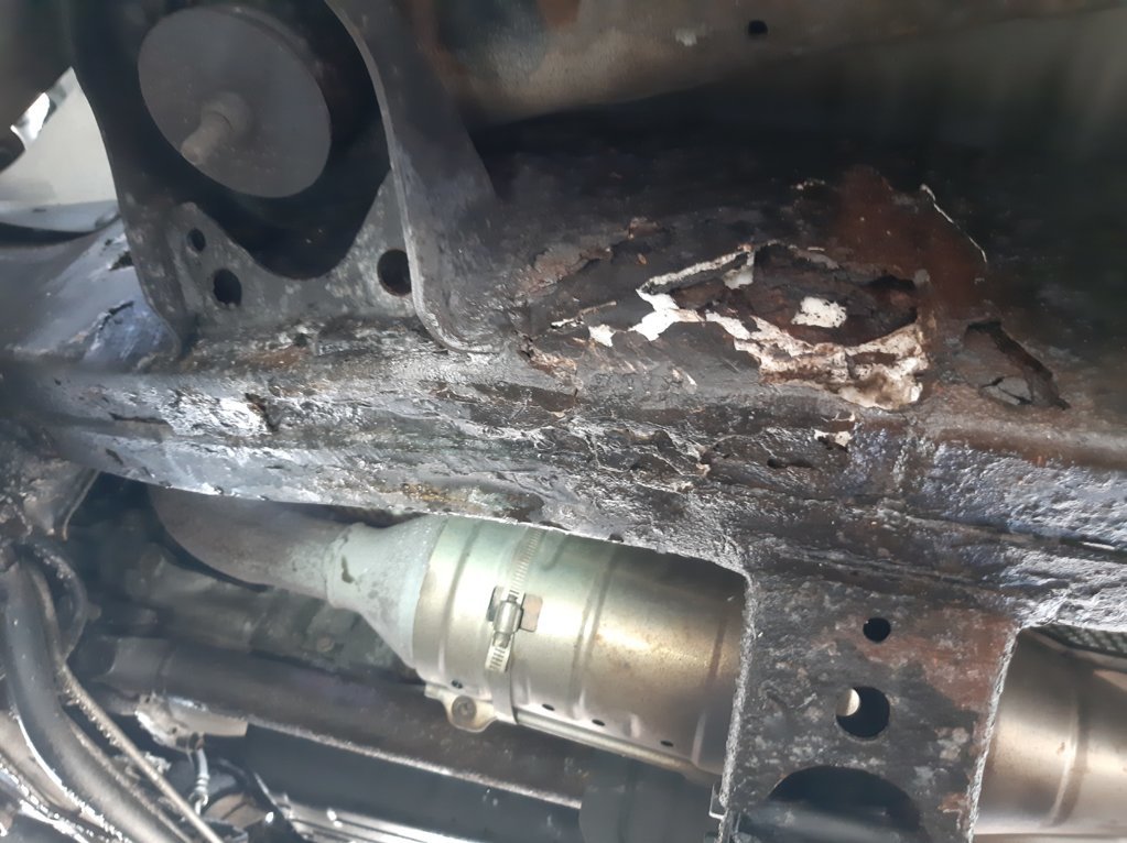

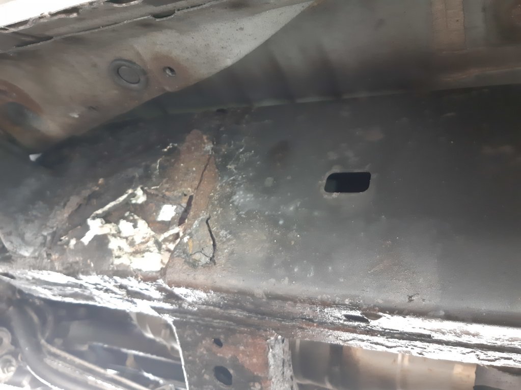

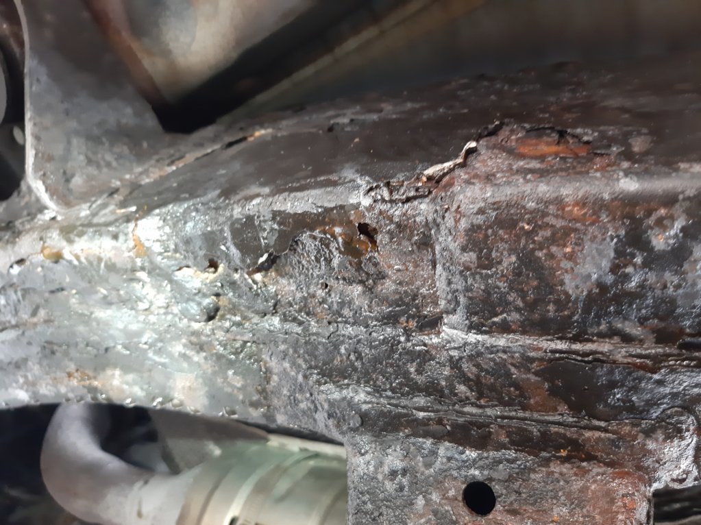

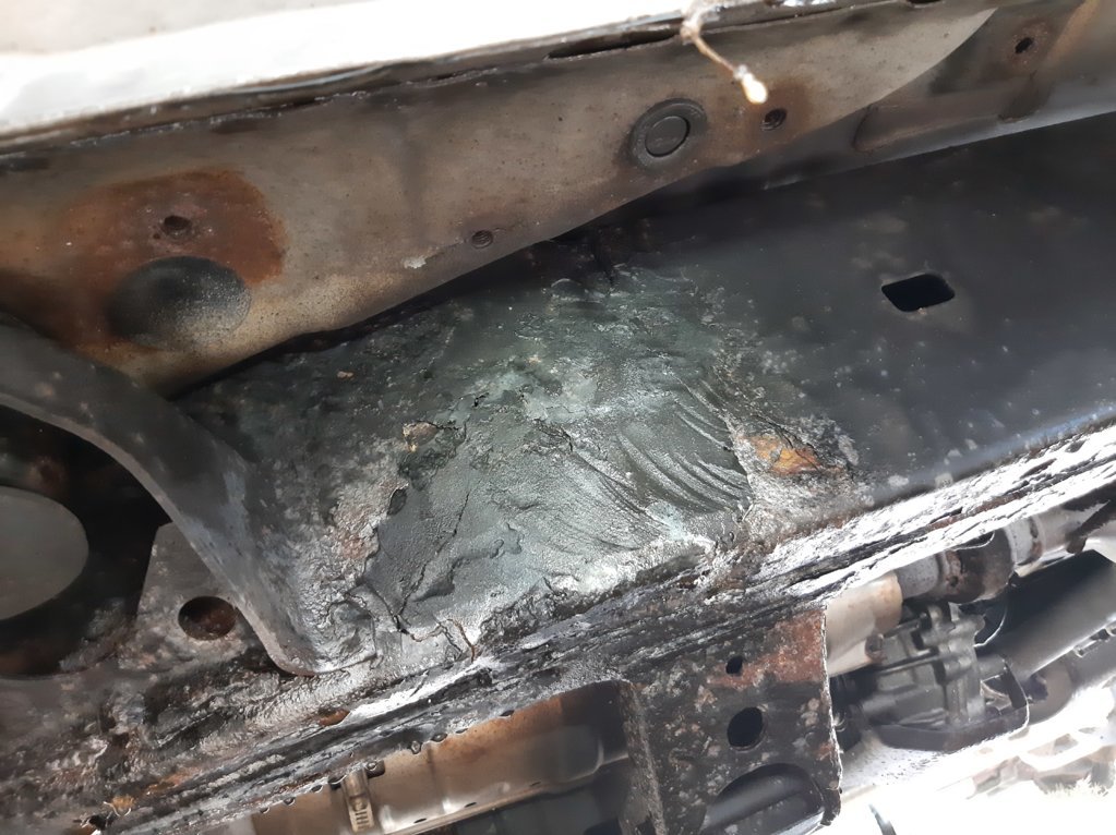

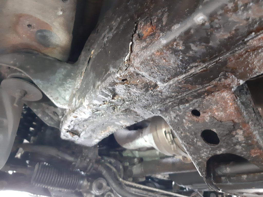

    Well, bad news guys.. The parts finally arrived, and I was planning on putting everything in this weekend.
    I was planning on doing fluid changes on the differentials, the transfer case, and greasing the driveshaft first since it didn’t require the level of disassembly that the timing belt and water pump would. While I was rolling around under the truck on a creeper I started inspecting a few rusty areas a little bit more closely.

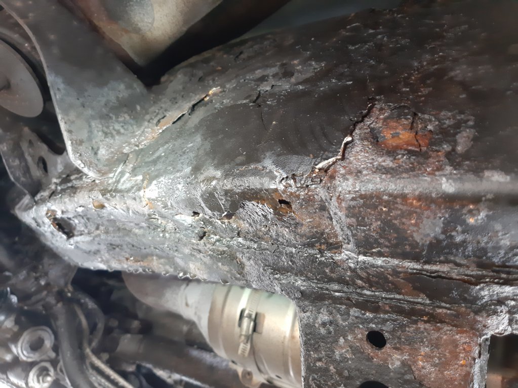

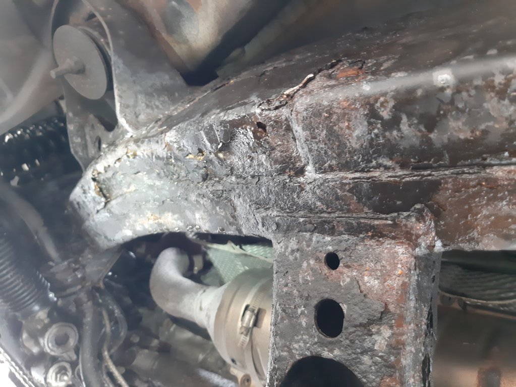

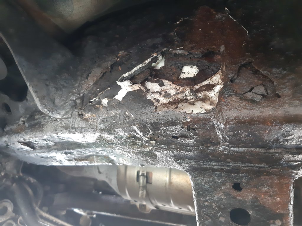

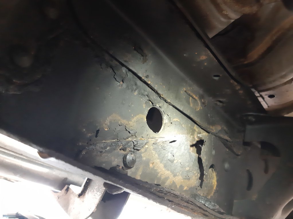

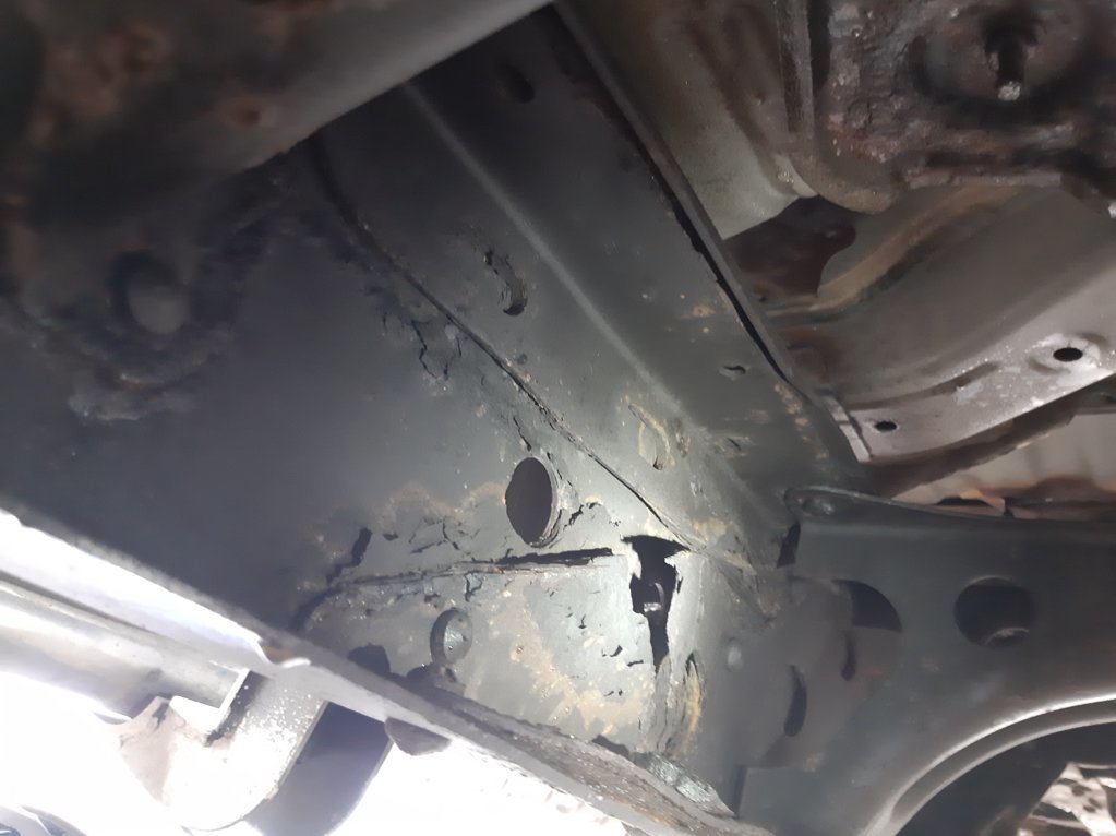

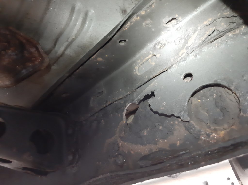

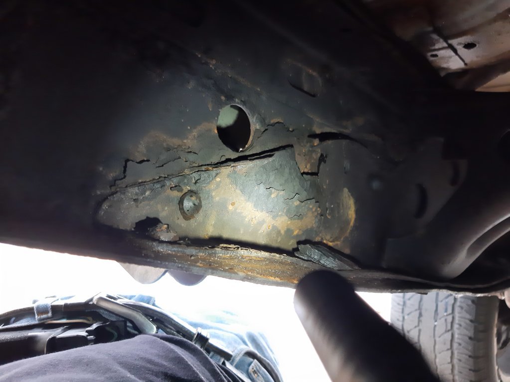

    Most of the frame is in good condition, but looking at it from underneath, it looks like there’s a previous attempt at a frame repair pinned in place on one of the passenger-side side rails.

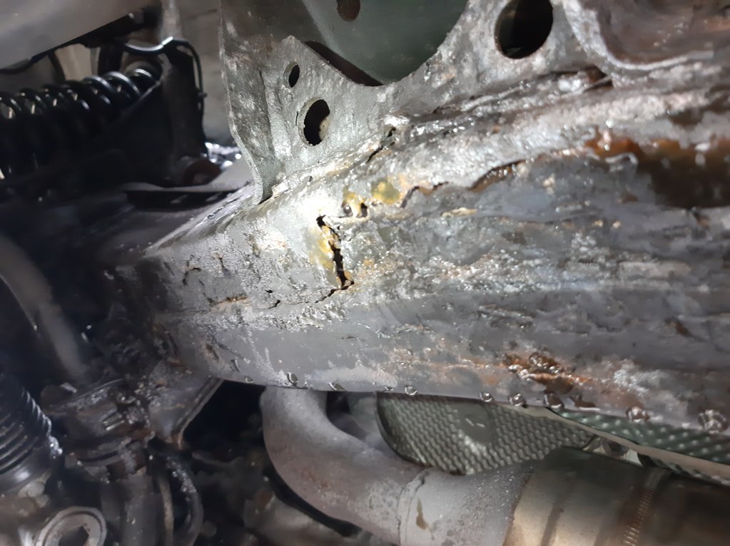

    More concerning is the section of the frame just in front of the driver’s side cab mount. After spraying the truck down with some water I noticed the large smear of dried bondo. After smacking it with a ratchet a few times I saw that what is left of that section of the frame appears to have expanding foam sprayed into it that the bondo outer layer is adhered to.
    Needless to say, I am incredibly disappointed, and am kicking myself for not having seen that disguised section of filler on the frame before I bought it.
    It was an ‘as-is’ sale from the dealer, so I fear that I’m SOL on this one. I happened to see another thread on here for a very similar situation where they argued with the dealer and the dealer took the truck back, using the basis of the truck having a recent inspection. Perhaps that would be applicable in this instance. The truck was sold with an inspection that is valid until 04/25. That level of frame damage and corrosion couldn’t have just happened in the past 9 months, right? Surely the inspection shop had to have seen that.
    I’m also searching and reading around about the feasibility of having the frame patched or repaired, but my concern is that this route would be out of the budget anyway..
    Fortunately, all the parts and fluids are still sealed and in their packaging, so depending on how this mess ultimately pans out, returning them will likely still be an option.
    If you guys have any thoughts or experience on this, please feel free to share. Looks like I paid the stupid tax on this one.

    I’d look into it legal-wise. As-is is typically under the assumption that the selling party wasn’t trying to hide something. Here they obviously did, so you may have legal recourse.

    This. Clearly you got fucked, and burned, this is EXACTLY why THIS THREAD stresses so seriously and repeatedly (to the point of dead horse beating) that you inspect the frame. You're one of half dozen or more we see per year who get boned by shady dealers/sellers.
    Clearly that was a cover-up job. Typical advice I see is to contact your state Consumer Protection Division. Dealerships can't sell you a vehicle like this with clear problems, then get away with it because they force you to sign an as-is. Knowingly selling a defective vehicle is a crime in many states.
    You should be pissed. I'd be pissed. It's up to you whether you want to go straight back to the dealer and point out the frame hackery, and let them know you're going to the CPD, but I'd probably contact the CPD and ask them what to do in this case, "Are there any protections for me, as a consumer, if a dealership sells me a used vehicle and they covered up extensive frame rot, the the point the frame could snap over any bump?"

    Did you buy from dealer or private party. Probably also criminal act as well as civil. Call the police, BBB and state Consumer protection. If a business a little public attention might be indicated. Keep us posted. Might be worth talking to an attorney.

    Bondo on the frame? Jeez

    I ended up returning the truck and getting most of my money back. After fighting back and forth with the dealer (who has been nothing short of a real piece of work…) he agreed to take the truck back for $3,250, which is a bit less than the $4k that I originally payed, but I’m just glad to be done with the dealer, the truck, and the situation.
    The dealer allegedly took the truck to a frame repair shop and had the rotted section of the frame welded, without me authorizing the work. I took some pictures of the ‘repair’ to show you guys. I’m not a welder, but to my untrained eye, the top of the patch plate just looks crappily tack welded in place. With as shady as the rest of this guy’s operation has been, I wouldn’t be surprised if the ‘repair shop’ is just his cousin with a $100 harbor freight welder.
