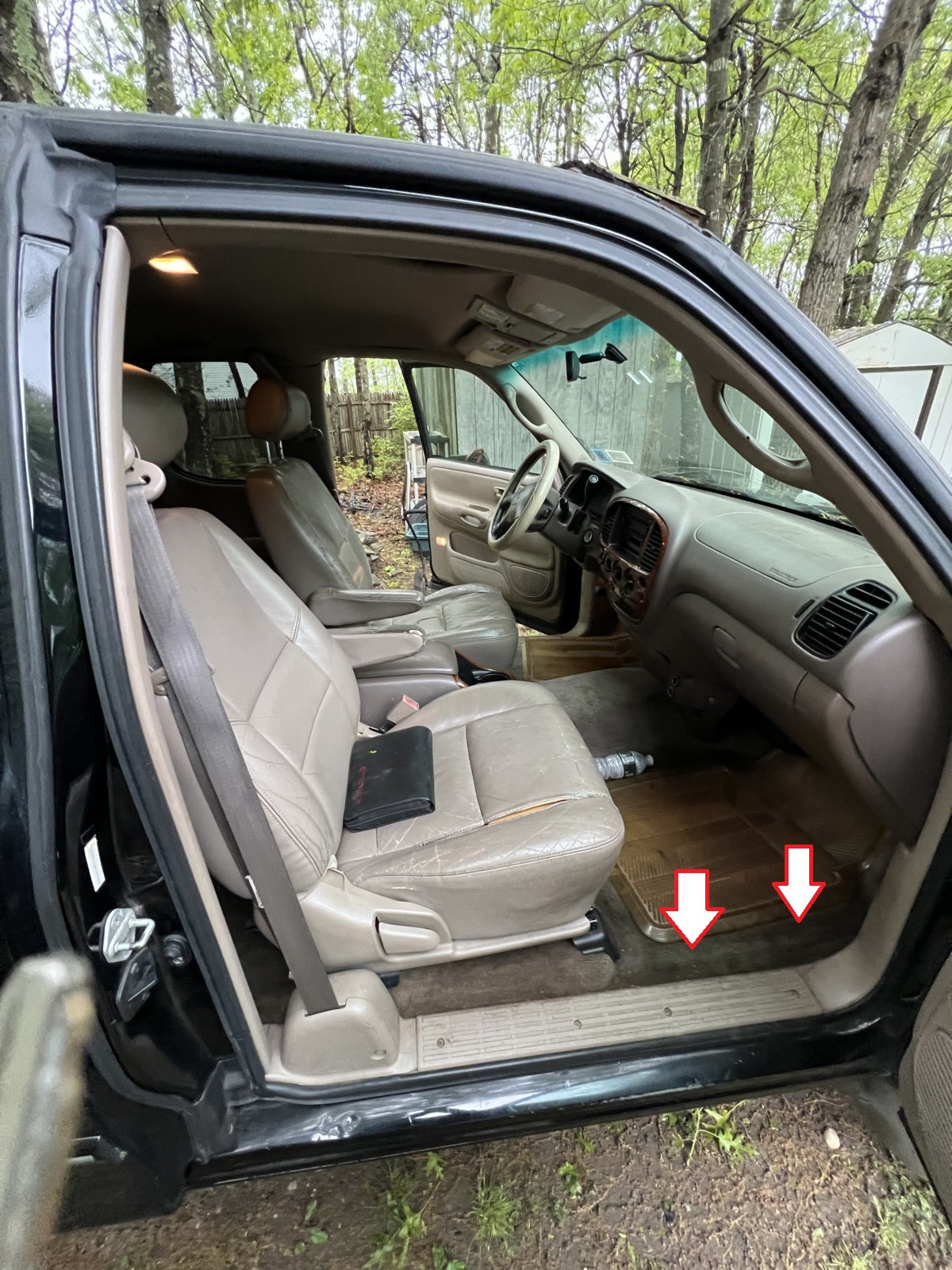

    Oh, and it appears you have the infamous cowl fastener leak. More info in the "Definitive Leak Thread":

    I would definitely get one of those steam cleaners and a good brush to clean that carpet flooring in addition to cleaning the leather seats.

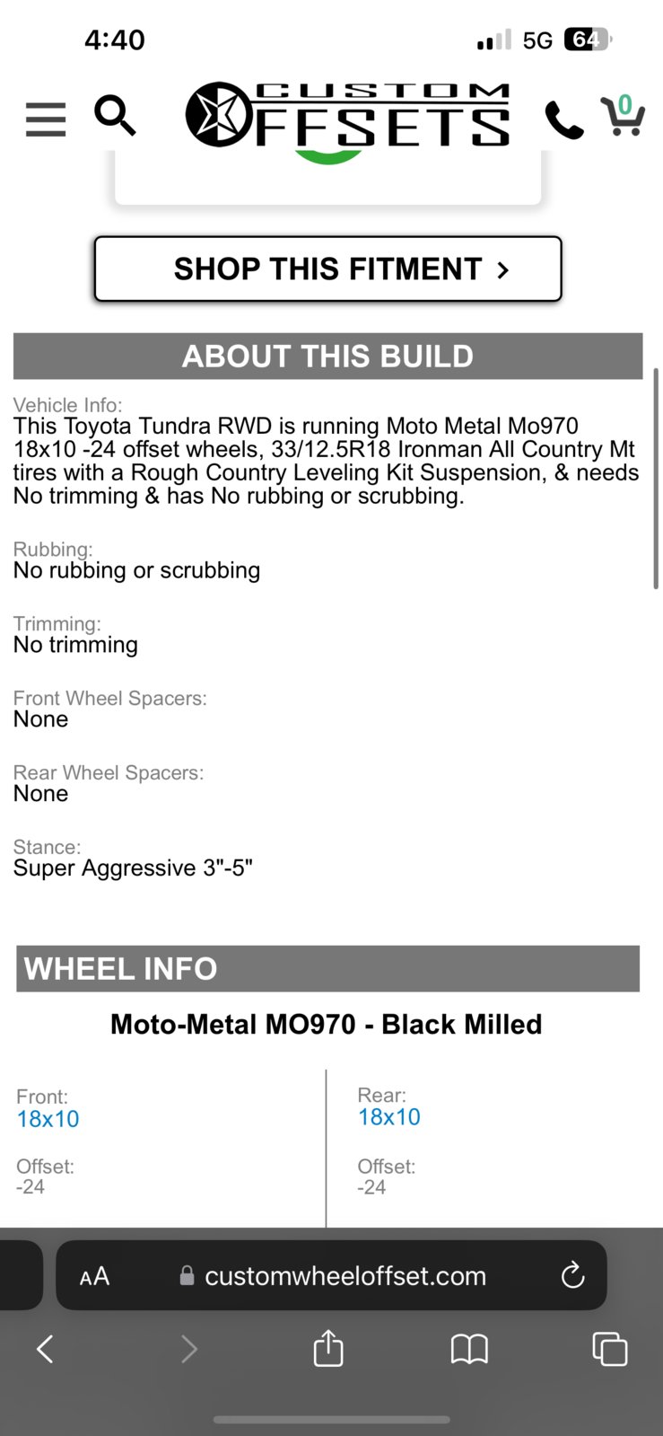

    How accurate is this info with no trimming there’s still no rubbing on this wheel tire setup? 20x12 is definitely too much work and don’t wanna kill the geometry of the truck too bad.. lol not sure if it matters too much this description specifically says RWD. I have a 4WD

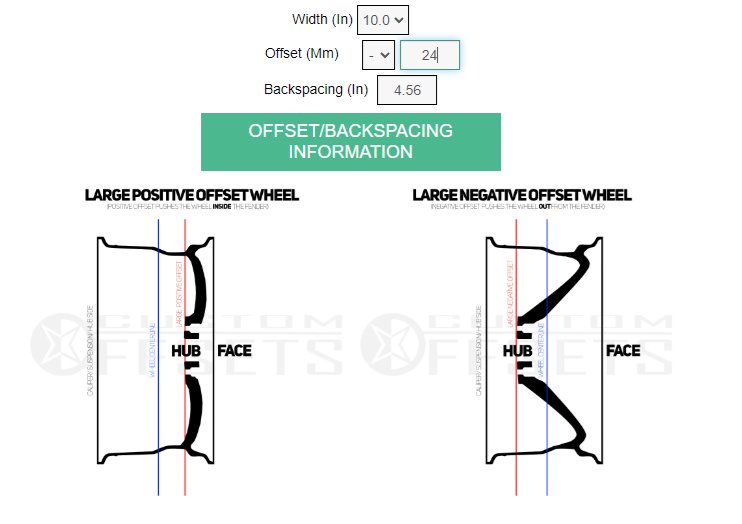

    Here's what I'd say.
    First off, Rough Country is garbage. Avoid like the plague. This isn't me being dramatic, it's fucking garbage, there's a reason it's priced the way it is. And don't tell me it's the 'only thing in budget', we've heard that bullshit line before. It's not worth the potential damage, and damage we've seen from newbies who came here for help with suspension problems. You risk doing much more damage than you'd pay a little more for quality components. Unless it's all for looks and you don't give a shit, in which case ... you're at the wrong forum, dude.
    Second, it's really important you pay attention to cab types. The RC and AC suspension and what you get is very different from the DC, which more closely resembles the Sequoia. Most vendors are selling kits tailored to the Sequoia and DC, not much is intended for AC/RC and virtually none of the kits are specifically intended for the AC/RC trucks. You need to be looking at other AC trucks like yours when checking for setups, because if the guy you just cited is rolling in a DC, what he has is NOT going to translate cleanly to your AC.
    That and other lifting tips are in the "Suspension, wheel and tires ..." section of THIS THREAD, which is worth a read. From that thread, note on wheel/tire fitment in red:
    • Wheel fitment (backspacing/offset info) ... backspacing/offset plays an important role in whether or not you're gonna rub when choosing larger-than-OEM tires. If you need help with understanding what ballpark you should be aiming in, this is a good thread to read. Gist: The best put year near the fender edge w/o rub on 8½" wide wheel is ~4¾" backspace, at 9" wide ~4.5" backspace. Popular OEM 7½" wide wheels had 5" backspace. You can run oversize 275/70r17 tires on 17x8.5" wheels @ 0 offset (i.e. 4.75" backspace) leveling up front w/minor rub.
    • Wheel fitment (caliper rub): If your truck has larger 13WL calipers, beware of caliper rub! 13WL is std on 2003+
    • Wheel fitment (from other Tundras): 2007-2022 Tundras use 5-lug wheels. In 2023, Tundras started using 6-lug axles again, but the hub bore is smaller (95mm on 3rd gen vs. 106mm on 1st gen), so they technically won't work unless you spend a couple hundo on custom-made spacers.
    • Wheel fitment (from other Toyota models): Anything from Tacomas, 4Runners, Land Cruiser, LX470 and GX models that are 6-lug will typically fit. Someone here is probably running it already, and pics of it are in the OEM wheels thread.
    That said, I guarantee you that person you just copy/pasta'd from pulled his front mud flaps because there's no way in hell he wasn't rubbing his front mud flaps with that setup. His setup is 18x10 @ -24 offset. Running that thru a calculator for backspace:
    That's actually a pretty good number, 4.56 backspace at 10" wide but you'd need to be careful about your tire choice, you'd also need some lift for vertical clearance during compression events (bumps) to avoid catching your fender edge/flares. I think 4.4 backspace is about the lowest backspace I'd personally like to see at 10" width. 4.53 is where I was running with my 17x9 and 32.2" tires and I was absolutely eating front mudflap at every turn with a 2.5" lift and custom uppers. I probably could've aligned that out a bit with more caster, but I'd still be eating flap with any amount of turn, and turning while under compression.
    If he was truly "no rubbing or scrubbing" on that setup, I assume he's hammered pinch weld, and maybe lifted closer to the 4" end of things? Remember though, lift only gives you vertical clearance, it doesn't magically change where your tires will grab the corners of your wheel well or frame or mud flaps when you've got the wheel cocked at full lock either direction, and just because someone isn't rubbing at full lock rolling forward does not mean they aren't rubbing at full lock in reverse.
    Also, and remember this: People lie about rubbing. I had several people tell me I wouldn't rub with my setup, just running 32.2, but it wasn't the case. I definitely have rub. I suspect the person who posted that setup on the CO website isn't being forthright, or they're leaving out details. Like "rubs frame at full lock", or "rubs mudflaps". I don't rub in normal situations, but even after chopping up my mudflaps, there are still cases where I eat flap. And I can't hit a bump while turning without my tires grabbing wheel well insert.

    really appreciate the info and reply’s. I don’t mind a little rubbing at full lock, I definitely do wanna go some type of route to have a 18 19 or 20 inch rim with some type of negative offset and to be around the 32” inch range. I understand I’d have to do a good amount of trimming on the pinch weld hammering and fender trimming. That’s just what I’d be interested in, maybe 10” wide with a 2.5 level lift. Or 3” level lift. And I believe at 3 inches UCAs and diff drop is needed? Or only UCAS.. read a lot of the threads that were posted. Forgetting a few things. My only main concern would be really just changing the geometry of the front end which is the reason for the questions. What ever is the more reliable and quality level lift I’ll get and not cheap out on a trash brand.

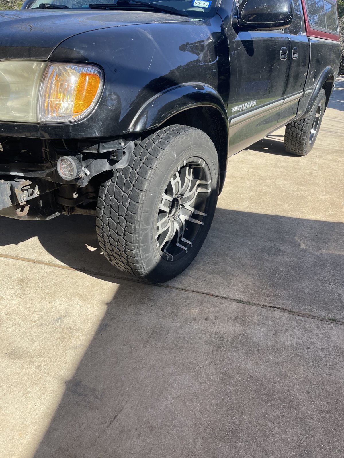

    20x9 & i THINK 285/60-20. Just rubs at full lock (and UCA). Spacers got the tire off the UCA, but made the tires rub the fenders earlier.

    What’s the offset? And how much did offset change with spacers?

    I think they're +6, and they were 1-1/4" spacers.
    Started to rub the outside of the tire on the bulge for the mudflap bolt.
