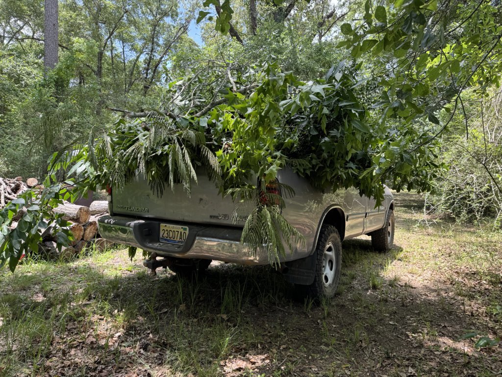

    Yours is excellent, nice to see a sibling truck! Mine’s currently getting plenty of use as I’m working to clear out all the overgrowth on my dad’s property:
    M14 EBR[QUOTED] likes this.
  2. Jun 24, 2025 at 11:58 AM
    #62
    shifty`
    shifty` Goons of Hazzard
    Jun 20, 2020
    #48239
    30,799
    ATL
    '06 AC Limited V8/4WD
    Glad to see those damn Mimosa ("air tree") branches in the back hanging over the tailgae and brake light. Cut down every one of those invasive SOB's you find down!
