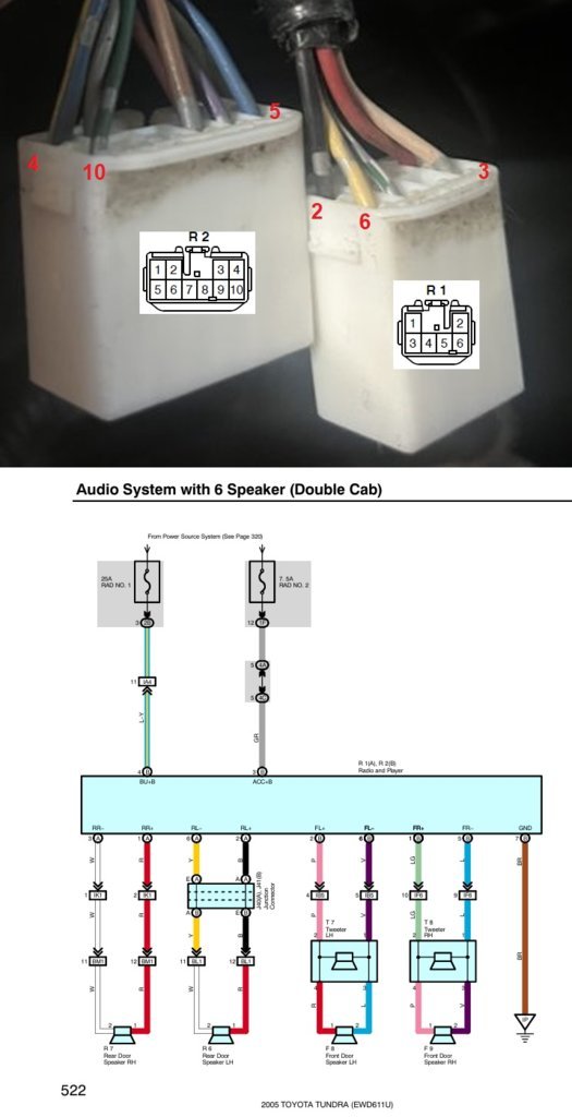

    With those connectors it appears to be the basic DC SR5 6 speaker Audio but the drawing does not jive with actual conductors present.
    Edit.....seem to always forget about illumination conductors that don't show on Radio schematic....all conductors present and accounted for.

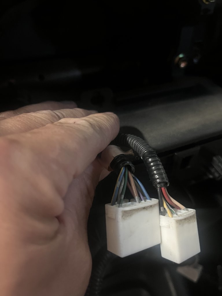

    Without seeing certain things, hard for me to know how you're able to go from 2 OEM connectors to the radio connector. Both of the OEM connectors have conductors you need. If you're convinced it'll work, go for it,

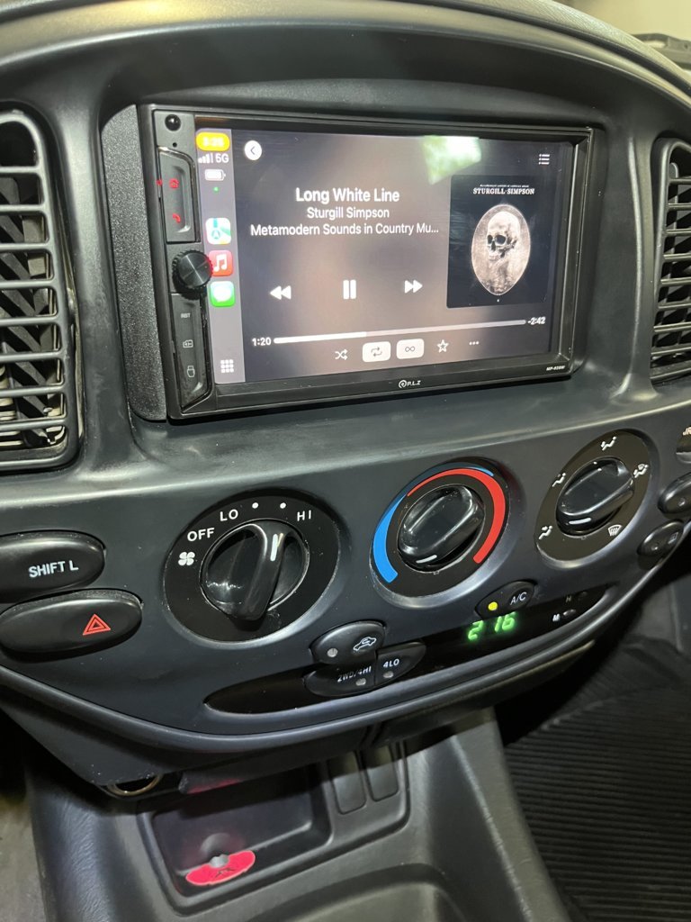

    Fits in there pretty good. So far seems like a good setup, Apple CarPlay, back up camera AND a volume knob! Not 3 options that are easy to find these days, especially for under $200US. Will know its quality if it survives a few Canadian winters.
    Used Metra 70-1671 harness adapter and Metra 95-8202 trim kit.
    the trim needed a little work from the belt sander to fit nice.
    thanks to everybody that took the time to offer advice, this forum rules!
