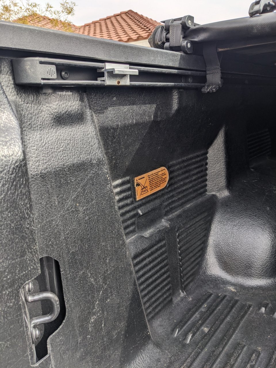

    I ordered the Amp Research Bed Extender months ago, and it finally arrived this week. I ordered the no-drill brackets, but I wound up drilling because the torque screws holding the hook where the no-drill brackets would mount are covered by the spray bed liner, so I couldn't get the screws off.

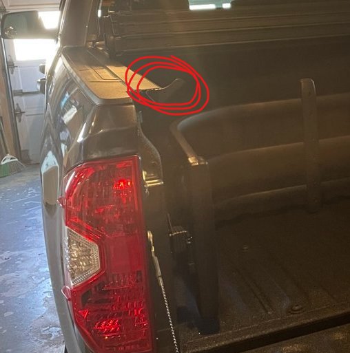

    After installing the drilled mounts and getting the extender set up, I went to flip it into the bed and realized the X4S metal latching tabs (as shown in your photo) fully block the extender from flipping into the bed. :(
    I quit in frustration (and had to leave for a meeting anyway), so I haven't tried any troubleshooting yet, but I think the X4S essentially prevents you from flipping the extender into the bed.
    You mentioned the extender scraping on those X4S latching brackets, but I wonder if your quick-release addition moved the extender arms a little more to the center of the truck, allowing the extender to flip back, even scraping slightly as it does. I'm wondering if I could try adding the quick-release into the drilled brackets, if that's possible.
    How bad is the scraping? Do you feel like it's viable, since flipping it back and forth isn't a common occurrence? Are there any other tips or thoughts about how to make the Amp Research Bed Extender work with the X4S?

    In looking more closely at your post and the photo of the bracket and quick-release handle, it seems like I'm more intrigued about what appear to be some spacers that are extending the mounting brackets out from the truck bed. From this photo, it looks like you inserted a series of buffers / spacers before the actual bracket, and I wonder if that's allowing your bed extender to flip up without hitting (or just scraping) the latching brackets for the Revolver X4S.
    I apologize for following up on my own post, but could you share what the apparent spacers are in the photo you shared with the mount and quick-release handle?

    Now I feel like I'm talking to myself, but I wanted to update anyone following the thread. -- The issue with installing the bed extender with a tonneau cover like the Revolver X4S is that the rails on the cover prevent the bed extender from folding into the bed. -- @BhamDadTundra showed his installation with a quick-release hardware, but I wasn't sure where he got the spacers that appeared in the photo. -- I've since found the spacers on the Amp Research site and at 4WheelParts. (AMP Part No.: AMP74609-01A) They cost $50 (pretty steep for a set of spacers), so I just ordered them and will update when I get them installed.
