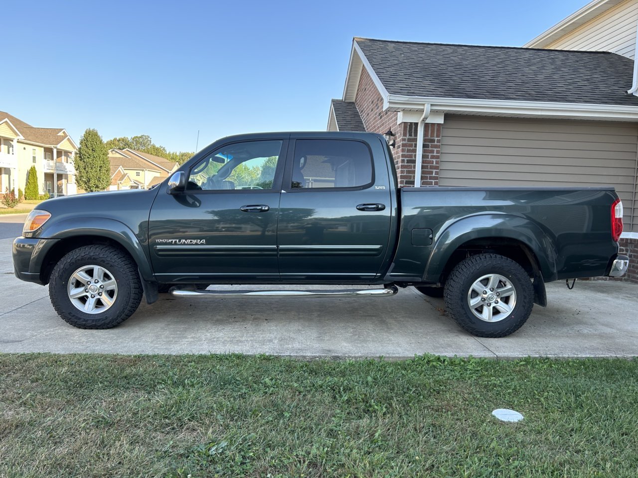

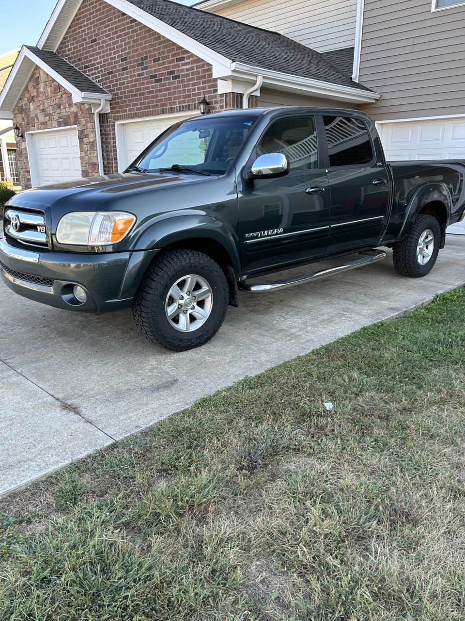

  15. Oct 2, 2023 at 3:00 PM
    #45
    KTM_AJ421
    KTM_AJ421 [OP] New Member
    Sep 1, 2023
    #103221
    420
    AJ
    2006 SR5 DC 2WD 4.7
    265/75r17 M/T Baja Boss AT 17x8.5 -10mm SCS Ray 10’s Bilstein 5100’s 2nd notch
    New shoes today. Looks so much better with a little bigger tire and rides much better too. I was going to get some method wheels but I actually like the stockers
    KNABORES, FirstGenVol and shifty` like this.
  16. Oct 2, 2023 at 3:17 PM
    #46
    KNABORES
    KNABORES Sarcasm incoming
    Jan 1, 2020
    #40572
    13,868
    Arkansas
    Looks great. Those are some of the better looking factory wheels. I hope the machined finish makes a comeback.

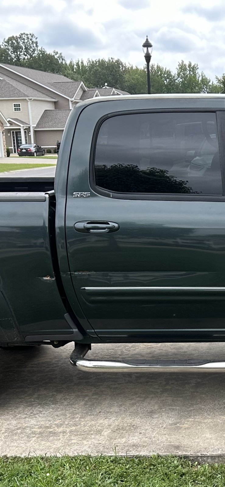

  23. Oct 5, 2023 at 12:43 PM
    #53
    KTM_AJ421
    Sep 1, 2023
    #103221
    420
    AJ
    2006 SR5 DC 2WD 4.7
    Any body-shop guys in here? Looking for some pointers on how to deal with this scrap down the side. It is indented a bit. Local shops have a lead time of about 3mos+ so I’d like to atleast out some touch up paint there to keep it from rusting.
