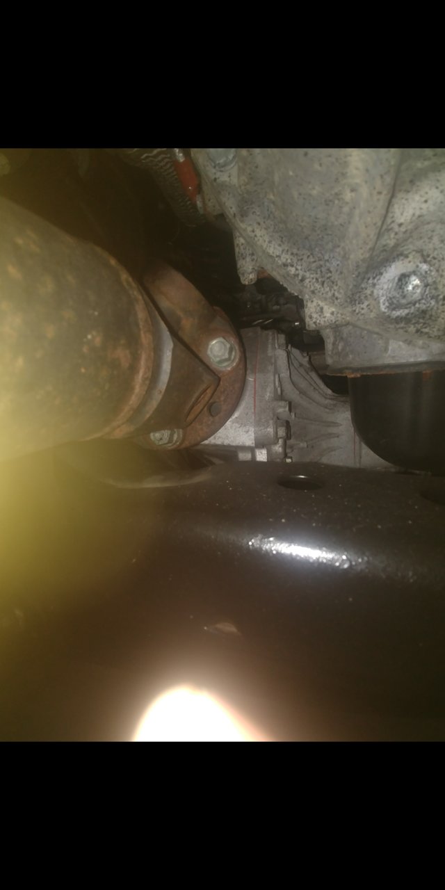

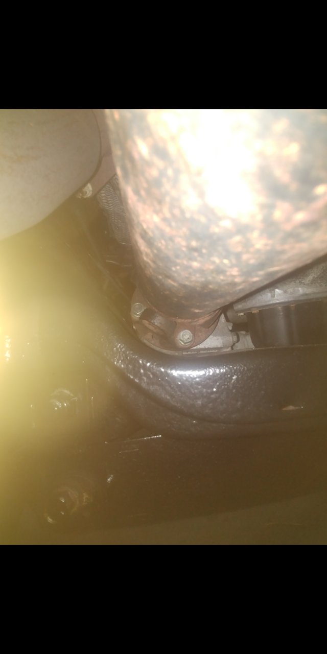

    Mine was a no cut .But my drive shaft angle is not bad but I kind of wonder if it's because my truck is a long bed so it's a two piece driveshaft I also got the carrier bearing drop

    Nevermind I see what you are saying. I will have to take a look at that .Maybe if mine is the first kit I should get the dif drop and cut the frame .Idk I still dont like that idea.

    All 6-8" Bracket lifts cut the frame I believe... It has to be done, as that's where the diff sits after the kit is installed.

    I don't know what I'm looking at I guess

    We are looking at what angle the front CV shafts are at... The shafts that come out of the diff and into the front wheel hubs.

    Yea those are at a lot of an angle. Sorry and thanks for the detail im just a plumber dont know a ton about that stuff.

    Its all good, LoL... Did you cut the cross member for this lift? or is this the no-cut version?

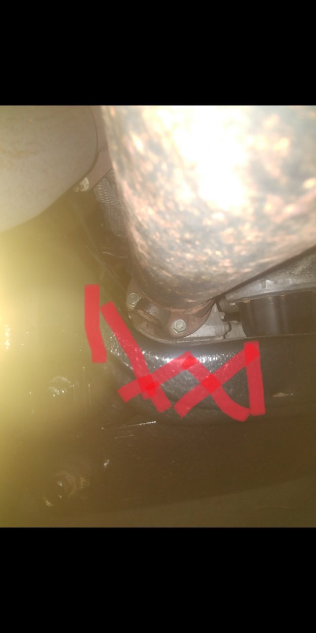

    @Mnorris1206 has the old no cut version, I marked where it gets cut with the new one on his photo.

    Ha, saw that pic, and it didnt even register... Thanks

    Well that wont be to bad I can do that. Thanks for pointing me the right direction .

    One more question you dont have to put anything their in its place ? Like a bracket of some sort ?

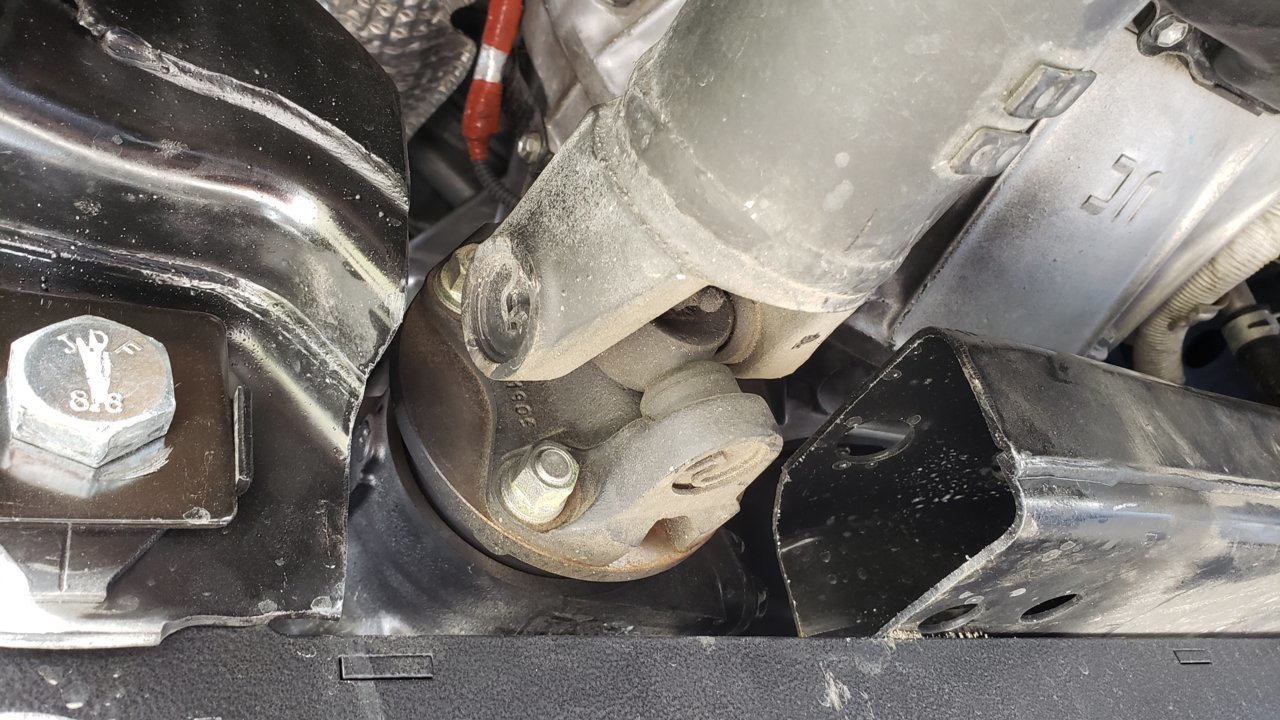

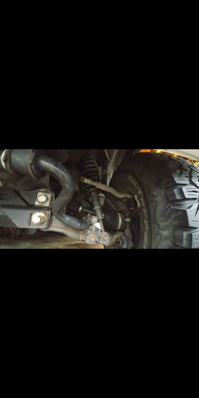

    This is late, but here's the cut they did on mine .

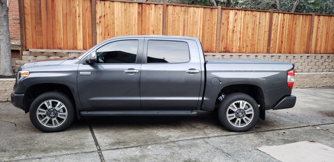

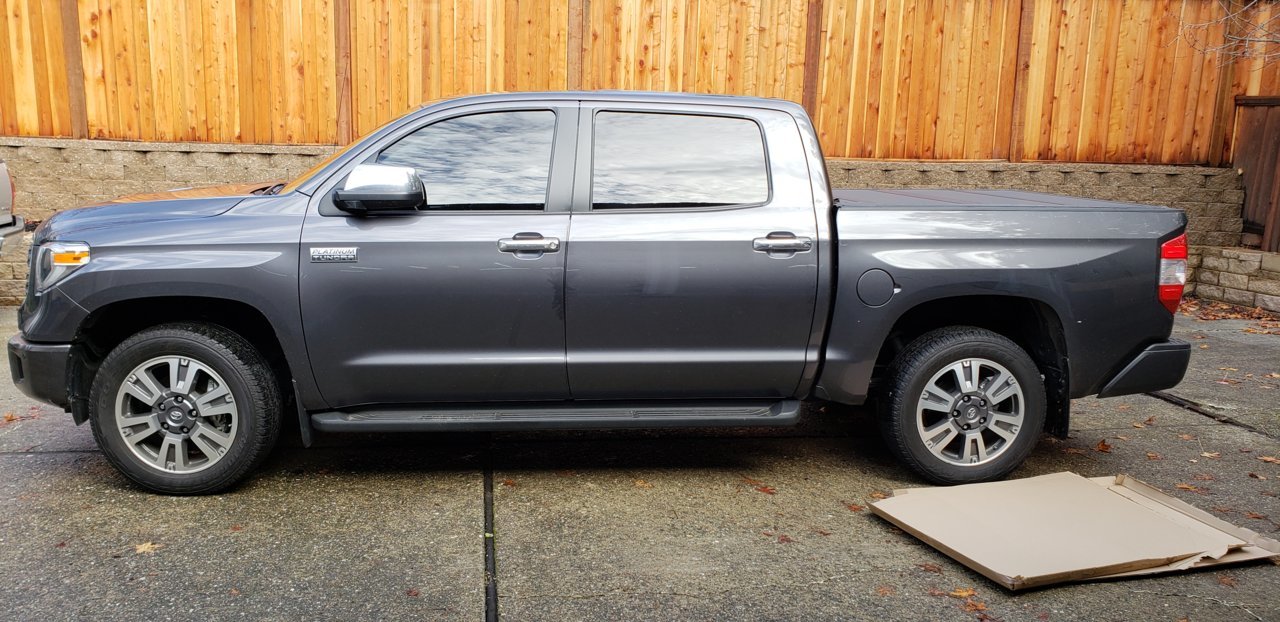

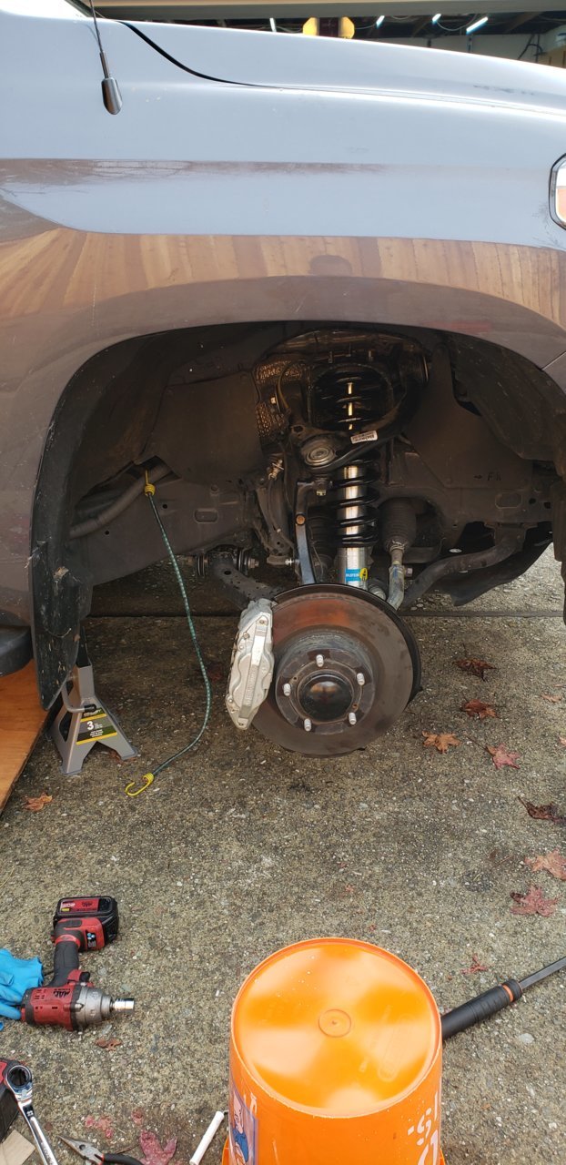

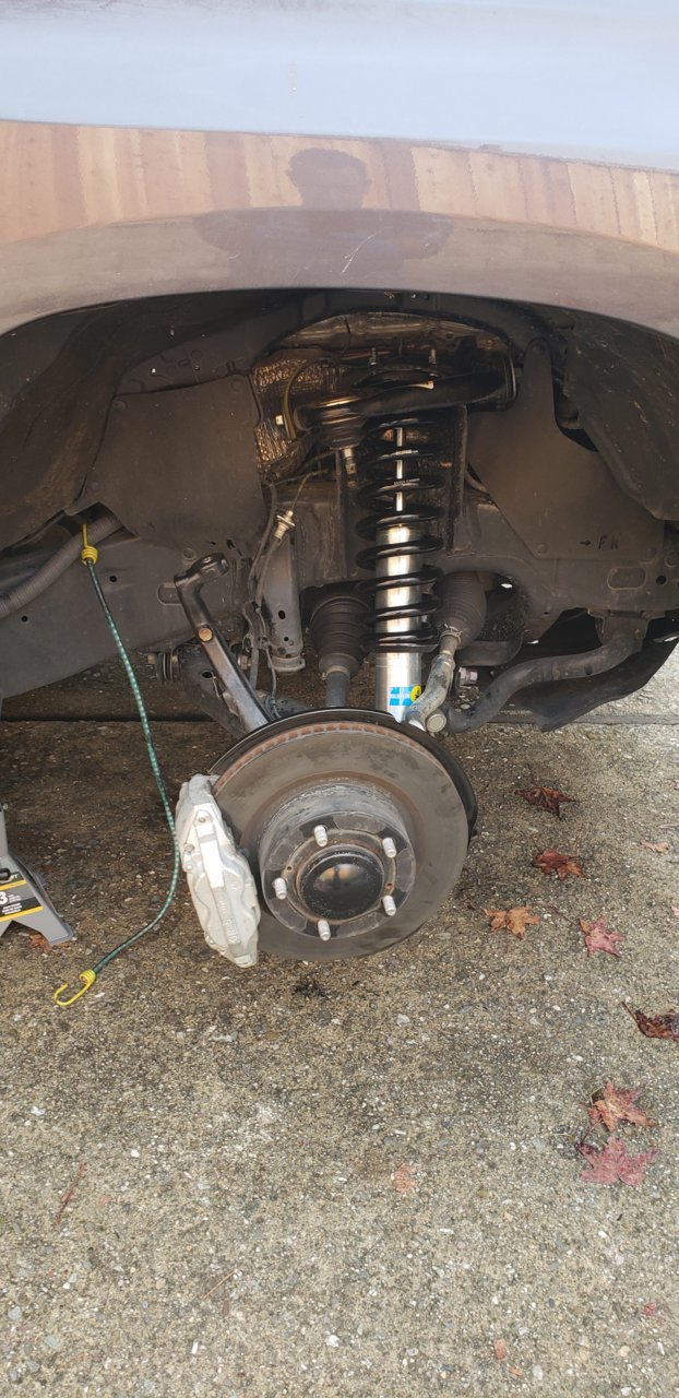

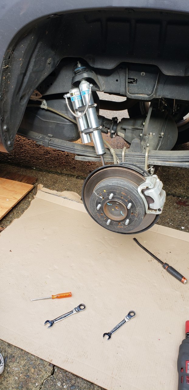

    I just put Bilstein's on the Ole pig. 5160's aft and 6112's up front. Still have to decide if I'm going to change the rims or not and what tires to go with. I am not a mechanic so the job took awhile longer than it should have, but the ride is improved dramatically. The Platinum in my opinion is a bit splashy, now it's solid. I haven't taken it off road yet but just around town and speed bumps I can tell a huge improvement in how the truck recovers. I'll end this with.... This may not be a 2 man job if you know what you're doing, but it took me and a friend, nothing about this truck is light weight and you need the proper tools. I ordered the 6112's set one below the highest setting 1.9" and the truck sits about 2 inches higher now in the front. The rear remains the same.
