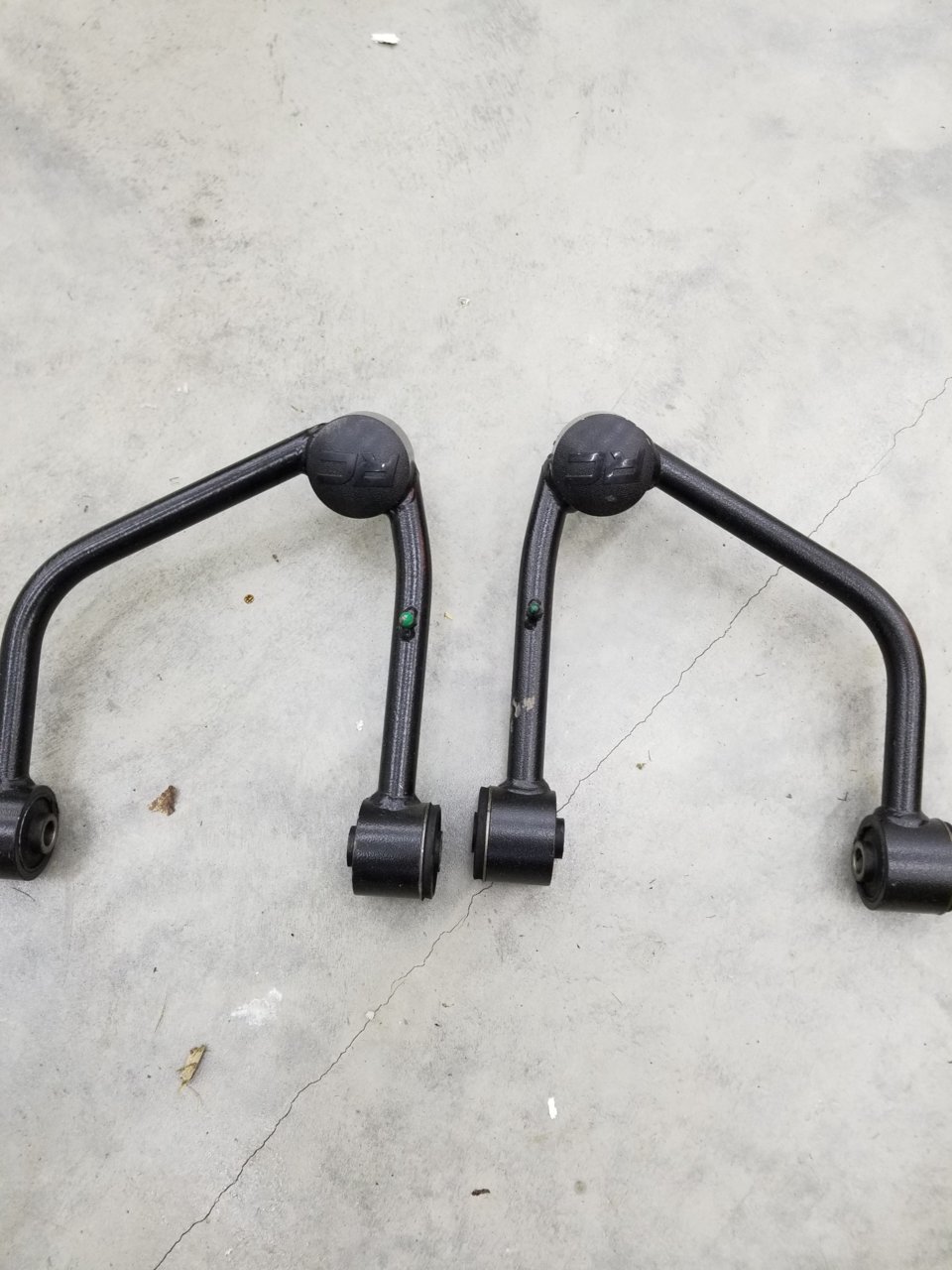

    1BadTundra
    1BadTundra New Member
    Oct 11, 2016
    #4835
    763
    Clinton
    2010 TRD Rock Warrior Crewmax
    Too Much to List
    They were pretty new at the time, we wanted to check them out. We are cranking a coilover with our 6, in an attempt to get 7. The UCA will help with alignment (camber & caster setting) after trying to squeeze the extra inch out of these. We will not be adding the preload spacer in the coilover, but twisting them to compensate for it's absence.... Then a little more. As for the rear, we will be trying a 3" leaf pack with a 2" block, just to get the taper for the U joints. If it works, cool... If not, oh well. Its our shop truck We'll keep the basic lift together and sell out whatever parts are compatible. Yes, I know the RC 6" is just the 4.5" spaced up to 6", but as long as the angles look ok, we're gonna try a few things. Wish us luck! we'll share our findings.

  24. Jan 15, 2019 at 3:17 PM
    #24
    1BadTundra
    Oct 11, 2016
    #4835
    763
    Clinton
    Too Much to List
    They aren't bad at all. In the past installs, we've seen more aggressive angles with 3/1 level kits.
