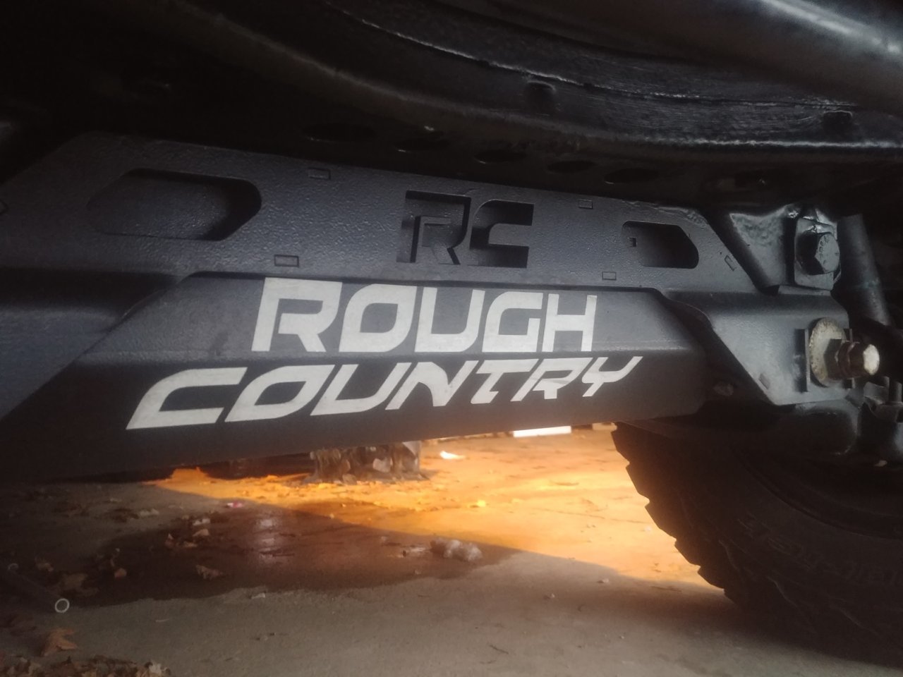

    Its hard to see in this pic but the cross member from rough country kinda jus over lays the original one that part their with just the rc on it. Behind it their is the trucks cross member . But idk maybe yours will be different but it should be exactly like mine .We did have to grind some of the metal down a little but thats all just so the new would go on all the way .

    It showed marking it where the drive shift is and cutting that out. I love the RC logo there. Looks bad ass I bet going down the road.

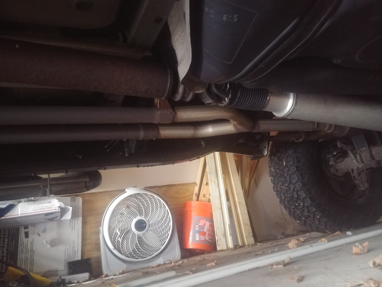

    Maybe I see what your saying I have a 2 piece drive shaft with carrier bearing because its a long bed maybe that it right their. And thanks I like it their .

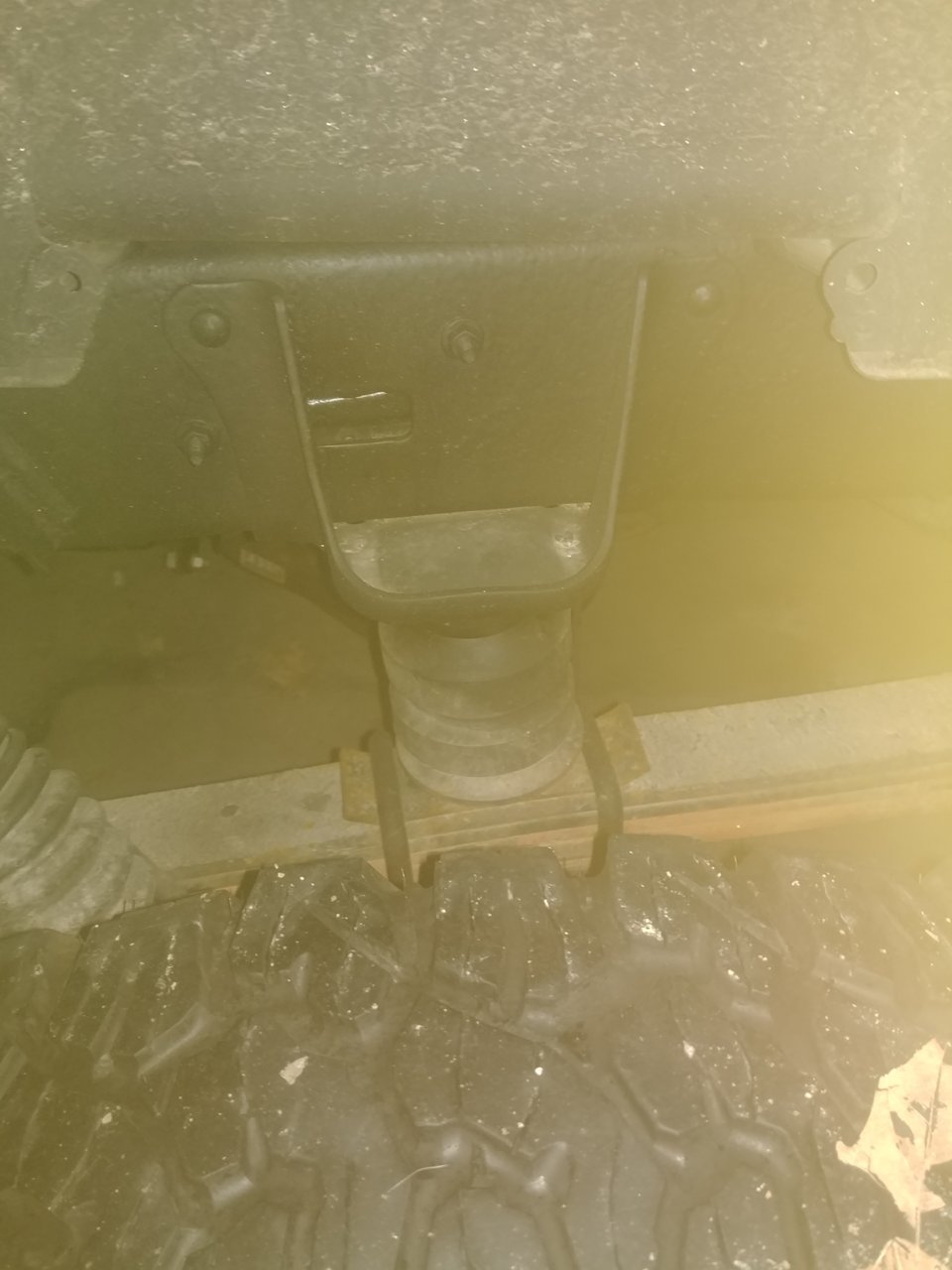

    Not the best pics but thays what I could get this morning lol .Their is the load helper .Also .

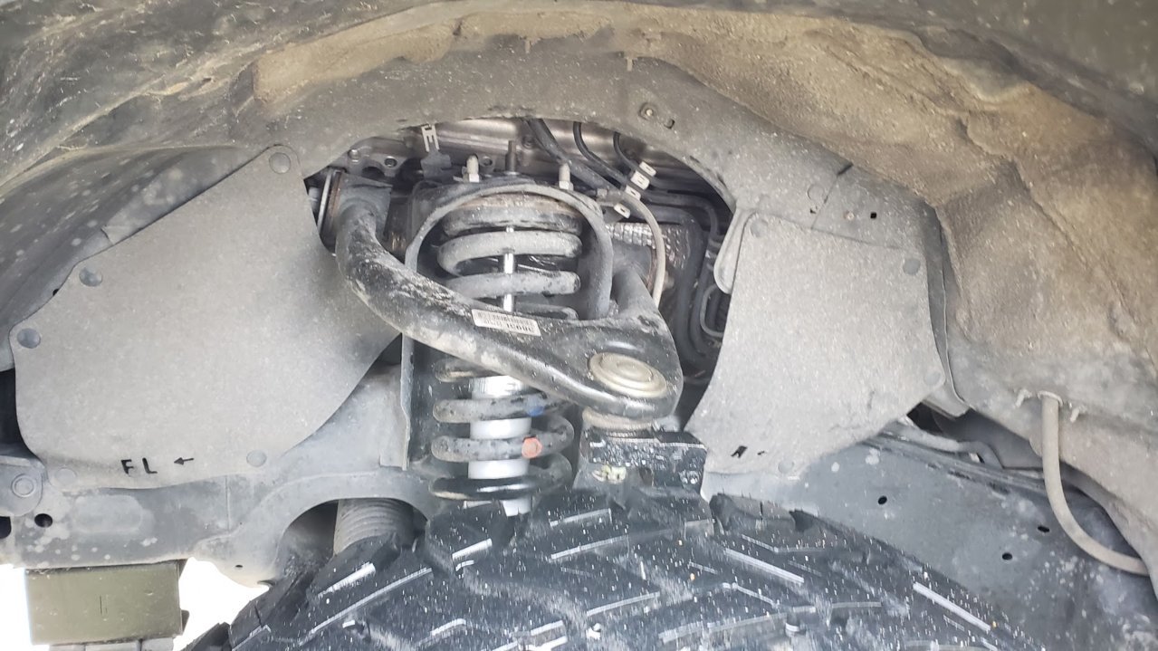

    I'm just curious mainly what I'm looking to see how your socks look vs mine with the spacer

    No worries :) Is this what you wanted?

    Yep that looks so much better than mine I cannot wait to get rid of these spacers

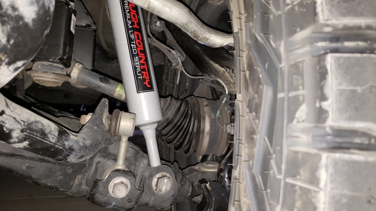

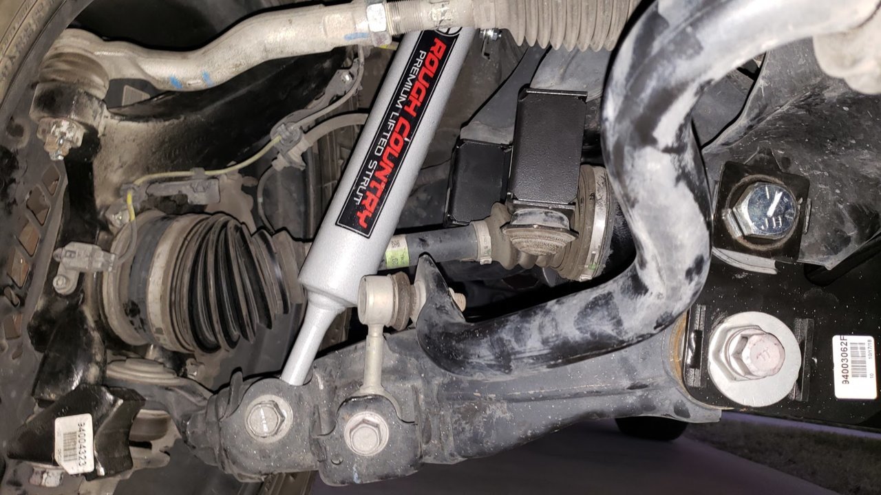

    Is this the version where the cross member was cut, or is this the no cut version?
    How about this on? Frame cut,or no cut?
    I ask because, RC made 2 different versions. The first was a 6" lift without cutting the crossmember for the diff to drop through. The second kit was a revised design, they saw the angles were a bit much and made a diff drop included with the lift. Just wondering which one each of you have here.
