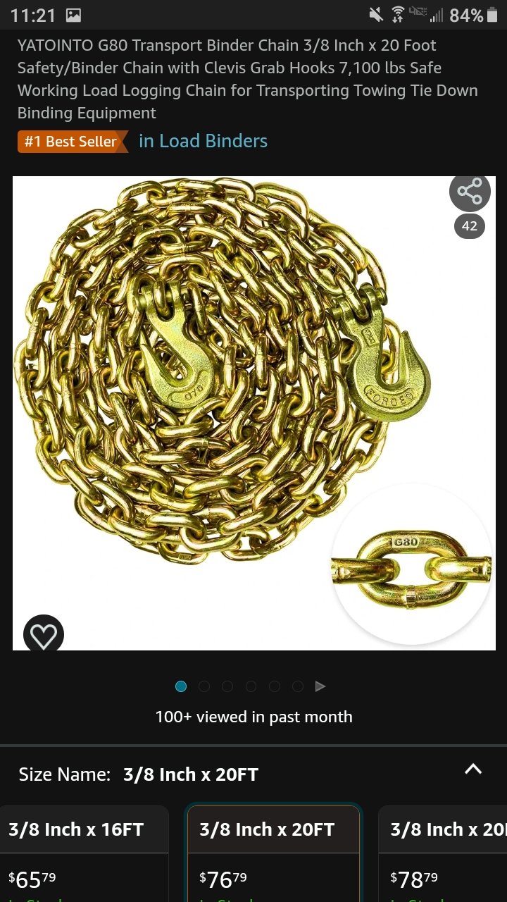

    @landphil , thank you and you were spot on about tree butt diameter! It was a dogwood tree that would bloom in spring before all other trees wake up.
    Anyways, I didn't take a photo of the chain(should have), but I did find it on the website, I think. Although I don't remember it having hooks since I was also picking them along with links on the shelf.

    Reason for this idea vs renting equipment, I live among trees. Tiny house and trees everywhere. Multi-use was my preference, hence the purchase. I like to diy stuff around the house, because I can(sorta..)
    If I could rig something up that would be strong(safe) enough, it would be most preferable. If I'm being dumb and trying to kill myself or the pickup, then an honest and frank opinion is welcomed.

    Your traction will run out long before that chain will, especially being 2-wheel drive.
    For reference, I picked a fight with a t-post a few weekends back. I was in 4-low with aired-down 37s for the maximum traction that I could produce and I was just spinning tires. I then switched methods and tried to winch it. I sat in the cab on the brakes and it drug my truck with all 4 tires locked up. Then I pulled the old wheel trick like the video @GODZILLA posted and the t-post finally gave up. I had probably the exact chain that you posted hooked the post the entire time.
    The 'Safe working load limit' on chain typically has a safety factor of 3 or 4 as well so the breaking strength is somewhere north of 10,000 lbs. You CANNOT produce this with your truck UNLESS you get a running start, which you have stated many times that you aren't planning on... So you will be fine.

    One other thing, it looks like Amazon has a myriad of chains in the 3/8" sizes with price equivalent to smaller 5/16" from lowes. I could step up in strength for the same price. Are they reliable products? Heres an example:
    Sorry I was looking at the wrong area, its $76. Is that overkill, given that I'll never be able to create that much pulling strength over grass?

    Don't buy a Chinese chain. They are frequently labeled for ratings way above what the cheap chain can actually handle. When I went through the rigging class for crane work they specifically cautioned chaiChina. Shackles/clevices that were made in china.

    Thank you. Much appreciated. I will stick to lowes or home depot parts. No reason in taking unnecessary risks for a few dollars saved.
