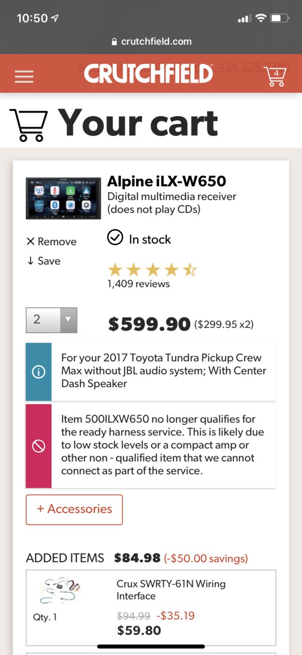

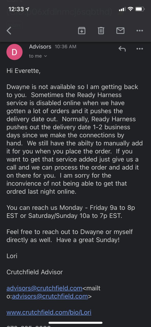

    I got an email back from crutchfield with good news. Attaching it with what I think I finally made my mind up up with. Let me know your thoughts on this one.
    As far as the maestro, I’m just wanting to keep my steering wheel functions and backup camera. Don’t want all the bells and whistles or rather don’t wanna dish out all the cash for them lol. I’m just trying to be a baller with a budget

    A little late to the reply game here... For what it's worth, I had the ILX-W650 in my 4Runner for about two weeks (along with an Alpine KTP-445U); while it worked alright, Android Auto was anything but stable. I mean, across all platforms it isn't "stable", but the ILX-W650 would have a dropped connection or Android Auto would crash more often than not. Additionally, I was using the Crux harness and had a systemic whine/whistle; not RPM dependent, similar to what you said initially. I rewired the whole set up, two different brands of Speedwire, three different sets of RCAs, moved the amp twice, tried 3 or 4 different grounds, multiple power sources (including from the aux battery vs. the main), RCA noise suppressors, power line noise suppressors, ferrite cores on everything, etc. And nothing solved or changed it at all. I finally got so fed up of chasing this around and tearing the truck apart (I live in a townhouse, none of our trucks fit in the garage, so all of my work has to happen outside, and our street is a bit of a wind tunnel, so winter months are infuriating when stuff doesn't go right).
    To try to shorten this all up, I called Crutchfield and got a return authorization for the entire set up (dash kit and all, because, on the 4Runner, once you install a Double DIN radio, the dash kit cannot support a single DIN). I switched to the (much) pricier Pioneer WT7600NEX, iDatalink RR, and Kicker KEY200.4 and the whine was gone. Now, the WT7600NEX is substantially faster in interactions than the Alpine, and while Android auto is more stable, it's still not perfect, or anywhere close to it.
    A buddy of mine ordered a radio a few months back with the Ready Harness, and it made it fairly easy for his install; personally, I enjoyed following the Dean @ 5 Star Car Audio method and strip the harness of everything it doesn't need, and then re-wrap it. For the iDatalink (and Crux) harness, it really thins out the bundle. His T-shape method made it easier to fit everything into the dash of my 4Runner also; we'll find out how well it works on the Tundra when I get to that point of putting everything back together (hopefully tomorrow).
    Speaking of his videos on YouTube, pretty sure I'm well into the dozens of hours of their install videos, how-tos, and 911's, and can definitely say it has cleared up a lot and taught me some stuff. They do have a number of installs on Tundras as well.

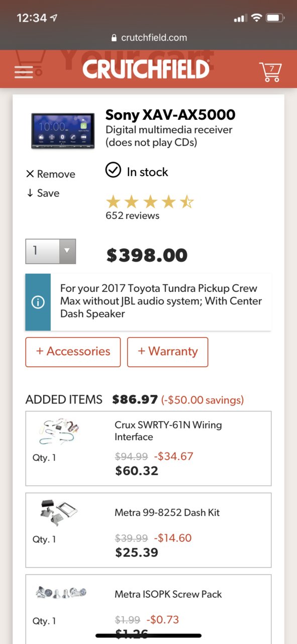

    Do you have any objections to the Sony I’m considering? I can’t really spend too much on this considering I just lost big on this crackjobs install. Trying to stay in the 5-600$ range

    I don't think anyone really has bad things to say about the Sony head units, they don't seem to have the popularity of Kenwood/Pioneer/Alpine, but appear to be pretty decent. Honestly, one great thing about Crutchfield is their return policy, so if you get it and you hate it (or even just change your mind), you will get a return shipping label basically immediately and without question.

    Totally understand about staying in budget. And good to see that Crutchfield is setting you up with the steering wheel interface. As far as the Sony H/U is concerned, I had a super nice one with DVD, GPS, blah blah blah in my 4Runner a few years ago. It was great. My only quirk with it was the touch screen was not very sensitive, but that is a nitpick on my part. And that unit was released about 6 years go, so they have probably improved in that time. Reading reviews of your H/U choice on Amazon, looks pretty good. Looks like there are several videos on Youtube about the same H/U. Anyway, looks like you are in great shape and looking forward to see how your installation goes! Again, any issues, just PM me.

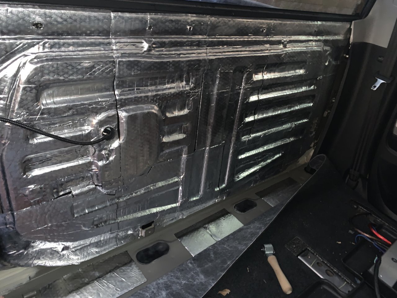

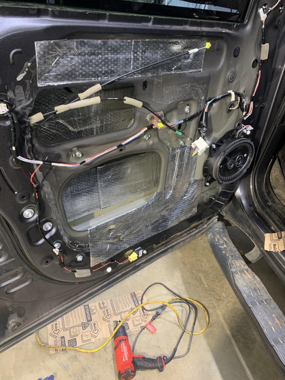

    Finally got it all fixed with the new head unit and it sounds amazing. Doing the dynomat now. Need a little advice on how to do it though. Do I need to cover the big openings in the door? I’ve seen other folks cover the whole thing is why I ask.

    When I sound matted my doors, I did both the internal panel (that would be the inside of the actual door skin), AND I also matted the stamped steel door panel with the big holes that you are referring to. Yes, I would cover the big holes. This will help bring out the "lows" on your door woofers. It can be challenging getting large pieces of matting through the big holes to mat the inside door skins, but I wore gloves to save my hands and took my time. Some might say that what I did was overkill. Maybe, but the doors are now very quiet when I shut them and the frequencies that my door woofers put out are definitely lower than prior to sound matting. One word of advice: If you decide to cover the big holes, just make sure that you have all of your internal door speaker wiring completed first, for obvious reasons!

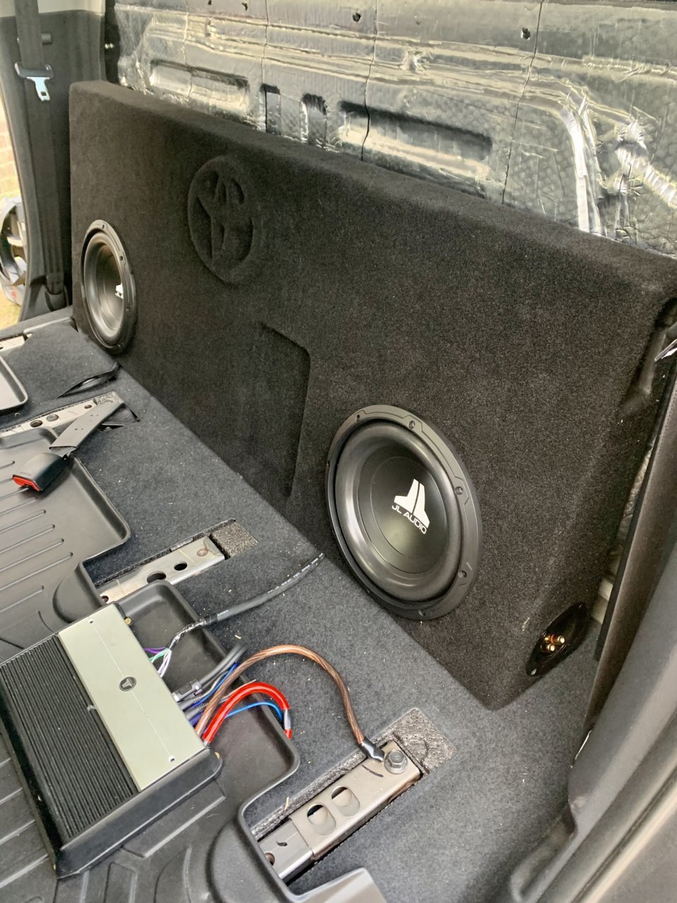

    Just a little update for anyone interested. Shoutout to @james@tech12volts for the sub enclosure!

    Looking good, my man! I have that same sub enclosure. So, now that you have the new system (and presumably installed correctly), how do you like it? How do you like the Sony H/U? Anyway, so glad you got it all squared away, and hope your previous stereo installer hack begins to suffer from erectile dysfunction!

    Lmao right!? I’m digging the head unit man! Love the CarPlay. The enclosure looks awesome but I just emailed him. Don’t know if I should’ve polyfilled it or not or either close off the ports. It’s not really hitting on the frequency I would like. Only subbing on the “high” bass notes.

    Well, doing Polyfill is not that difficult, but getting the back seat out IS! And you can't tune your subs via the amp's crossover and gain to the frequency you like? Well, either way, James will help you sort it out.
